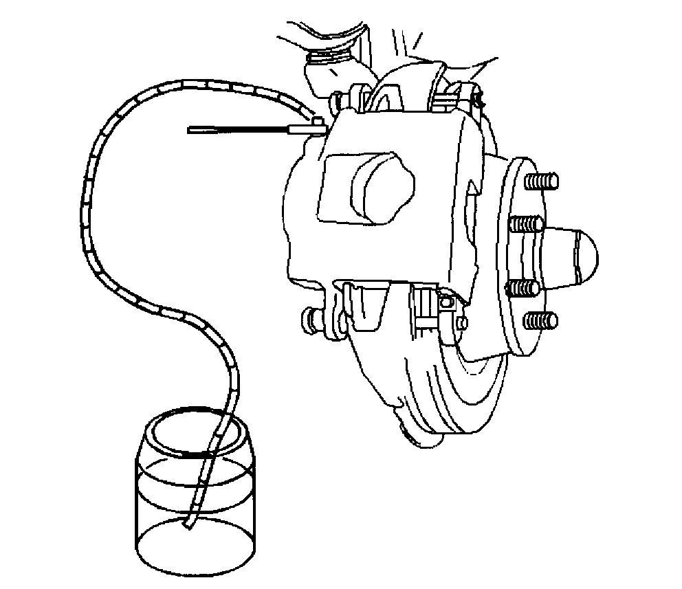

MANUAL AND PRESSURE BLEEDING PROCEDURES
pic 1
If air has entered the hydraulic brake system, bleed the system. You may need to bleed the hydraulic brake system at all four wheels due to one of the following conditions:
^ Air entered the system due to a low fluid level.
^ The brake pipes have been disconnected at the master cylinder.
^ The brake pipes have been disconnected at the combination valve.
If a pipe is disconnected at one wheel, then only bleed that wheel.
If the master cylinder has been removed, bleed the master cylinder before installing it on the vehicle. This will reduce the time required to bleed the system.
NOTICE: Brake fluid will damage electrical connections and painted surfaces. Use shop cloths, suitable containers, and fender covers to prevent brake fluid from contacting these areas. Always re-seal and wipe off brake fluid containers to prevent spills.
MANUAL BLEEDING
^ Tools Required
- J 28434 Wheel Cylinder Bleeder Wrench
1. If the vehicle has a vacuum booster, apply the brakes several times with the ignition OFF. This relieves the vacuum reserve.
2. Fill the master cylinder reservoir. Use Delco Supreme 11(R) Hydraulic Brake Fluid GM P/N 12377967, or equivalent DOT 3 motor vehicle brake fluid. Maintain the fluid level during bleeding.
3. If the master cylinder has air in the bore, bleed the master cylinder using the following procedure:
3.1. Disconnect the forward brake pipe connector at the master cylinder.
3.2. Allow the brake fluid to flow from the connector port.
3.3. Connect the brake pipe connector. Do not tighten the brake pipe connector.
3.4. Slowly apply the brake pedal. Allow the air to bleed from the loose connector.
3.5. Tighten the connector before releasing the brake pedal.
3.6. Wait 15 seconds.
3.7. Repeat this sequence, including the 15-second wait, until you purge all the air from the master cylinder bore.
3.8. Repeat this procedure for the rear brake pipe after you purge all the air from the forward pipe connection.
4. If you replaced the Brake Pressure Modulator Valve of the 4WAL system, or if you suspect that air is trapped inside, bleed the Brake Pressure Modulator Valve next.
5. Using J28434, bleed each wheel cylinder in the following sequence:
5.1. Right rear wheel cylinder
5.2. Left rear wheel cylinder
5.3. Right front wheel caliper
5.4. Left front wheel caliper
6. Attach a hose to the wheel cylinder/caliper bleeder valve.
7. Immerse the opposite end of the hose into a container partially filled with clean brake fluid.
8. Slowly apply the brake pedal one time and hold.
9. Loosen the bleeder valve in order to purge the air from the wheel cylinder/caliper.
NOTICE: Refer to Fastener Notice in Service Precautions.
10. Tighten the bleeder valve.
^ Tighten the bleeder valve to 13 Nm (110 inch lbs.).
11. Slowly release the brake pedal.
12. Wait 15 seconds.
13. Repeat this sequence, including the 15-second wait, until you purge all the air from the wheel cylinder or caliper.
14. Repeat steps 6-12 at each wheel until you purge all the air from the brake system.
15. Check the brake pedal for sponginess. Check the brake warning lamp for an indication of unbalanced pressure. Repeat the bleeding procedure in order to correct either of these conditions.

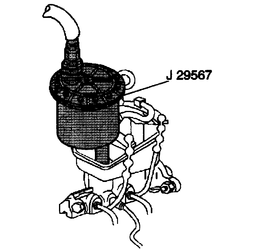

PRESSURE BLEEDING
^ Tools Required
- J 29567 Brake Bleeder Adapter
pic 2
Use a diaphragm-type pressure bleeder. The pressure bleeder must have a rubber diaphragm between the air supply and the brake fluid. This prevents air, moisture, oil and other contaminants from entering the brake hydraulic system.
1. Fill the pressure tank at least 2/3 full of brake fluid.
2. Charge the pressure bleeder to 140 - 170 kPa (20 - 25 psi).
3. Bleed the pressure bleeder each time you add fluid.
4. Install the J 29567 Brake Bleeder Adapter to the master cylinder.
5. If the Brake Pressure Modulator Valve of the 4WAL system is replaced, or if you suspect that air is trapped inside, bleed the Brake Pressure Modulator Valve first.
6. Using J28434, bleed each wheel cylinder or caliper in the following sequence:
6.1. Right rear wheel cylinder
6.2. Left rear wheel cylinder
6.3. Right front wheel caliper
6.4. Left front wheel caliper
7. Connect the hose from the bleeder to the adapter at the master cylinder.
