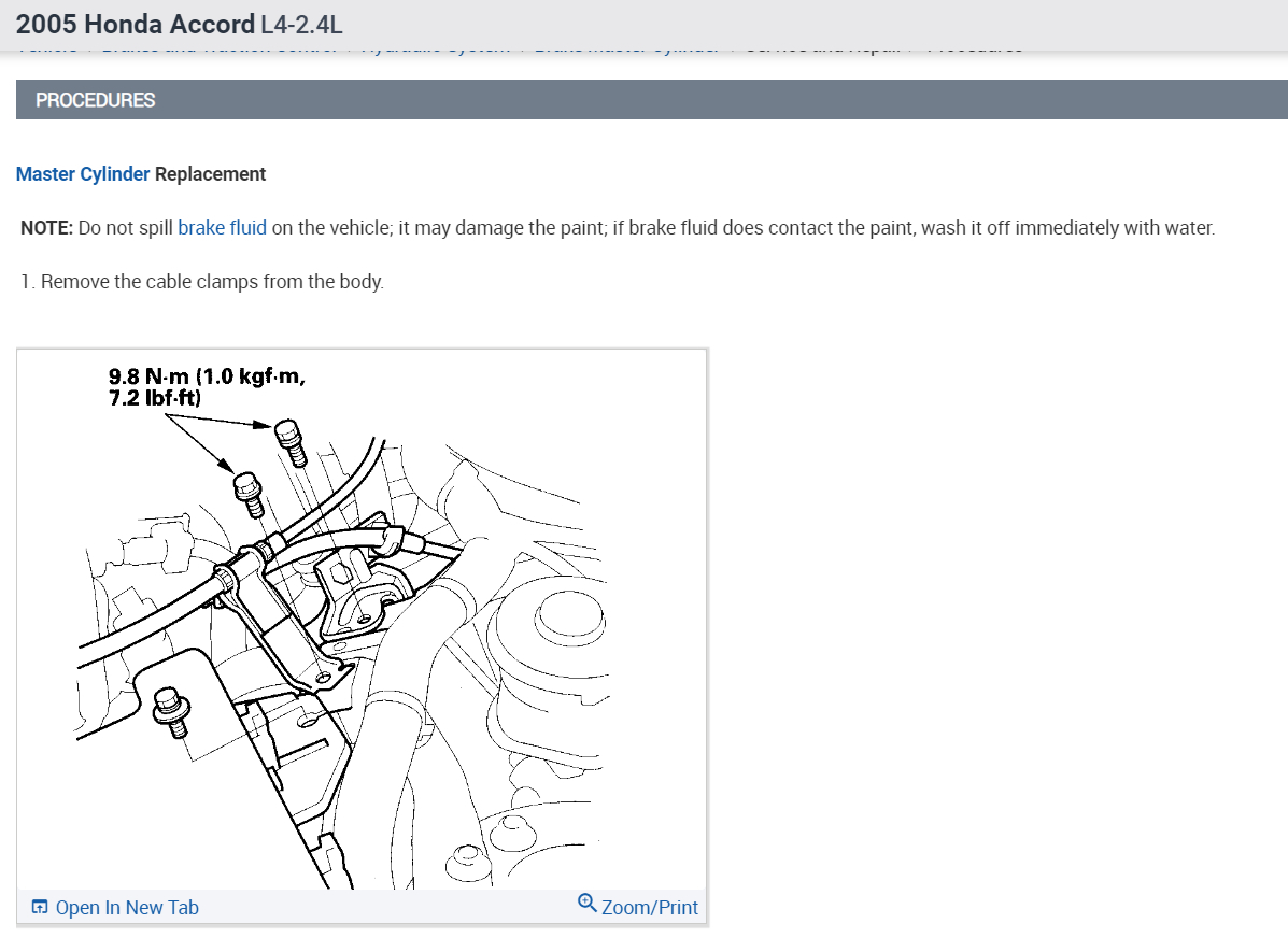

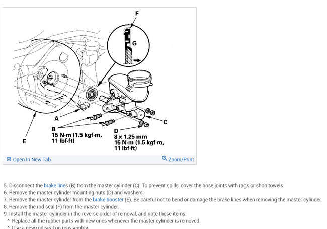

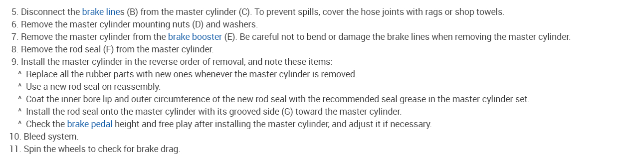

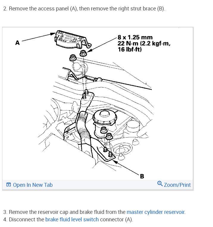

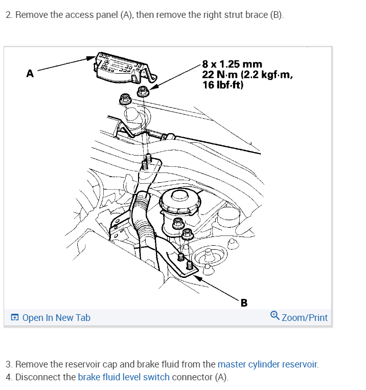

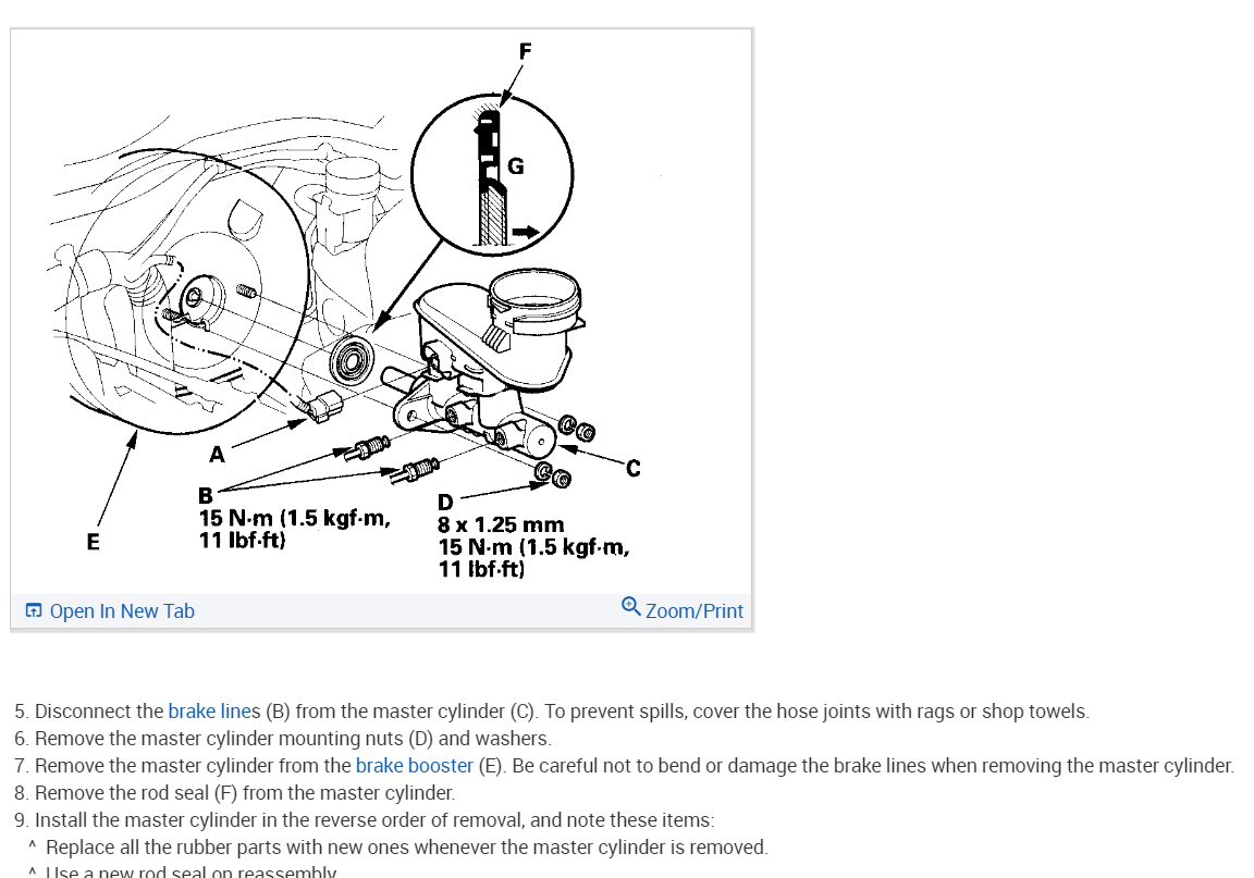

Is the brake fluid empty? If not, it sounds like the brake master cylinder has gone out. Here is a guide to help you be sure and I have included a separate guide for the master cylinder replacement.
https://www.2carpros.com/articles/brake-pedal-goes-to-the-floor
and this guide for the brake master cylinder bleed:
https://youtu.be/WDxvEQrMkBg?si=isVrBSlkw-iN8pgQ
and
https://www.2carpros.com/articles/how-to-replace-a-brake-master-cylinder
here are the instructions on how to replace the master on your vehicle. Make sure to bleed the system at the wheels when completed. Check out the images (below). Please let us know what you find.
