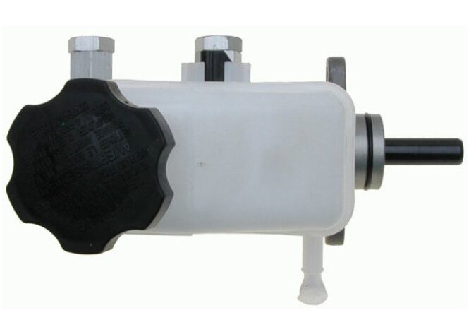

If your brake fluid is low, you can add some more. Your vehicle takes DOT 3 or DOT 4. It should say it right on the cap of the master cylinder. I will add a picture of a typical brake master cylinder for your information. Make sure you buy a new bottle though. Brake fluid attracts moisture and an open bottle of brake fluid that has been sitting around will collect moisture and cause the moisture to turn to a gas in your braking system, which is compressible unlike a fluid. So, using a new bottle of fluid is a must.

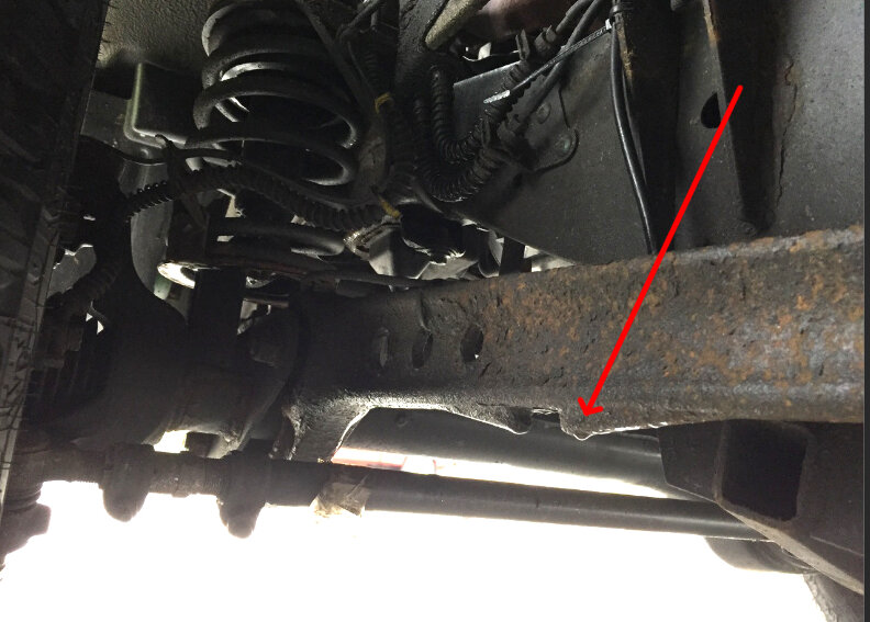

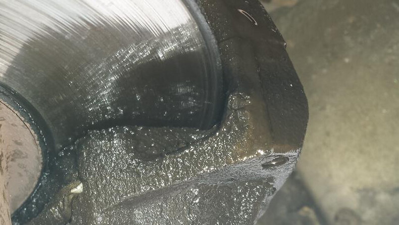

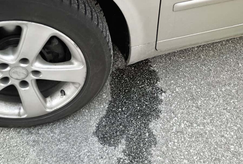

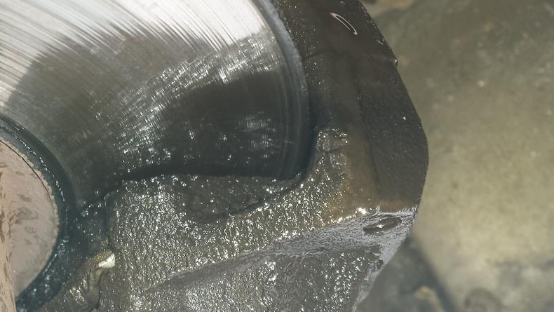

I have added a couple of examples of brake fluid leaks as well as a bottle of brake fluid of the kind I use on my own vehicles.
