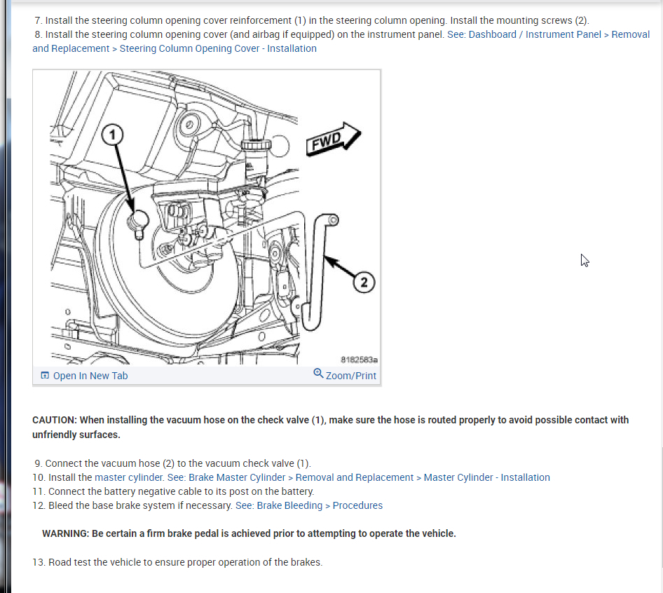

When I get into my car and start driving, my front brakes would squeal a lot when I first start off but then as a go the noise disappears.I've also noticed when i slow down I hear a missing from under the dash I need a new booster please help.
May 14, 2019 at 12:13 PM

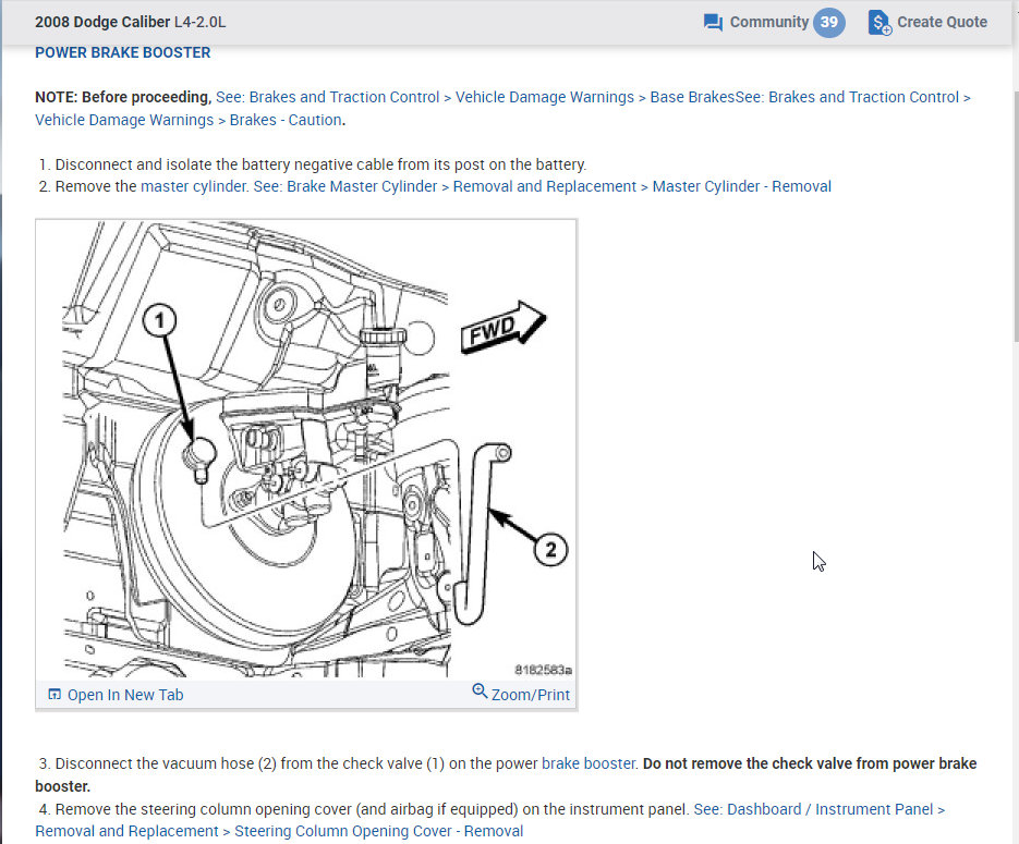

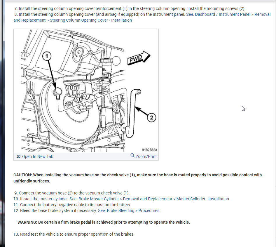

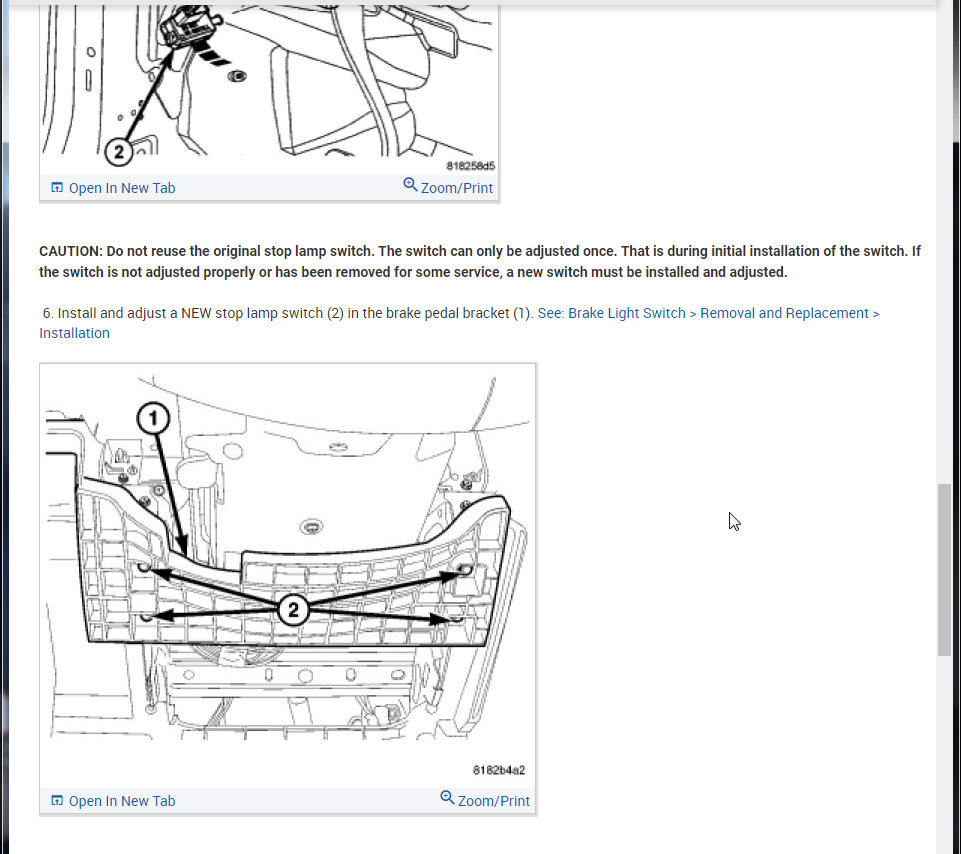

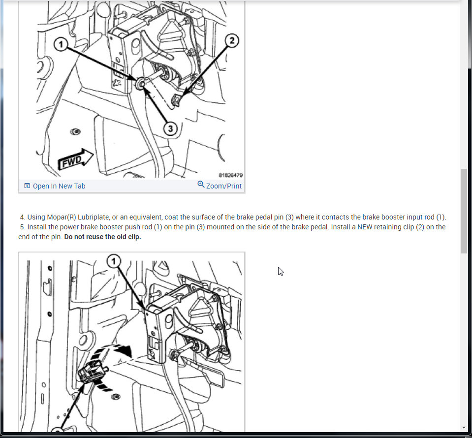

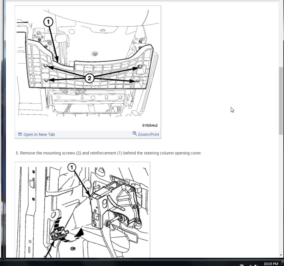

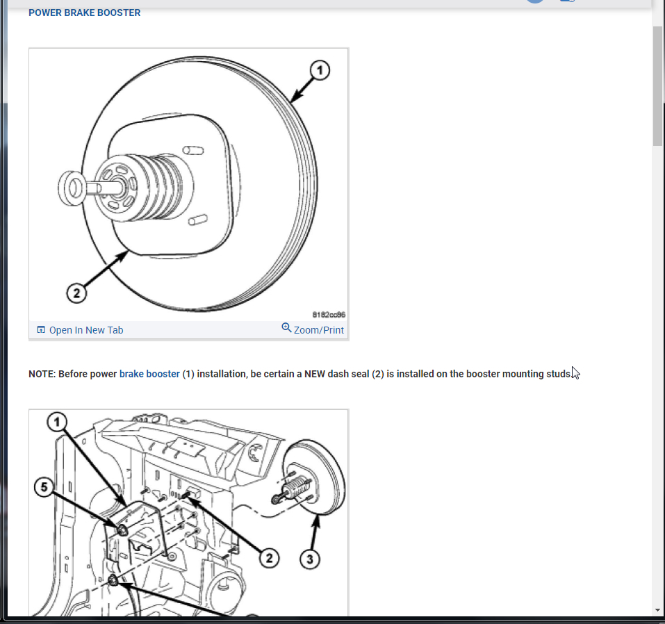

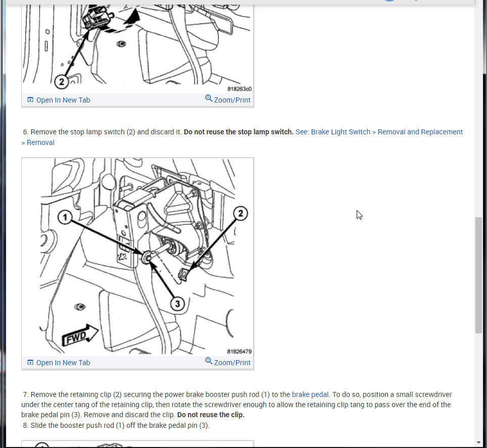

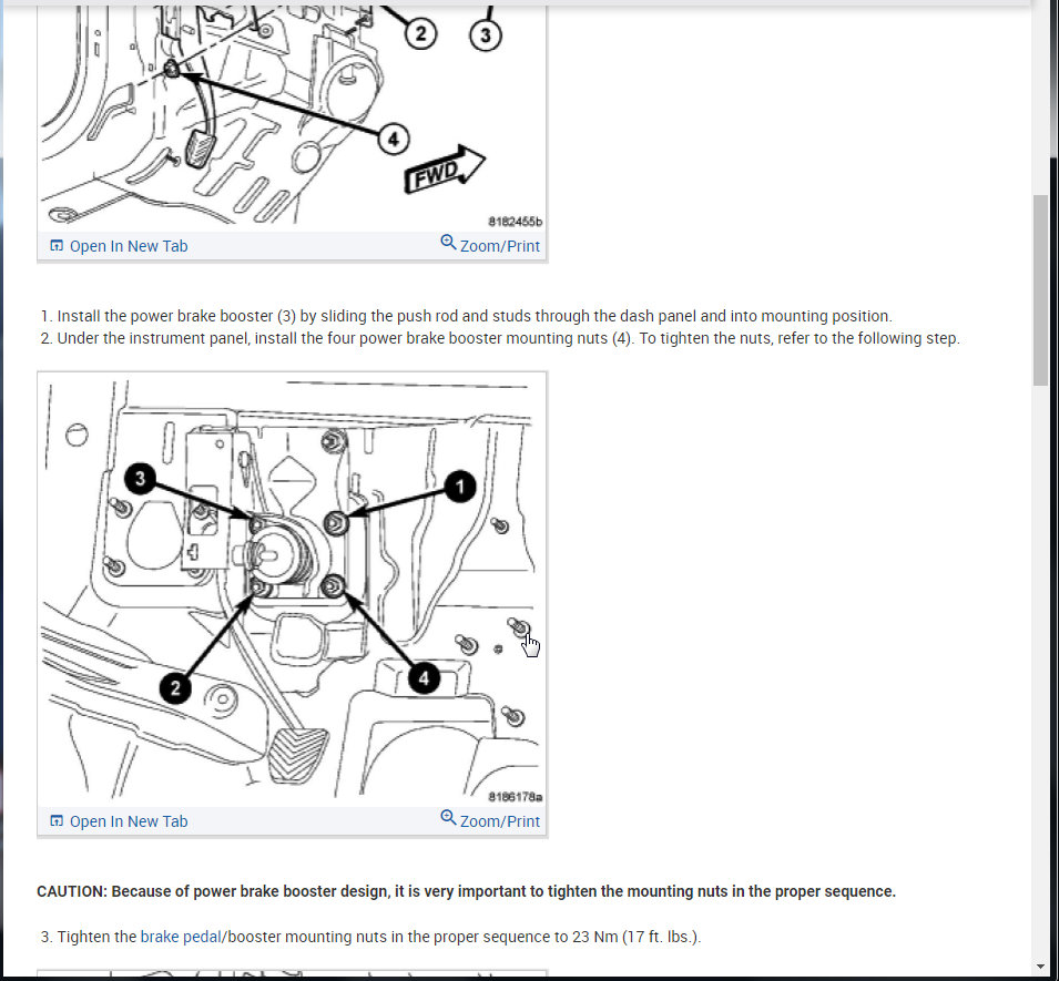

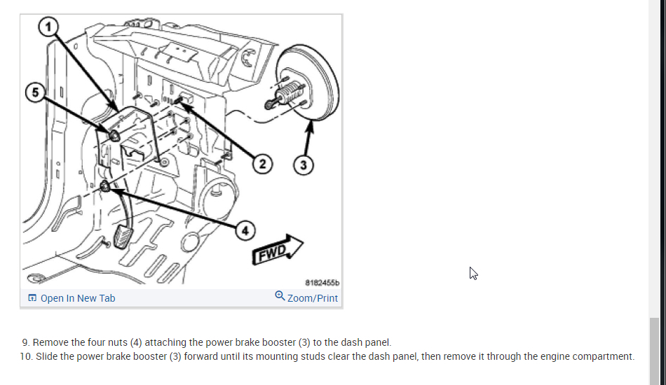

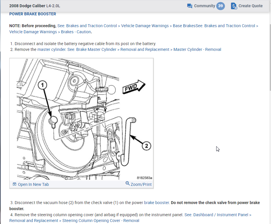

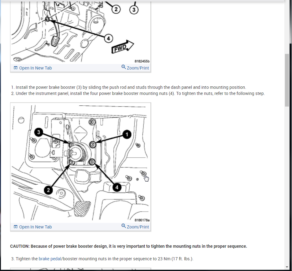

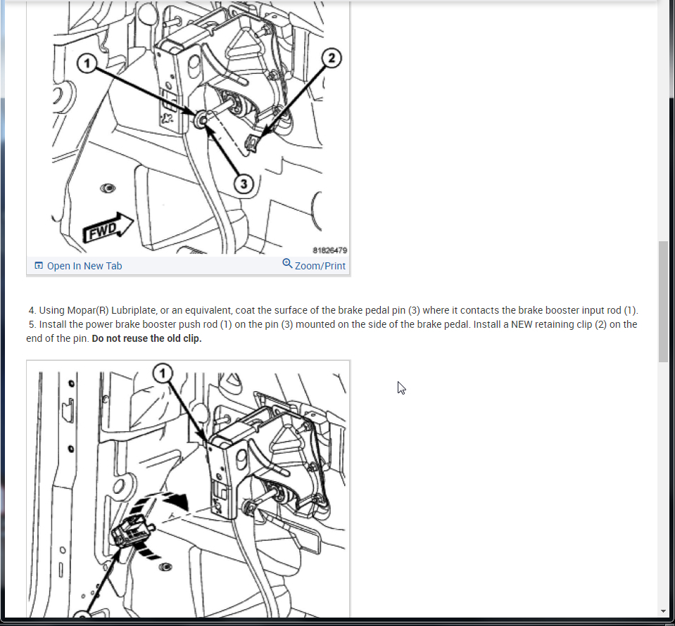

You are most likely correct that this is a booster issue so I attached the instructions below for your review.
Please let us know what you find after you replace it. Thanks for using 2CarPros.
