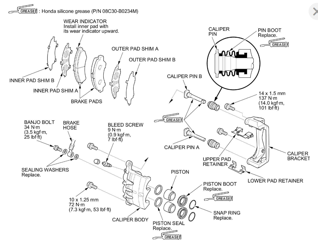

There are few reasons why you could have brake pull.
It could be due to seized brake calipers or failure of the brake hose that does not allow even pressure to the calipers.
It can also happen due to ball joint wear or faulty control arm.
Here is a helpful article that covers the typical reasons and goes over the steps:
https://www.2carpros.com/articles/car-pulls-right-or-left-when-driving-or-braking
Run thru this and let me know what you find.
