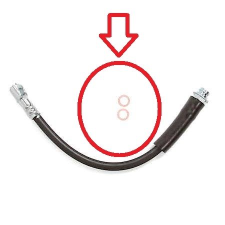

If it is right there where the hose meets the caliper.
The hose (rubber) could be leaking?
Maybe the threads on the hose are stripped?
My best hypothesis
The "copper" washer/ seal is messed up or even lost/ not installed! (replacing it would be cheap)
OR
Even cheaper!
My #1 pick!
The hose is not tight enough to sort of "squish" the copper seal into sealing.
