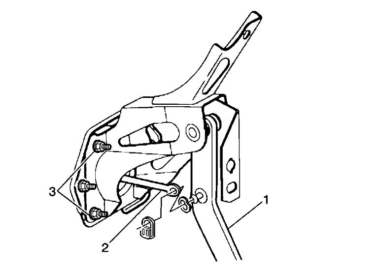

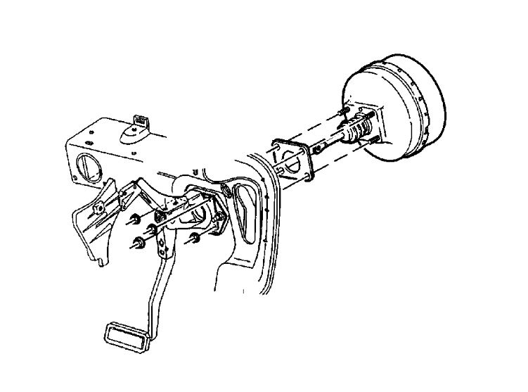

The booster has a vacuum leak and it is leaking out the shaft at the pedal.
I would replace the booster assembly.
