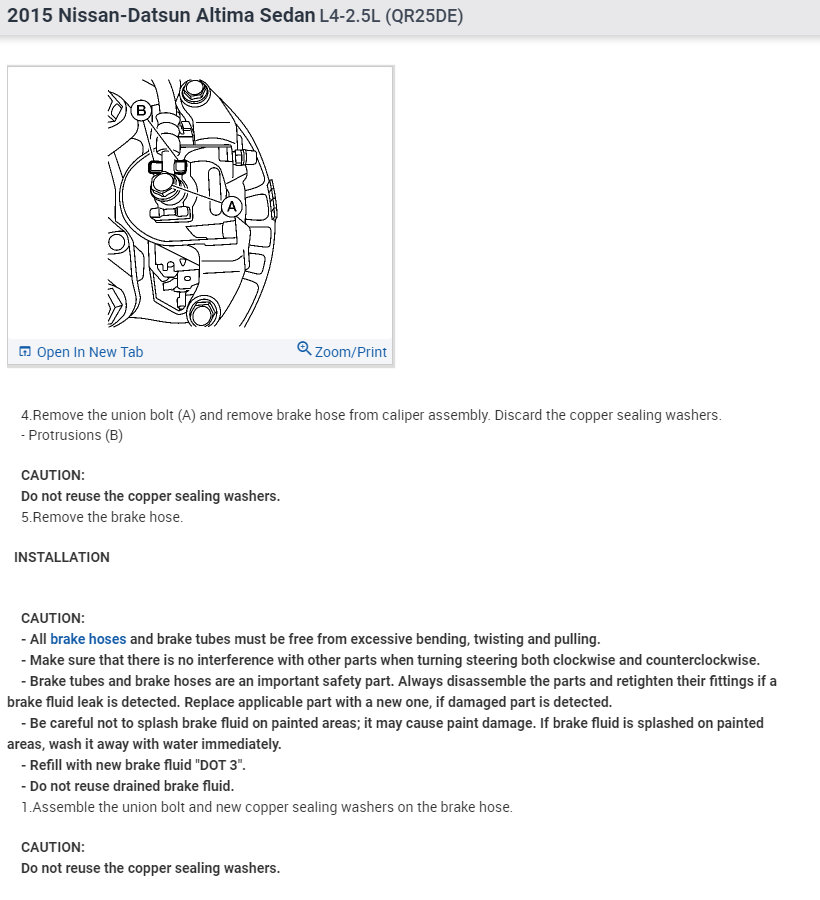

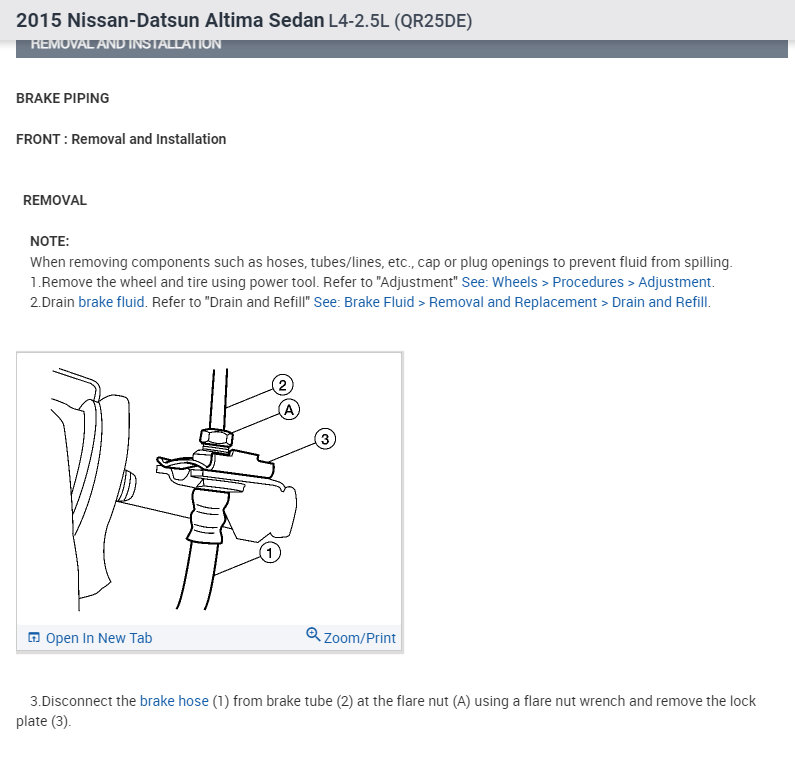

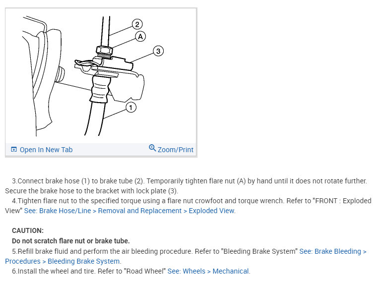

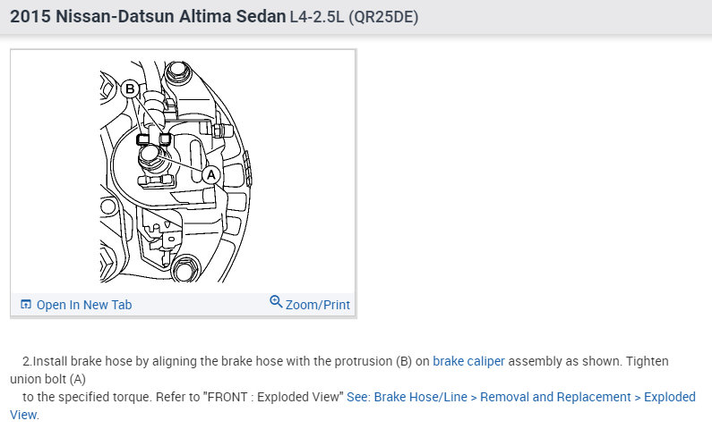

This could be a sticking caliper issue.
Usually, a caliper will stick for internal malfunction of the caliper of a collapsed brake hose. When a brake hose collapses it does not allow the caliper piston to retract back into the housing. This makes the pads to rub against the rotors.
When a caliper sticks it typically generates excess heat due to all the friction.
When does it make the noise? When you press the brake or as the vehicle drives down the road?
Did this issue exist before the replacement of the pads?
Please let me know what you are experiencing.
Thank you.
https://www.2carpros.com/articles/brake-caliper-replacement
