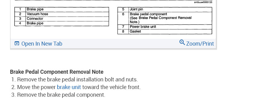

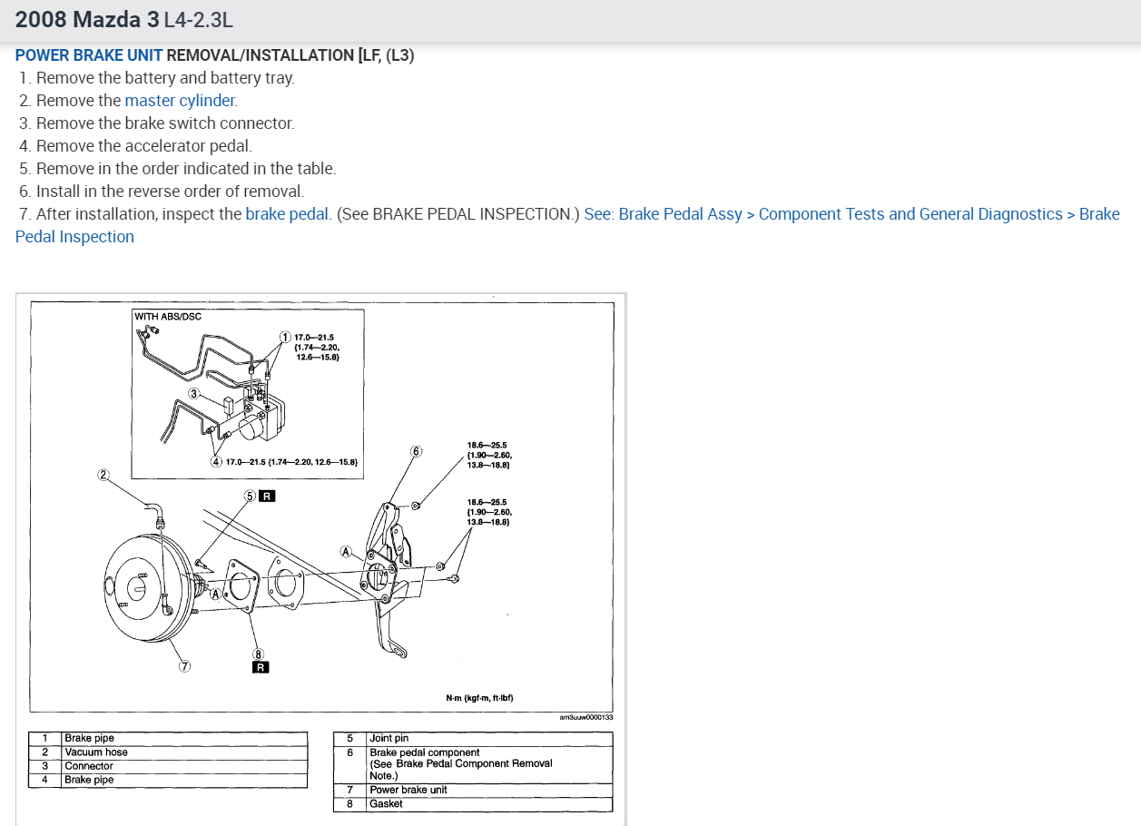

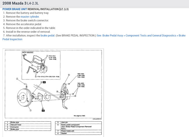

Yes, the booster is most likely the problem, here is a guide to help and instructions in the images below to help you change it out:
https://www.2carpros.com/articles/a-comprehensive-guide-to-fixing-automotive-brakes-locking-up
There are two primary components you might want to focus on: the master cylinder and the brake booster.
Check out the images (below). Please let us know if you need anything else to get the problem fixed.
