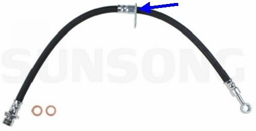

Loosening the master cylinder from the booster is a valid test. It proves the rubber flex hoses aren't constricted, typically from rust forming under a bracket crimped around the hose, and it proves the brake fluid is not contaminated with a petroleum product. That causes rubber parts to swell. The rubber lip seals in the master cylinder will grow past the fluid return ports and block them, keeping the brakes applied.

The next step, when the locking occurs, is to loosen the soft metal line nuts for the steel lines at the master cylinder. If brake fluid spurts out and the brakes release, we can rule out everything beyond that point, including constricted hoses. The only possible cause is the fluid return ports in the master cylinder are blocked. If that just started with the new master cylinder, the length of the power booster's push rod is suspect. If this problem occurred with the old master cylinder, contaminated brake fluid is the better suspect.
Any petroleum product that gets introduced into the brake fluid reservoir will cause locking brakes after a few days to as much as a week. This includes engine oil, transmission fluid, power steering fluid, penetrating oil used to loosen rusted brake line fittings, and axle grease, commonly from residue on our hands after repacking wheel bearings. First affected will be the rubber lip seals in the master cylinder. You'll also find the rubber bladder seal under the reservoir cap is blown up and mushy. You usually won't be able to pop it back into the cap. Replacing the master cylinder will appear to solve the problem at first, but it will come back within a few days. The only proper repair is to remove all parts that contain rubber parts that contact the brake fluid, flush and dry the steel lines, then install new rubber parts. That will include the master cylinder again, the calipers, rear calipers or wheel cylinders, all the rubber flex hoses, the combination valve under or near the master cylinder, and the height-sensing proportioning valve, if used, (that's mainly a minivan and pickup truck thing). It also includes the hydraulic controller if the vehicle has anti-lock brakes as it has rubber o-rings and seals. If any contaminated rubber part is not replaced, the contamination will leach out of it and recontaminate the new brake fluid. That will recontaminate all the new rubber parts. This gets to be a very expensive repair and can easily render an older vehicle not worth repair.
Based on your observation that pulling the master cylinder forward a little on its mounting studs let the brakes release, we shouldn't have to go any further, but for the benefit of others researching this topic, if the brakes remain locked when doing this, the pressurized brake fluid is being trapped further down the line. This is where the rubber flex hoses are by far, the most common cause. Two things typically happen to them. First, on designs that include a metal mounting bracket crimped around the middle of the hose, as shown in this photo, rust can build up and squeeze the hose closed. You can force brake fluid through that restriction with normal foot pressure, but then that fluid can't return freely to the reservoir. Being trapped under pressure keeps that brake applied, the heat builds up very quickly. That heat migrates through the caliper, into the brake fluid, causing it to expand and apply that brake even harder. On Chrysler front hoses, that crimped mounting bracket can be opened up with a large flat-blade screwdriver or a large pair of pliers in a few seconds. On most imports, that fitting is a barrel the hose goes through. It has no gap to spread open, so the hose must be replaced.
One potential clue to a constricted hose is it usually causes only one front brake to lock up first. The other one develops that problem months or years later. When you have both front brakes locking at the same time, look for what they have in common. That's the master cylinder and brake pedal.

The second thing that can happen to a rubber flex hose is a tear in the inner liner that forms a flap, then a check valve. This occurs when a do-it-yourselfer slaps on new brake pads and during the service, lets the caliper hang by that hose. Even worse is when the caliper was set off to the side, then accidentally fell down, tugging on the hose. This damage is harder to identify, especially when you don't know the vehicle's history that led up to the locking brake problem. To prevent this, hang the caliper with a piece of wire or a rubber strap to keep its weight off the hose.
