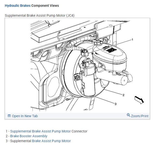

I would second the brake booster there is a technical service bulletin( #PIT3665J: Brake Pedal Moves or Self Applies at Full Turns - (Jun 26, 2020))
Condition / Concern
On vehicles with a Hydro-Boost System, customers may notice during full lock turns or near full lock turns that the brake pedal will move down or self apply. This can be caused by the internal dump valve of the hydro-boost not seating properly due to contamination in the steering system. The hydro boost assembly is not tolerant to certain types of contaminates that may be present in the steering system.
Recommendations / Instructions
The Hydro-Boost System is not serviceable and must be replaced.
Important: —Before replacement of the Hydro-Boost System, the entire steering system (including power steering pump, lines, cooler, and gear box) must be flushed to avoid a reoccurrence.
I am glad to help you, If there is anything else we can help you with please contact us again. Thank you for choosing 2CarPros.
Check out the diagrams (below).
