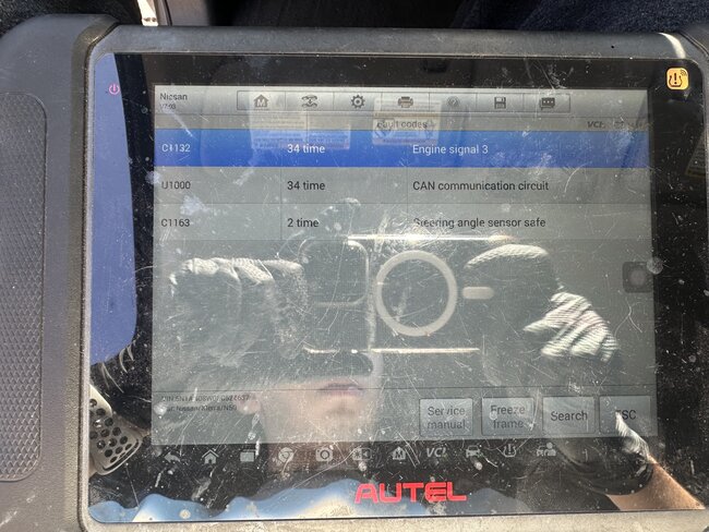

Bought it with a soft brake pedal. Vacuum holds when pumping brakes, replaced master cylinder and bled brakes, got better, but after reading on it turned out these have mushy pedal. VSC off light sometimes comes on when i start it, once i drive off, it goes away. Also, this has a button to change from 2 to 4wd, when in 4wd is it supposed to be this hard to move the car on a driveway when in 4wd mode and wheel turned? I scanned it and got these codes. I replaced the battery as it kept on dying, not sure of codes were from before or after battery replacement.

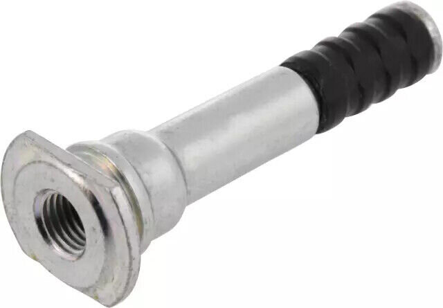

Unreal how the brake pedal feels after i lubricated all 8 pins. The front caliper has a plastic sleeve on the bottom pin and no matter what i did it won't go back in with it on the pin. So, i removed it and put it back to see. All good for now. Didn't even have to bleed it again. Are those plastic sleeves very important?
Jan 5, 2025 at 8:08 AM
They might keep the caliper from rattling, if you load an image of what you are talking about, I can tell for sure, glad you got the problem solved.
Jan 5, 2025 at 12:32 PM
BHAMDOC1973
  • 2,008 POSTS
Like this one?
Jan 5, 2025 at 4:25 PM
Yep, that will help the caliper be quiet while not it use. kind of like a dampener.
Jan 6, 2025 at 10:01 AM
