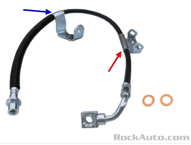

The most tedious is to loosen the bleeder screws at the front calipers. If only one front wheel is getting hot, that's the one to open the bleeder screw on. This is where roughly half of locking brakes will release, and a real common cause is a restricted rubber flex hose. This has happened to me multiple times on my older Dodge Caravans, especially after I let them sit over the winter. The fix on those is very easy. If you look at the photo below of your front brake hose, the arrows are pointing to two metal brackets crimped around the hose. This is the first time I've seen two of them on one hose, so you have twice the chance of this happening. Rust builds up inside those crimps, constricting the hose. You can easily force brake fluid through that restriction with normal pedal pressure, but the fluid won't release freely. It keeps that brake applied, then heat is generated. That heat migrates into the brake fluid causing it to expand and apply that brake even harder. When this gets bad enough, that wheel will cause a harsh thumping felt in the steering wheel, and that wheel will get very hot. With a hose constricted like this, the only place you can release the trapped pressurized brake fluid is at the bleeder screw on the caliper.

Back to those hoses, when they became constricted on my vehicles, I found all that was needed was to open up those crimps a little with a large flat-blade screwdriver, or a large pair of pliers. There was no need to remove a wheel, but I did have to lay on the ground to do that. Your metal brackets look rather beefy, so I don't know if bending them to open them up will be possible.
