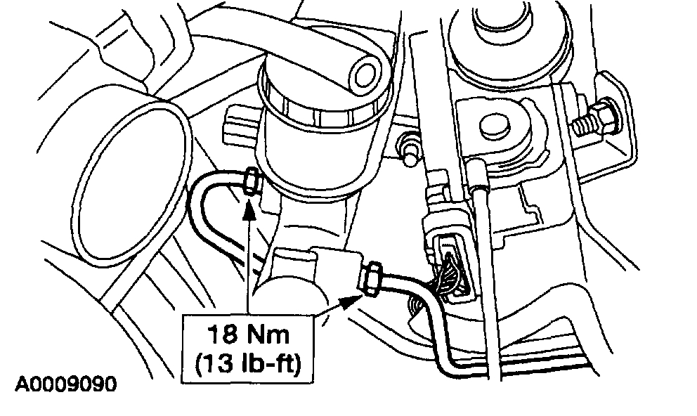

1. Disconnect the battery ground cable.
2. Remove the air cleaner outlet pipe.
pic 1

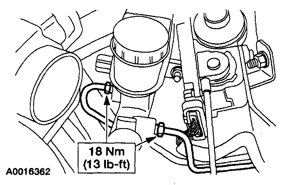

3. Disconnect the brake fluid level sensor electrical connector.
pic 2

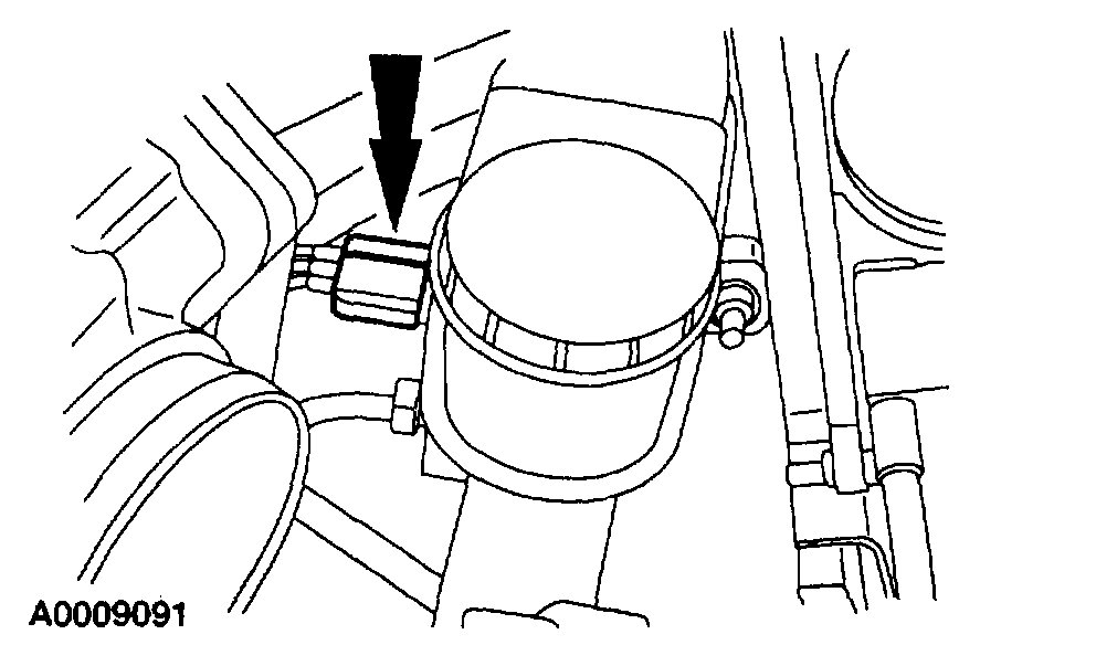

4. Loosen the fittings and disconnect the brake tubes.
pic 3
5. Remove the bolts and the brake master cylinder.

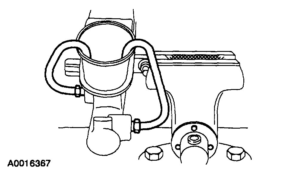

pic 4
1. Disconnect the brake fluid level sensor electrical connector.

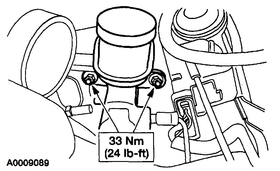

pic 5
2. Use a suitable suction device to drain the brake master cylinder reservoir.
3. Using a screwdriver, carefully pry up on the brake master cylinder reservoir and remove.

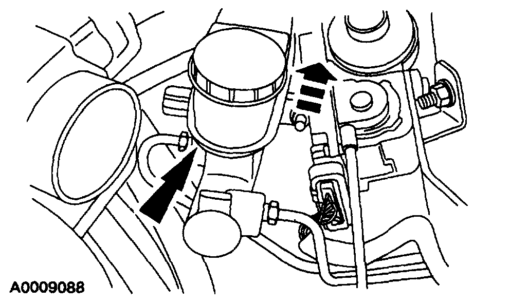

pic 6
1. For in-vehicle priming, disconnect the brake lines from the brake master cylinder .
