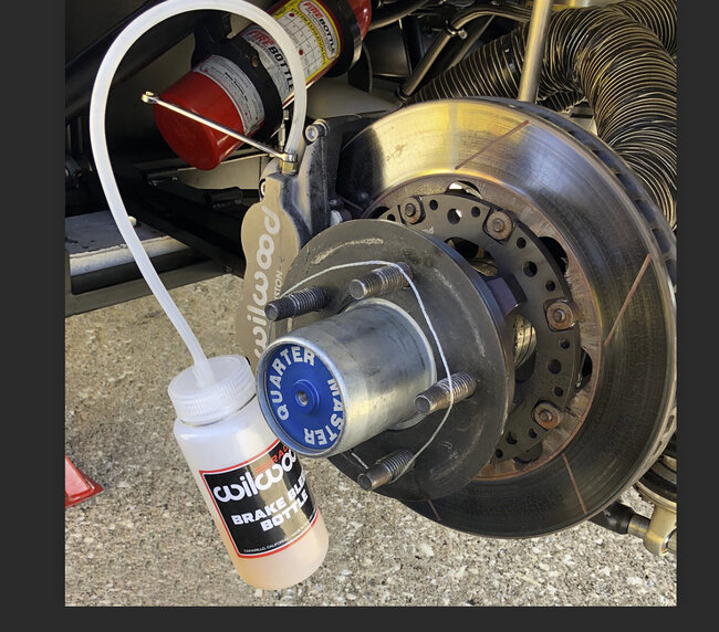

What are you using to bleed it? The best way i found is to use a bottle with brake fluid in it with a hose. With one end of the hose on the bleeder and the other end in the fluid, have an assistant pump the brakes and hold on the third pump.
While they are holding, open the bleeder. When the pedal hits the floor have the assistant tell you "floor" and close the valve. Repeat the process over and over until you have a good pedal, and all air is gone.
Use a clear flexible tube and a Gatorade bottle. A Gatorade bottle stands up the best on it's own. Make sure the other end of the tube is always under the brake fluid in the bottle.
This will ensure no more air is entering the caliper.

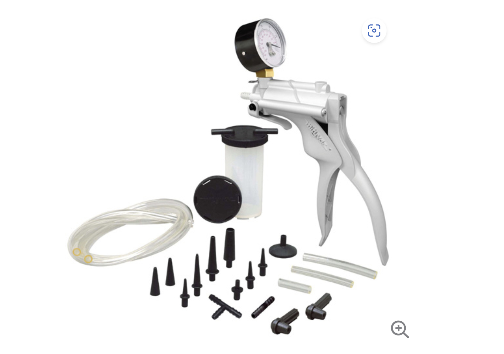

If you don't have an assistant to pump and hold the brakes, a vacuum bleeder might be a better choice.
Here is a link to one from Mighty Vac:
https://www.tooldiscounter.com/product/mityvac-automotive-tune-up-and-brake-bleeding-kit-mitmv8000?msclkid=9cf94c62d85d12fa02722819aa4724b4
These do work but prepare to squeeze this thing over and over and over. lol. They do make electric ones too.
