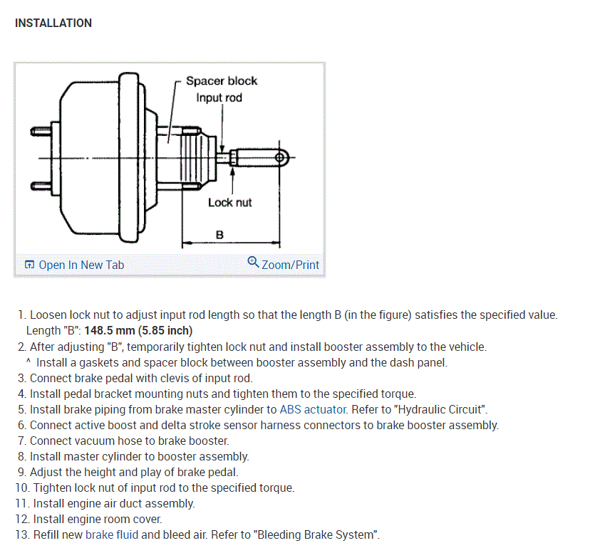

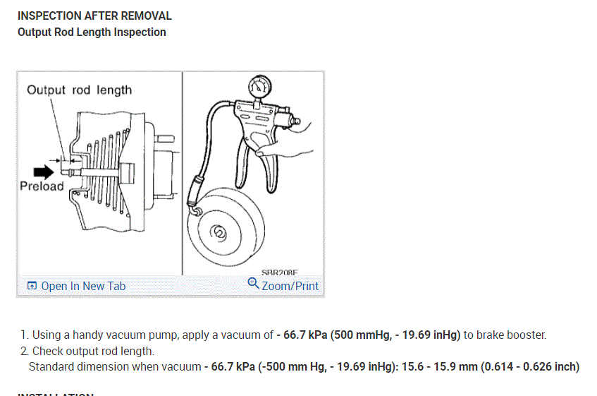

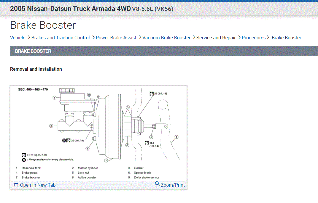

My brake pedal goes to the floor. All my lights, slip, VCD come on. I have replaced the power booster and I have replaced my master cylinder. We have bled off brake lines at the tires and at the ABS control module. We are getting clear fluid to all the lines but still the pedal keeps going to the floor. My pads in the rear are a bit low. I was told maybe I might need to replace the ABS module but I'm not sure I'm just trying to figure out if there's anything else before I have to spend $600.00 to $700.00. Thank you.
