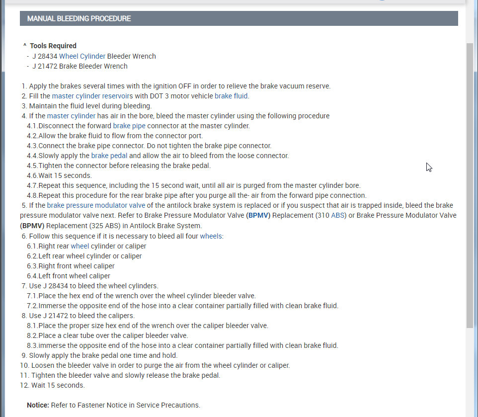

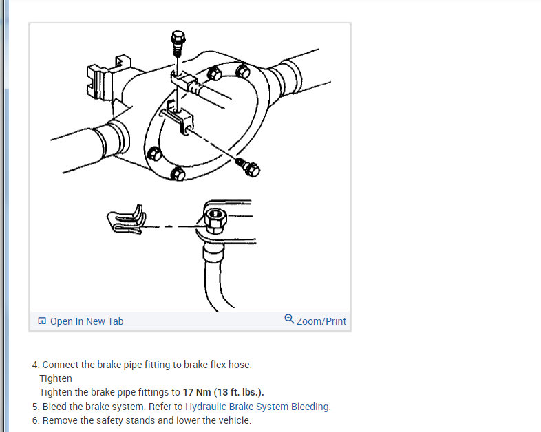

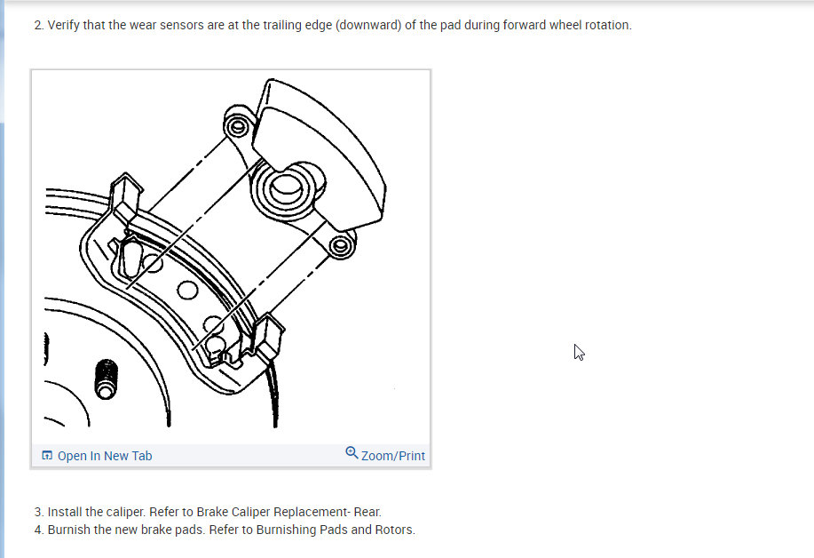

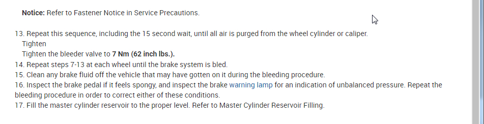

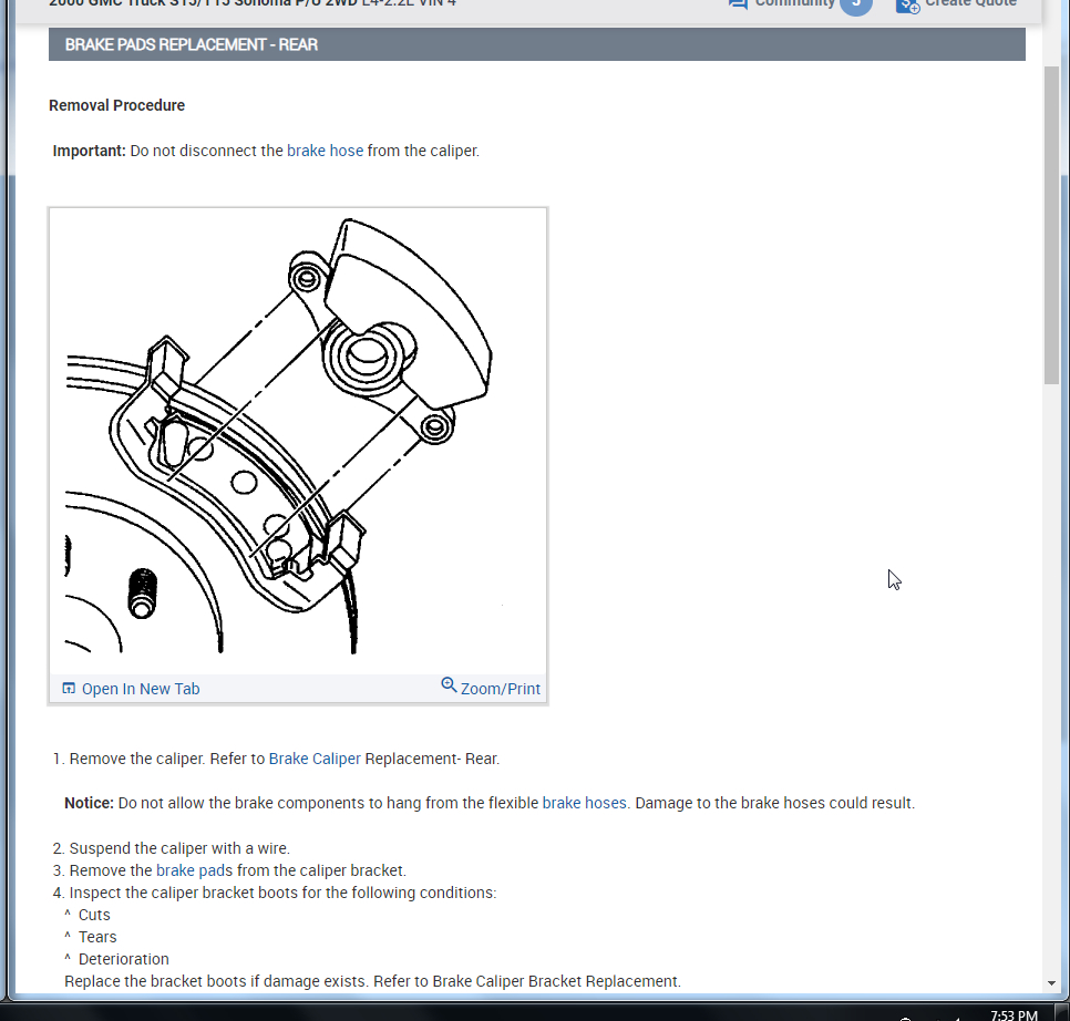

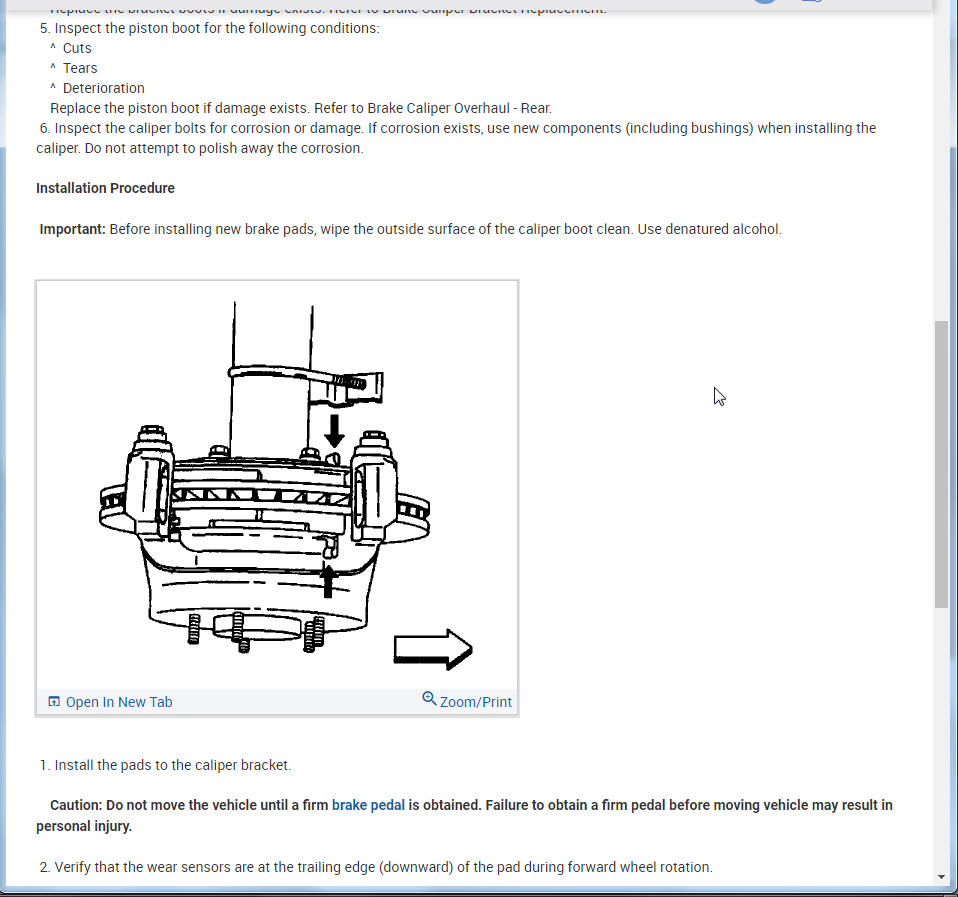

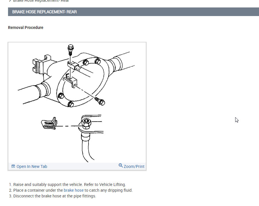

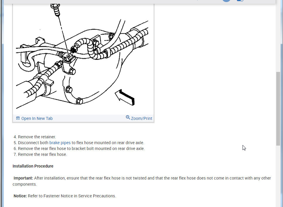

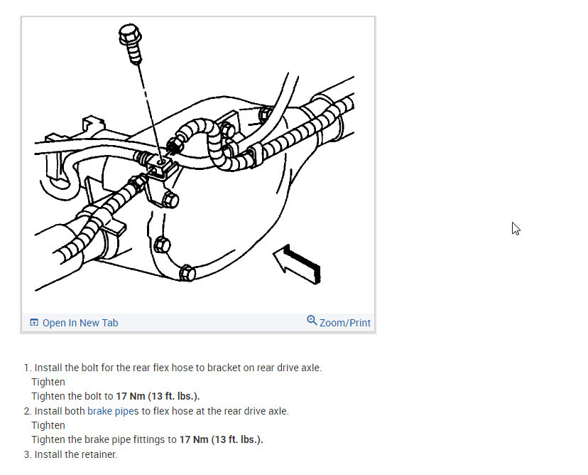

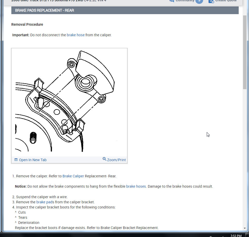

Replacing rear line and pads. Also need to know about how to bleed when done.
Dec 26, 2020 at 1:21 PM
Please review these guides as they will help as well with replacing pads and bleeding the system.
https://www.2carpros.com/articles/how-to-replace-rear-brake-pads-and-rotors
https://youtu.be/w7gUsj2us0U
Below is the attached info from the manual on these things as well.
Please let us know if you need other info. Thanks
