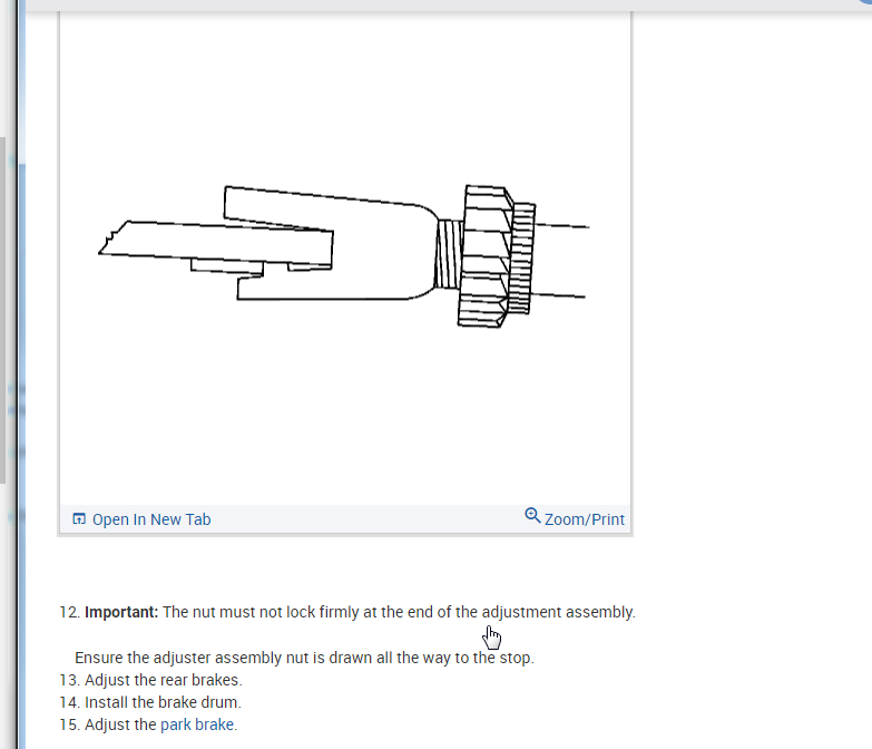

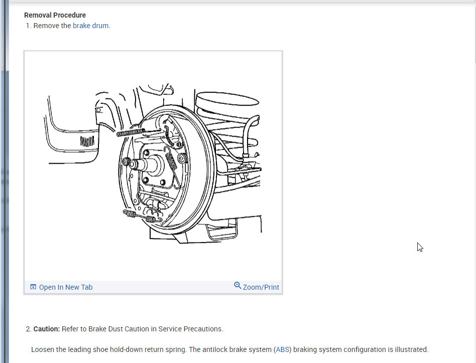

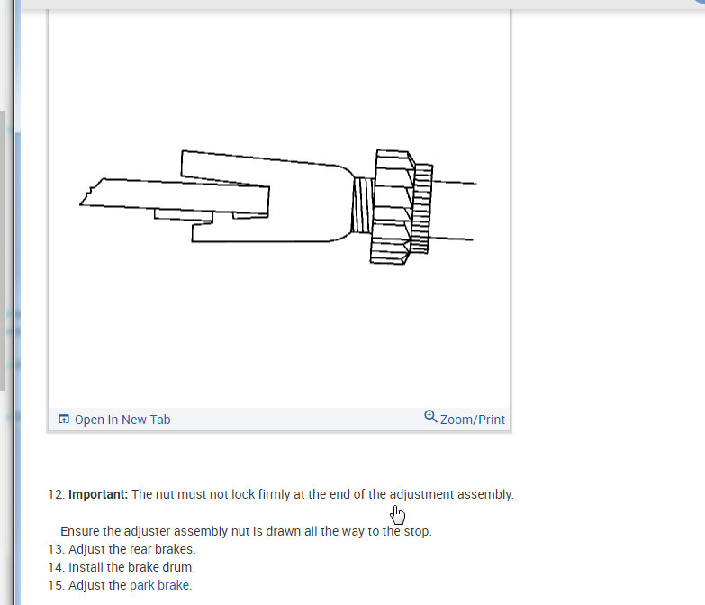

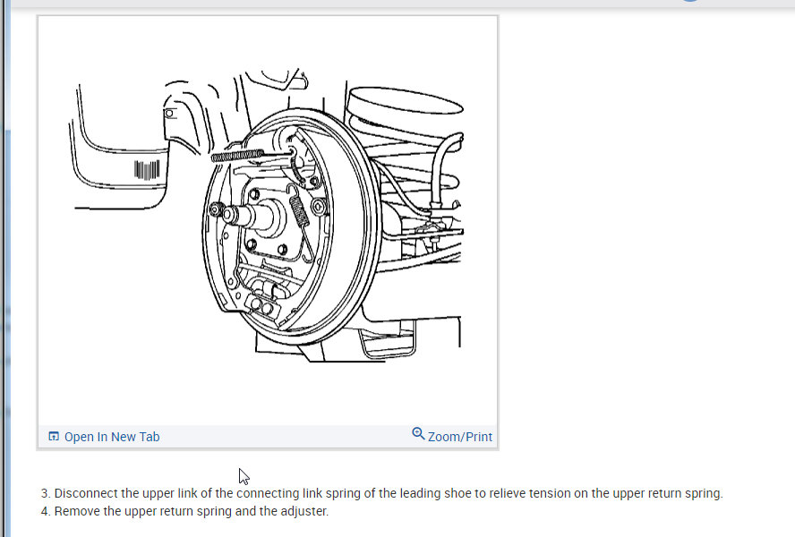

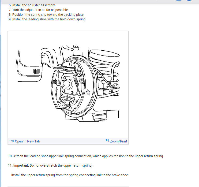

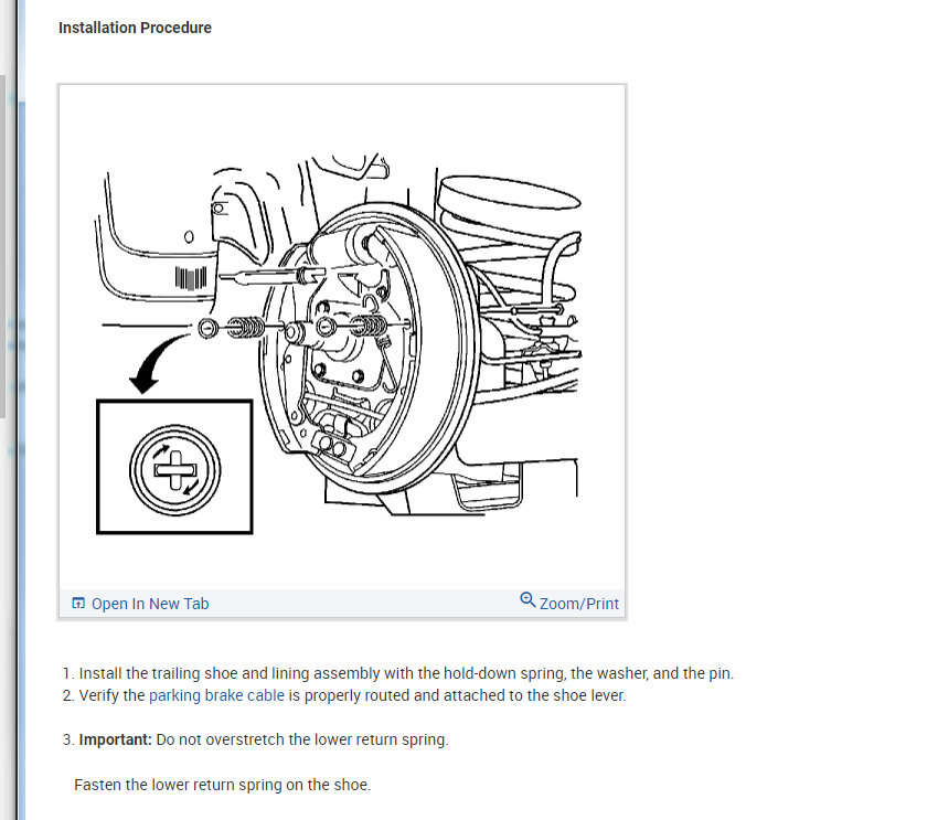

Here is a guide that will help with this. More then likely the shoes are adjusted too far out and you need to pull them back in to get the drum on them.
https://www.2carpros.com/articles/how-to-replace-rear-brake-shoes-and-drums

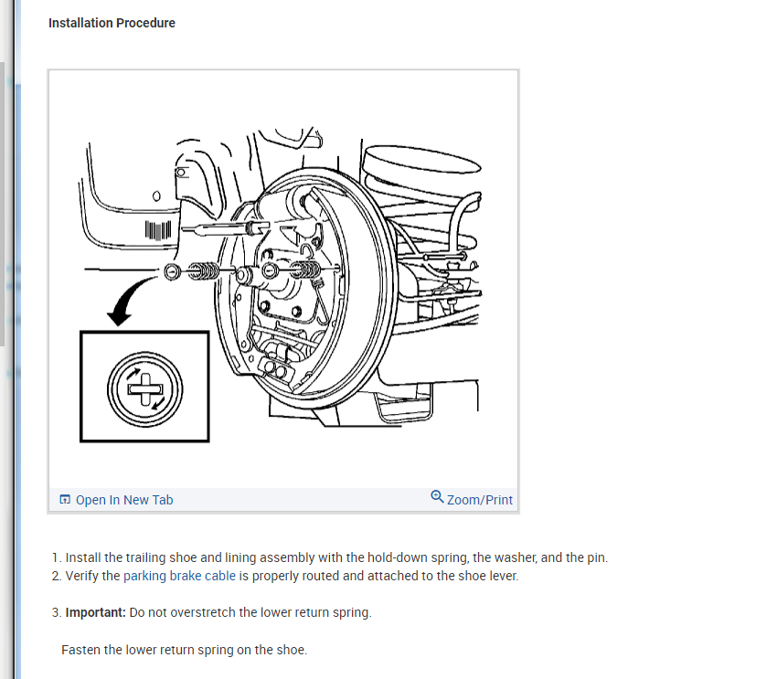

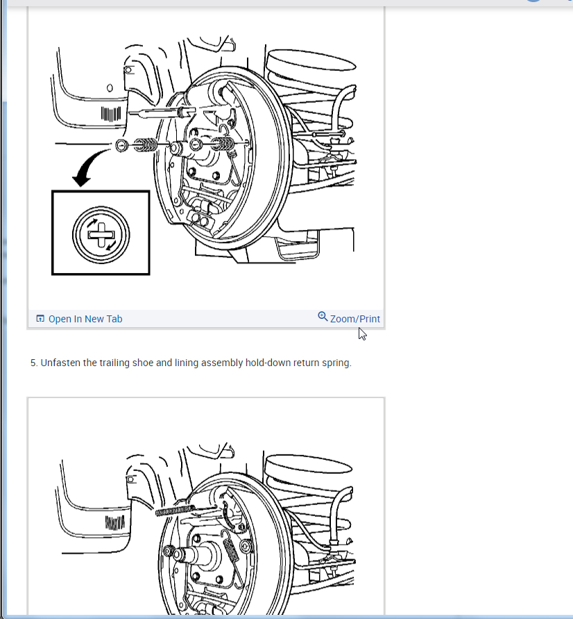

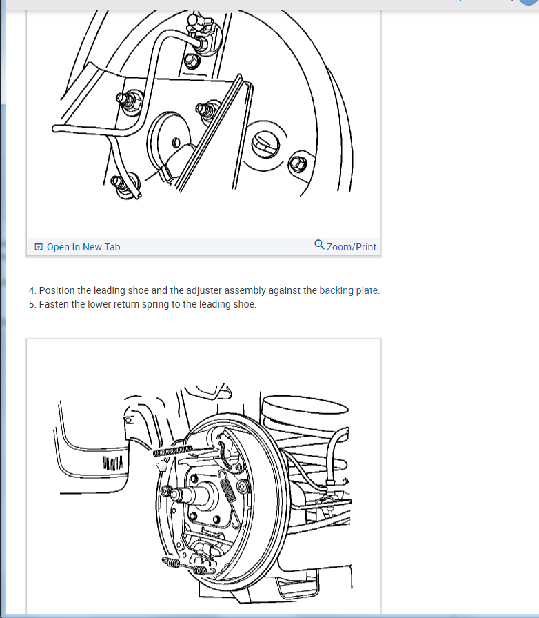

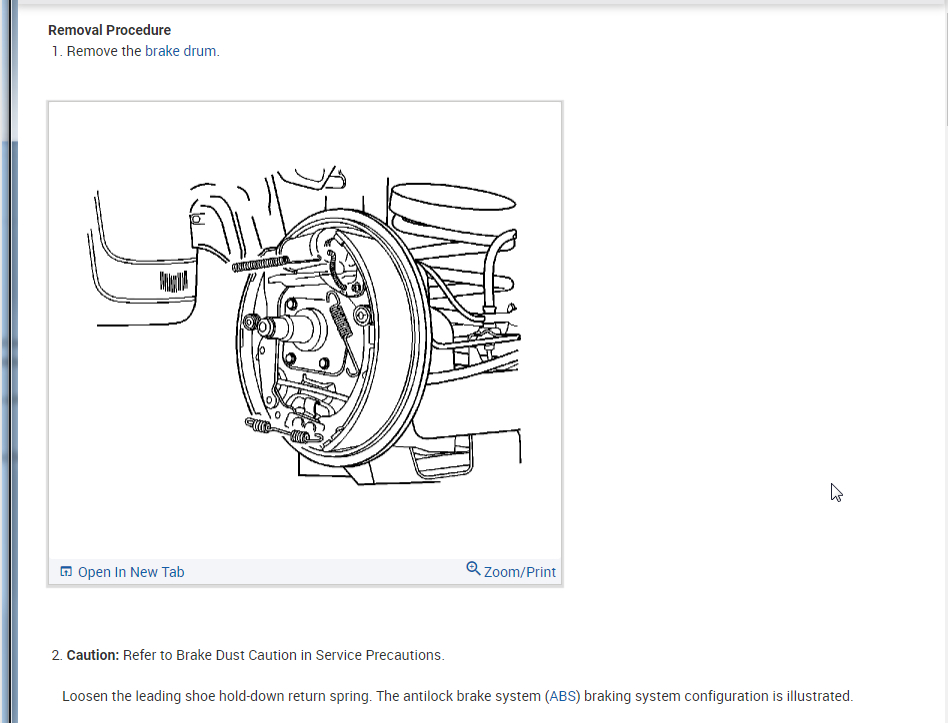

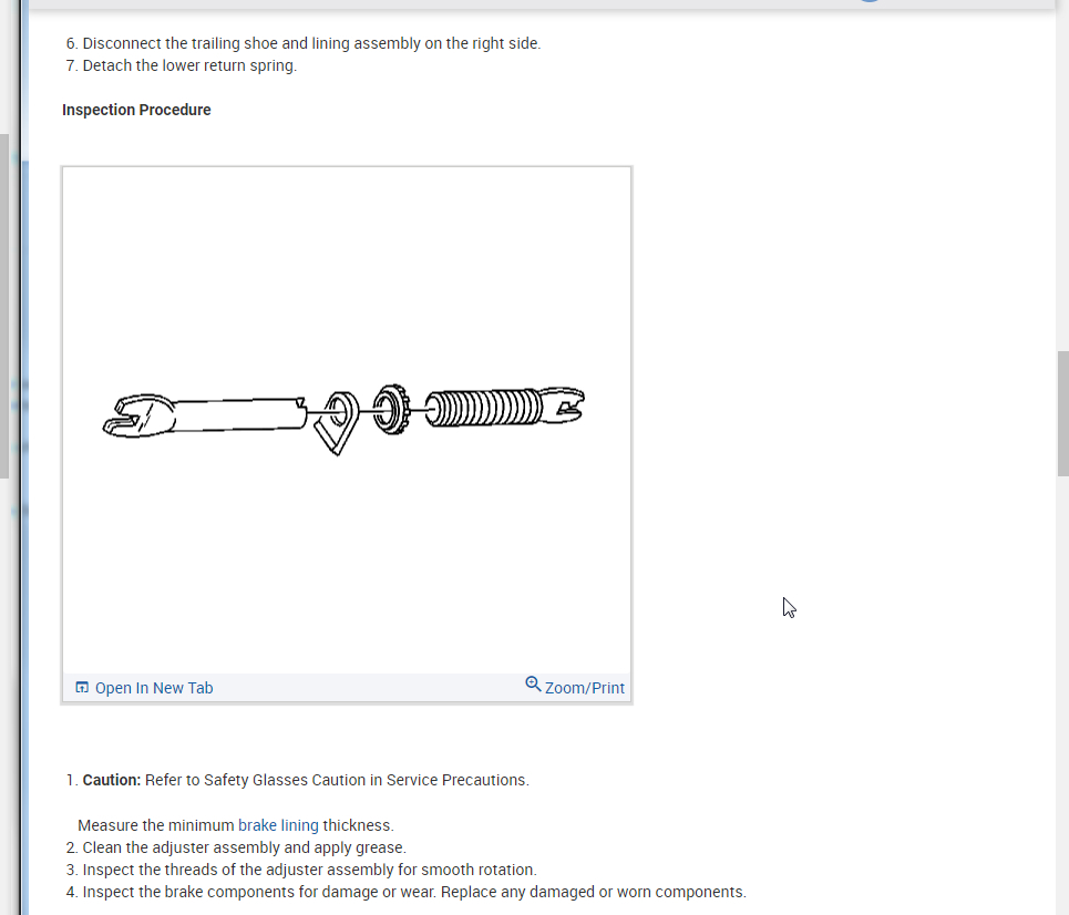

Below is the process from the manual on how to replace the shoes and drums.
Let us know if you have other questions. Thanks
