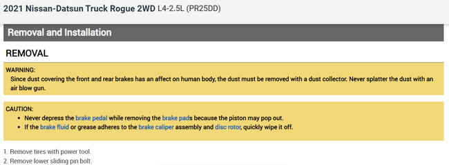

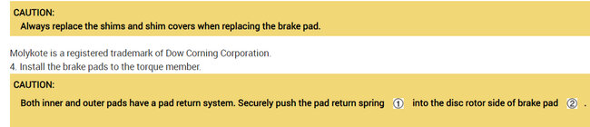

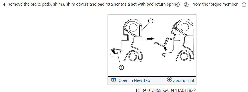

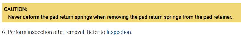

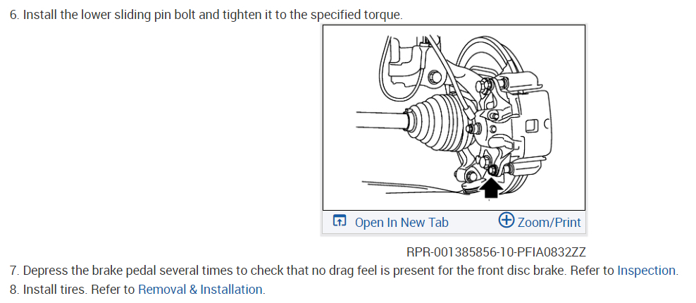

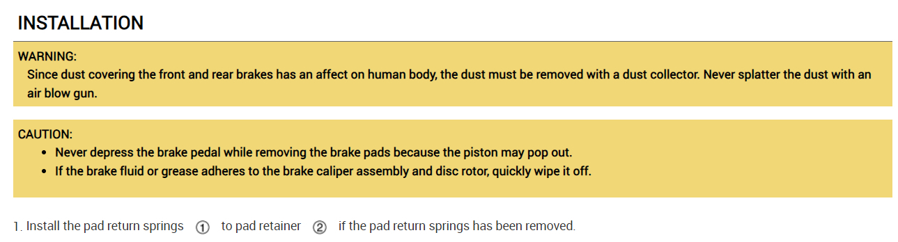

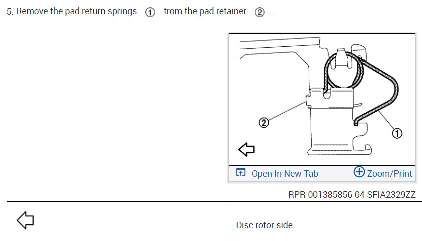

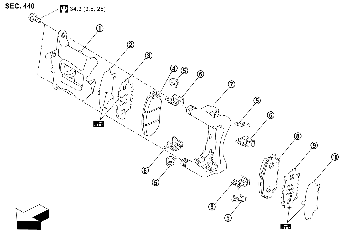

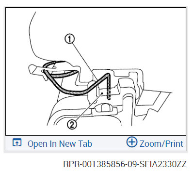

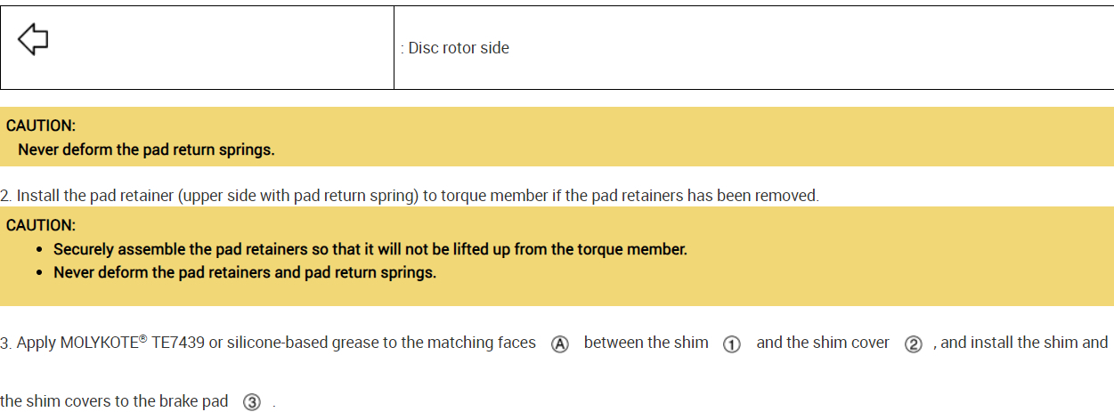

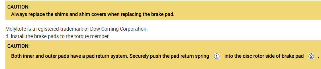

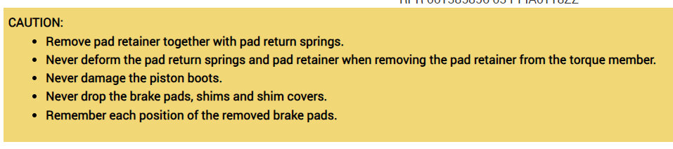

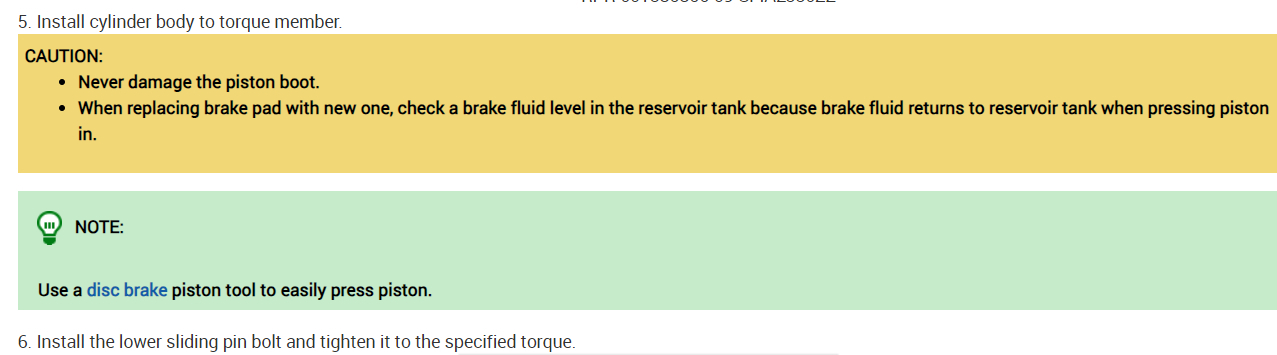

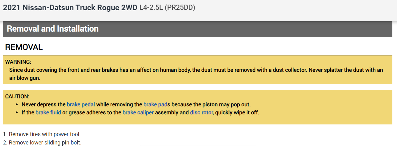

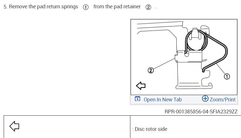

Have you looked at the brake pads in the front and rear? Also, can you tell where the noise is coming from front or rear? I have seen front pads wear out and cause noises here is how to change out the pads and rotors in case you need them.
Check out the images (below). Please upload pictures or videos in your response to the problem so we can see what's going on.
