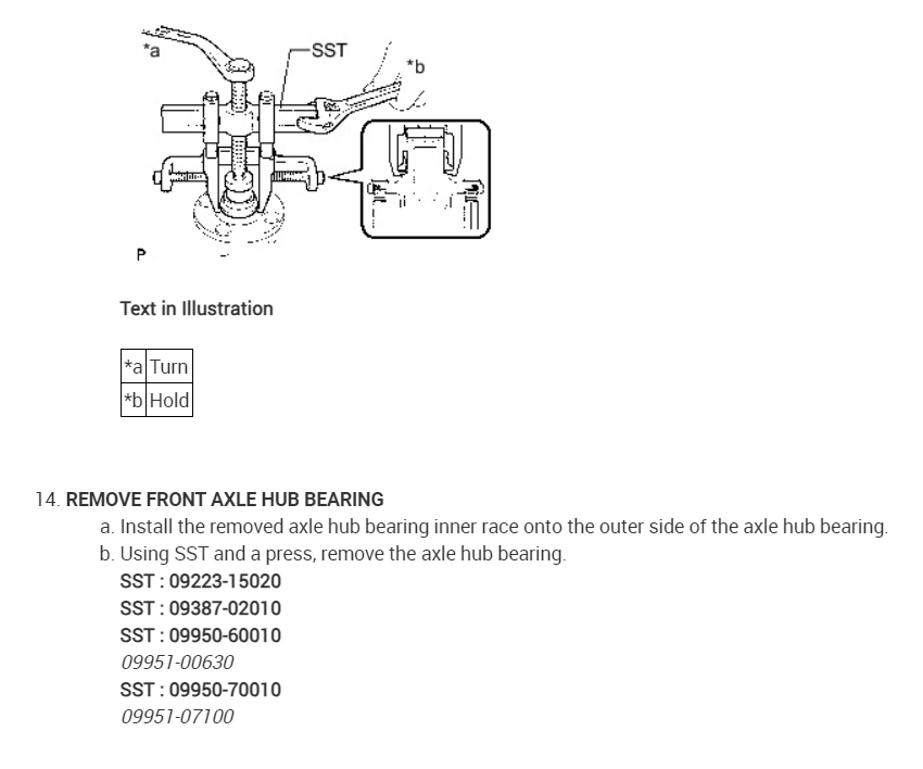

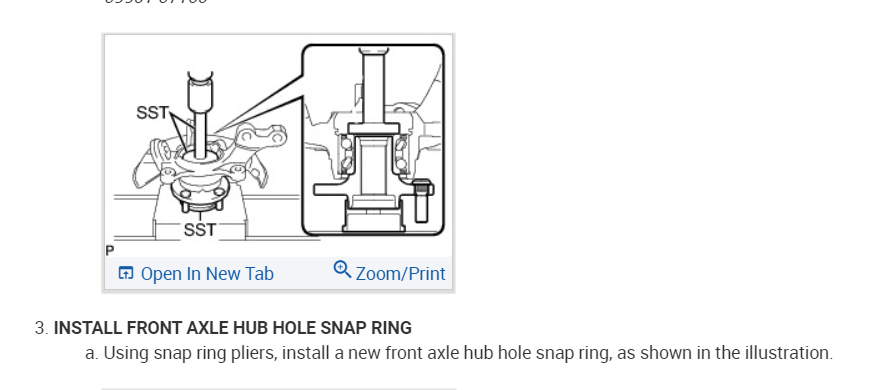

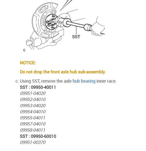

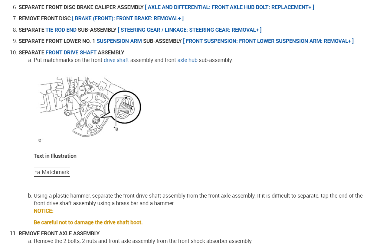

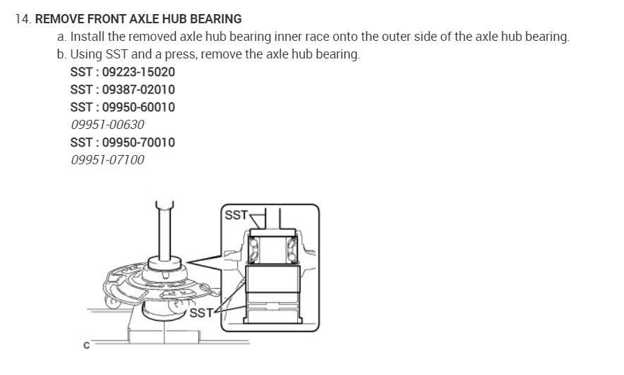

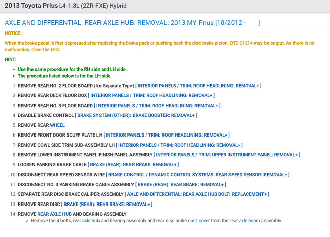

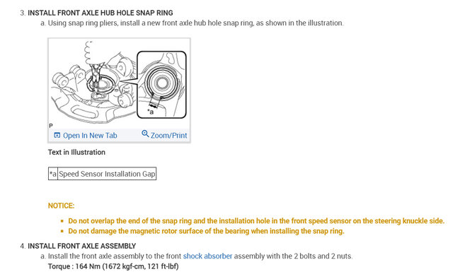

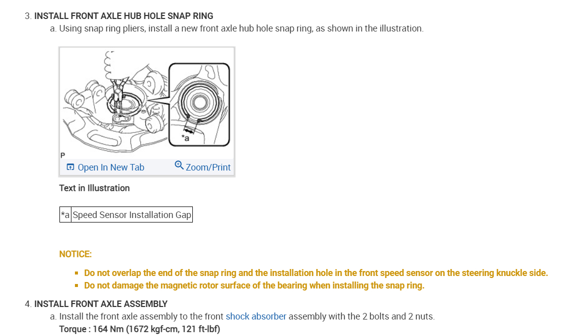

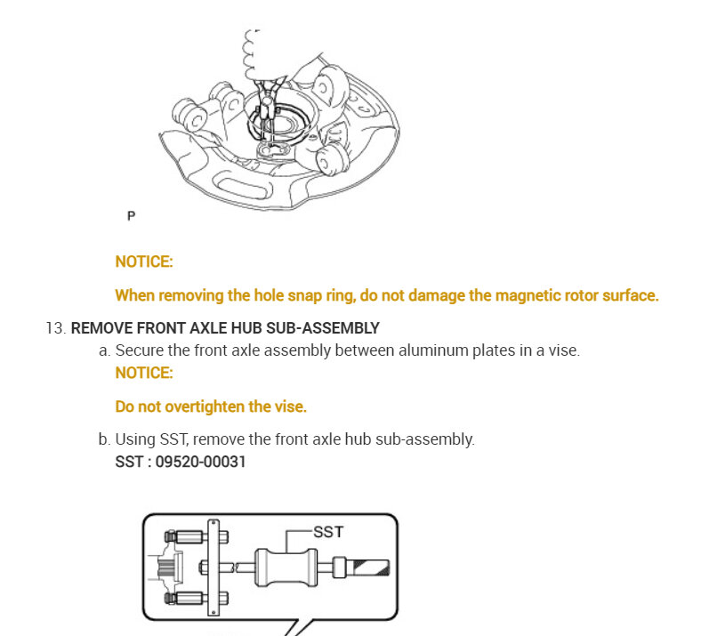

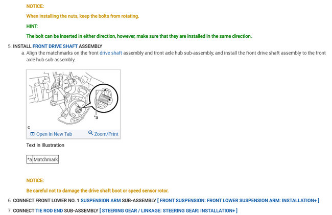

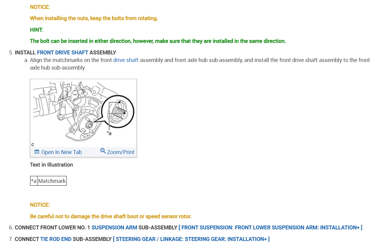

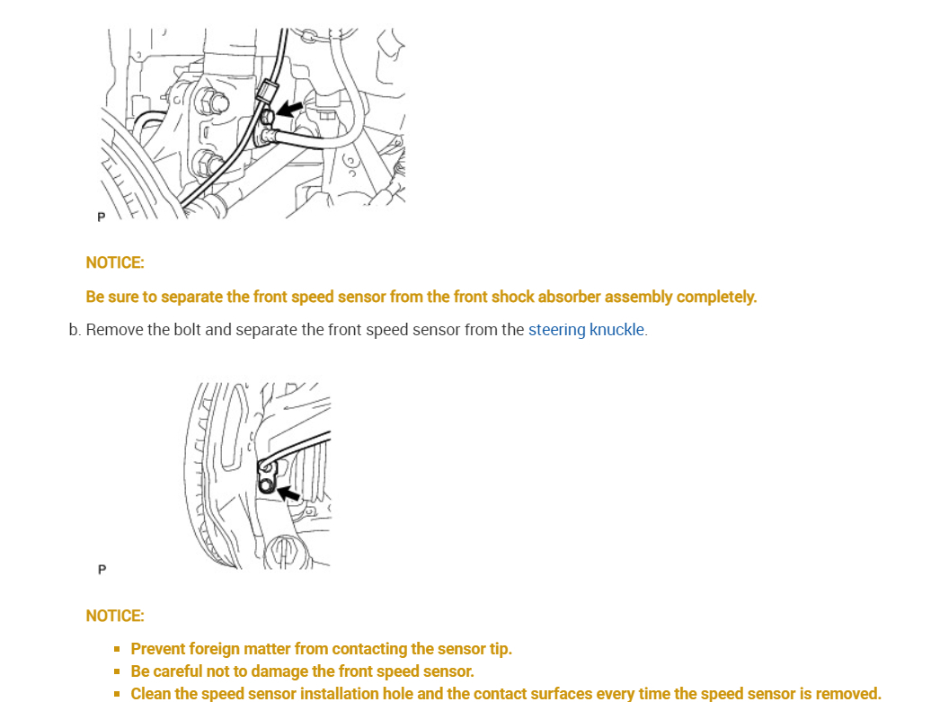

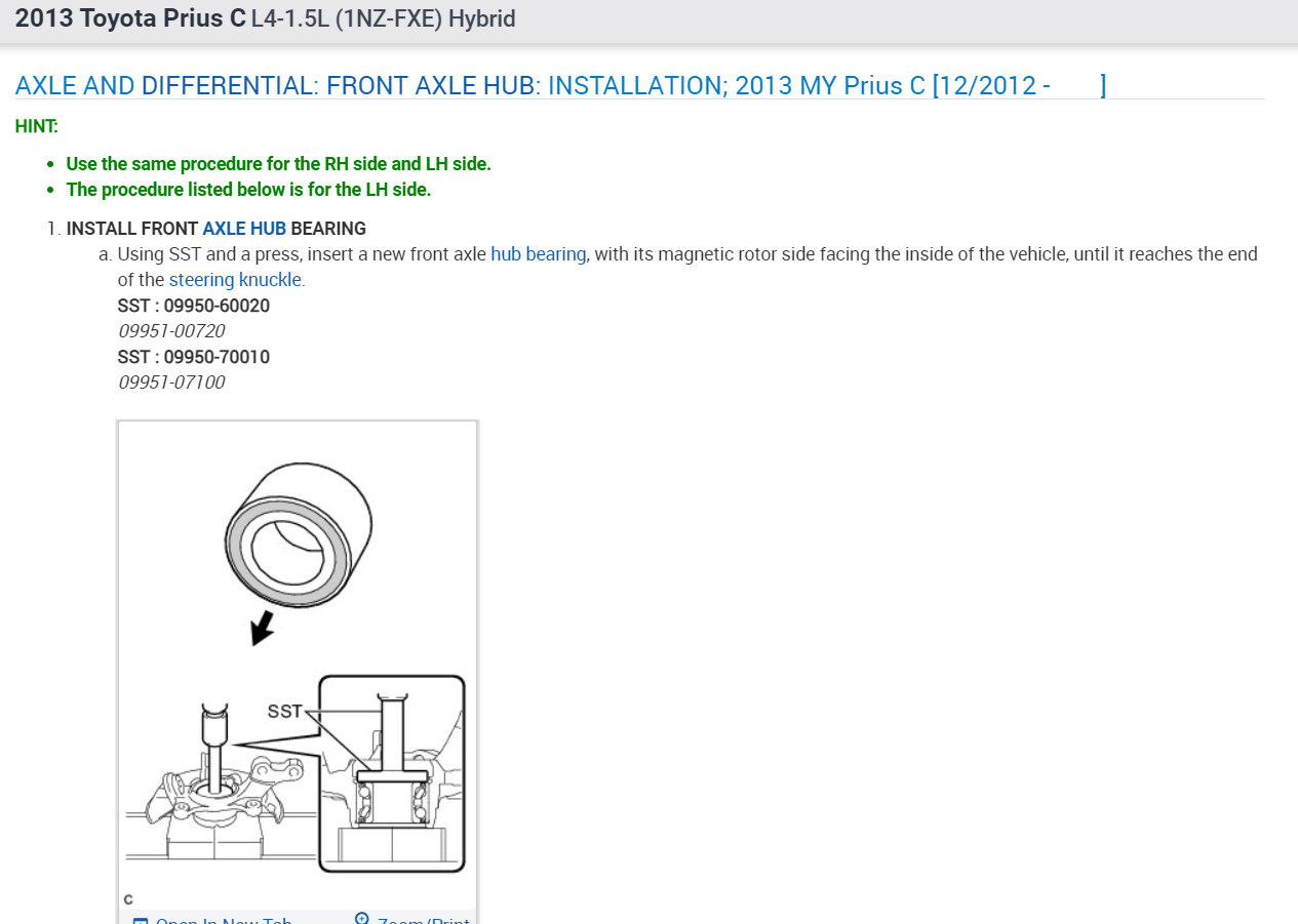

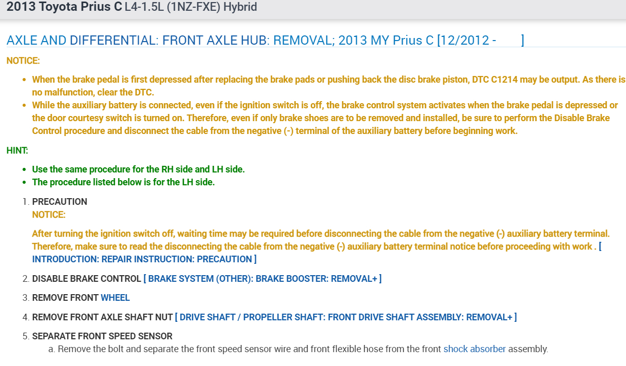

If you do not have an ABS warning light on, the system is operating correctly. The problem comes when the front or rear wheel bearing hub is starting to go out allowing the ABS wheel speed sensor to misalign with the reluctor wheel on the axle which makes the ABS system activate hence the feeling and sound on the brake pedal. Can I ask if the problem occurs more when in a turn? If so, this will be a bearing hub, most likely the front. I would raise the car up and grasp each wheel to check for endplay.
and
https://youtu.be/_FzmmBoa4Tg?si=4yxT3JuAgkR_EQSG

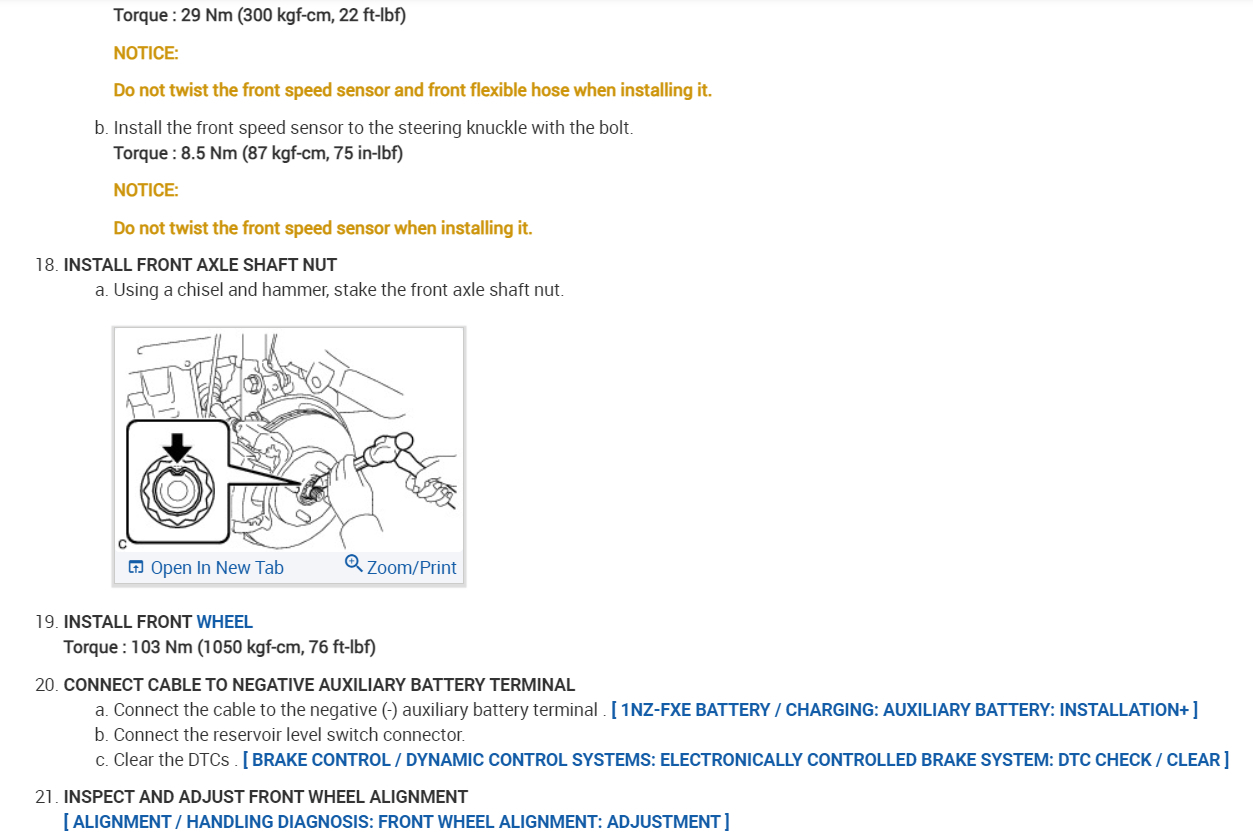

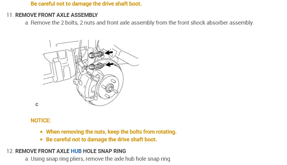

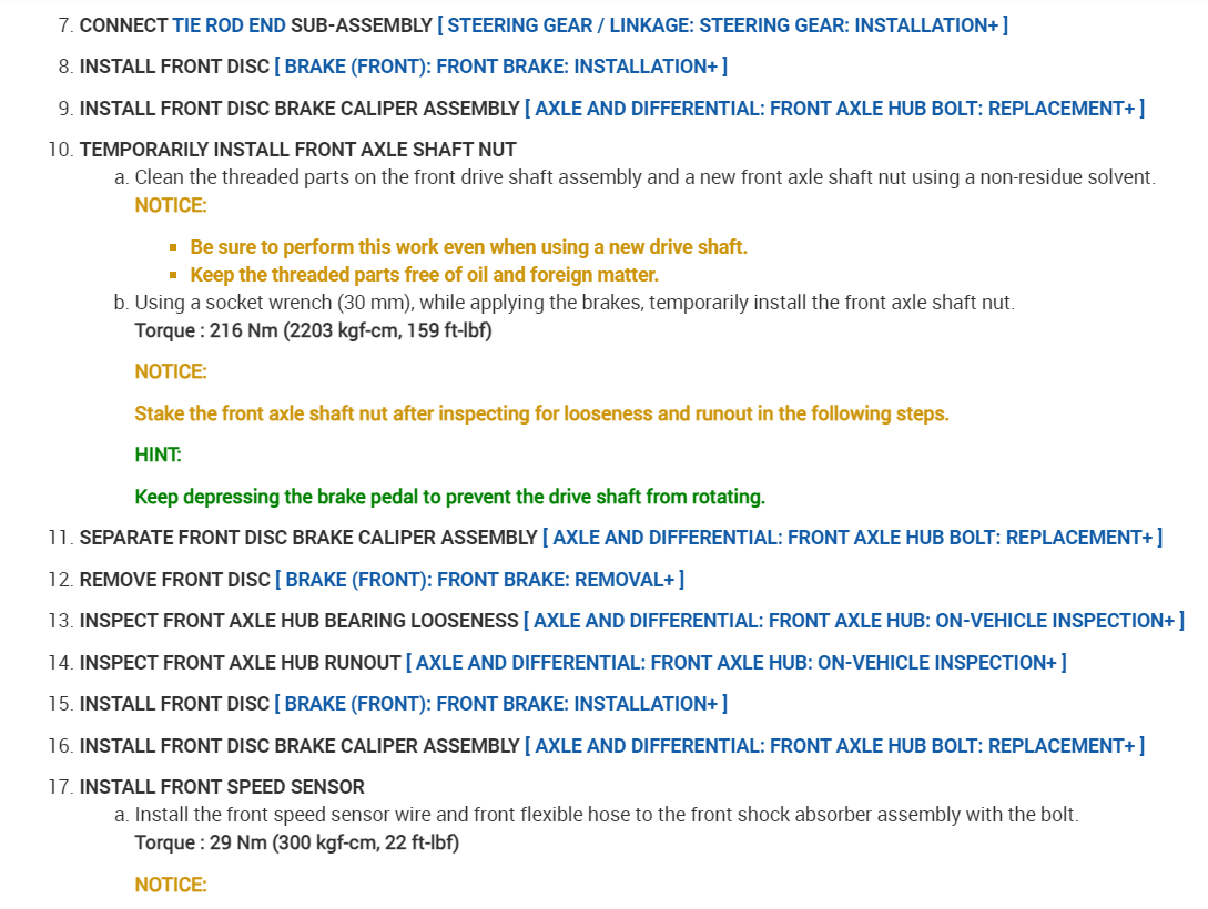

Here is how the front hubs are changed out. Check out the images below. Please upload pictures or videos of the problem so we can see what's going on.

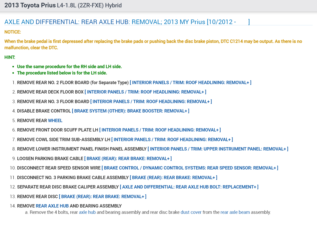

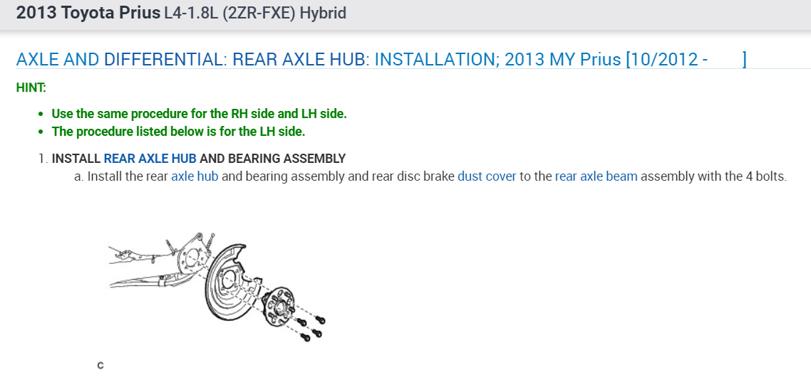

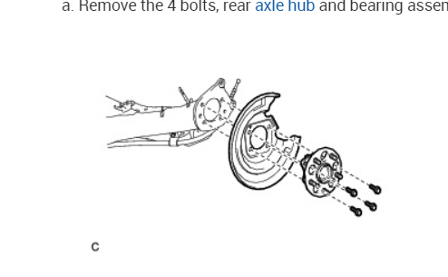

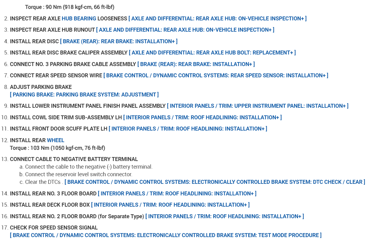

I am so sorry about your mom; my father too owned a gas station and that is where I got my start. It was 28 cents per gallon at self-serve unleaded. If you can hear a noise from the rear the bearing hub can be bad, here is what the shop will need to do it fix it. Can you please shoot a quick video with your phone so I can hear the noise? That way I can tell for sure what's going on. You can upload it here with your response. Check out the images (below). Let us know how it goes.
