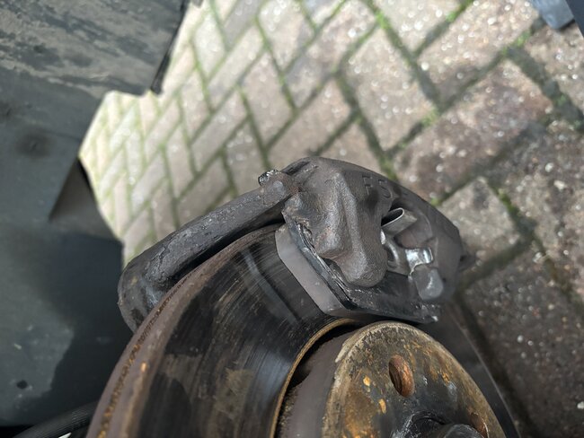

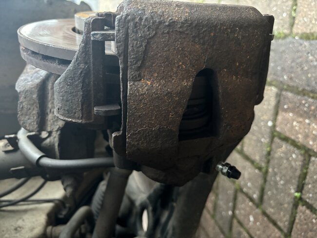

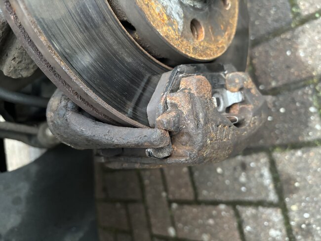

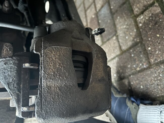

Yeah, I can hear air escape when I disconnect the pipe going to the booster and with the piston pushed back should I have a bit of movement in the Caliper to tell me the slides are okay I’ve had both the calipers off, and the slides come out fine.
Nov 5, 2024 at 8:00 AM
Thanks for the images, it looks like you have the calipers on the wrong side, the bleeder should be at the top.
