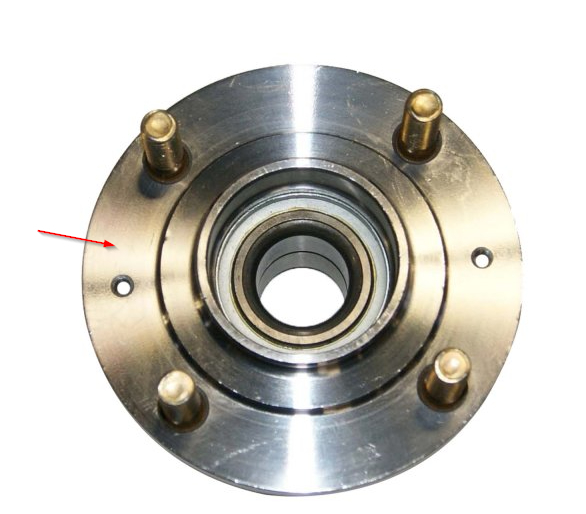

Does the noise go away when you press the brake pedal? If so, we need to measure runout on the hub face. The scraping noise that is not just a constant noise but sounds almost like a skipping record on a record player then that is because as the rotor turns the high spots make contact with the pads more and cause a noise.
We are going to need to access the hub and use a dial indicator. If the hubs do not have excessive runout then I suspect this is normal if it has always done it and never changed.
