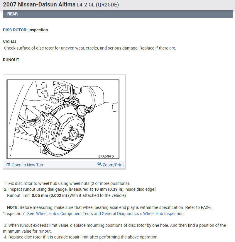

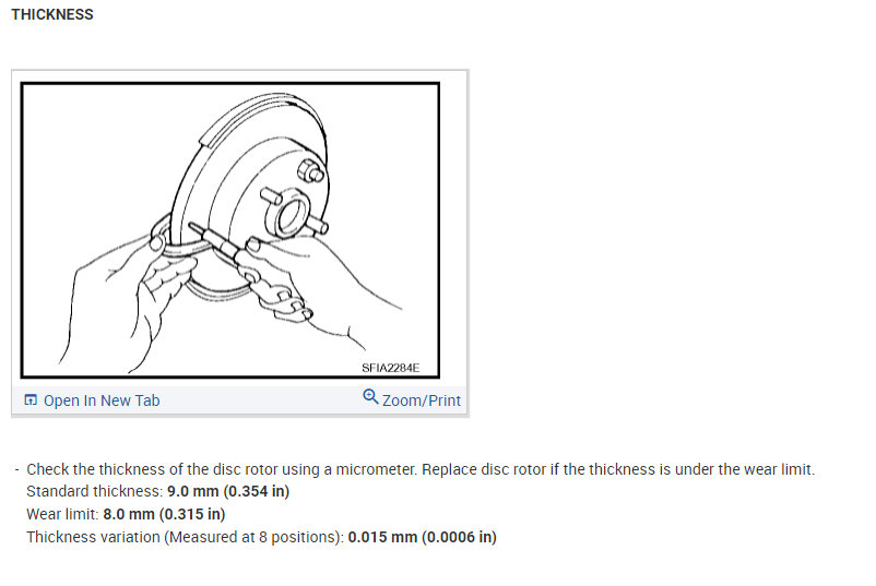

The best way to find out is the rotors are wrapped, is to do a runout test. In this test you will have to attached a gauge to the rotor and turn it. It will show if there is unevenness in the surface which might not be noticeable with a visual check. (see diagram below)
https://www.2carpros.com/articles/how-to-replace-rear-brake-pads-and-rotors
