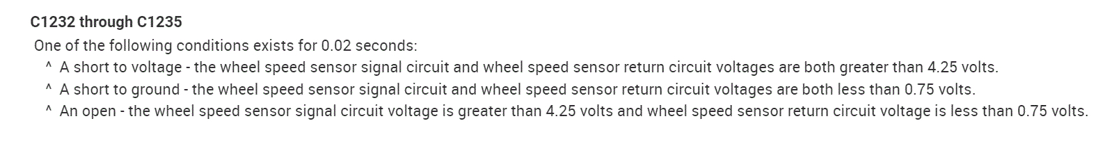

This is an interesting one. It appears to be related to the ABS/Traction control system. However, it can be caused by a wheel speed sensor. Not here is the interesting part. There is nothing that would apply brake pressure to two of the wheels when you release the pedal unless the module believes there is wheel spin. Take a look at the two definitions below.
P0318 is related to a communication issue with the EBCM (electronic brake control module).
C1232 See pic 1 below.
