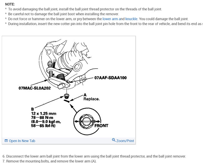

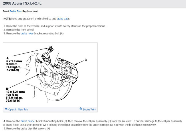

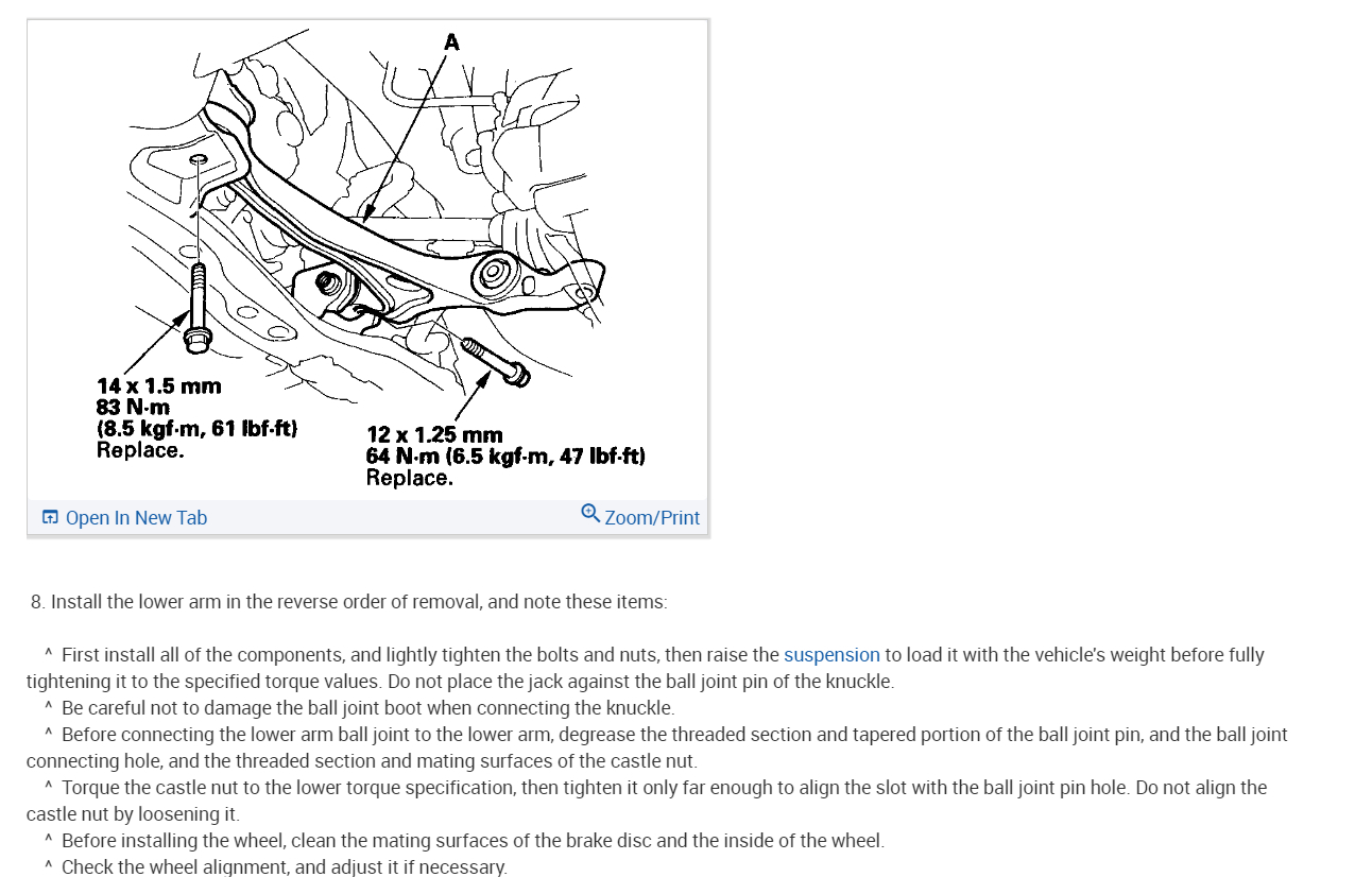

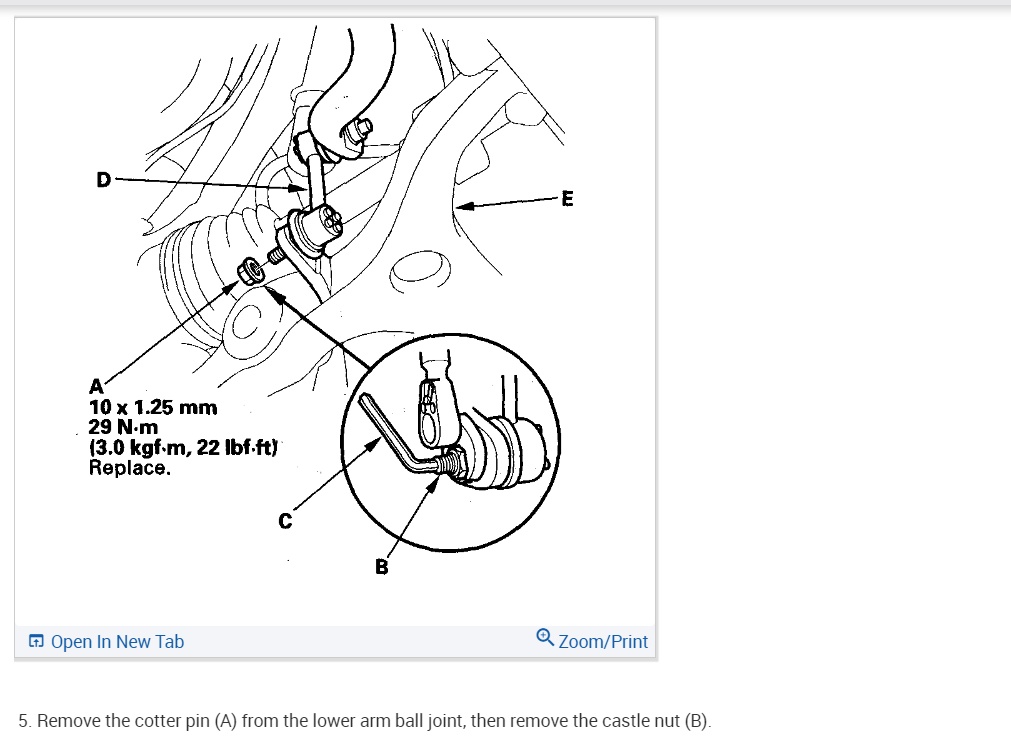

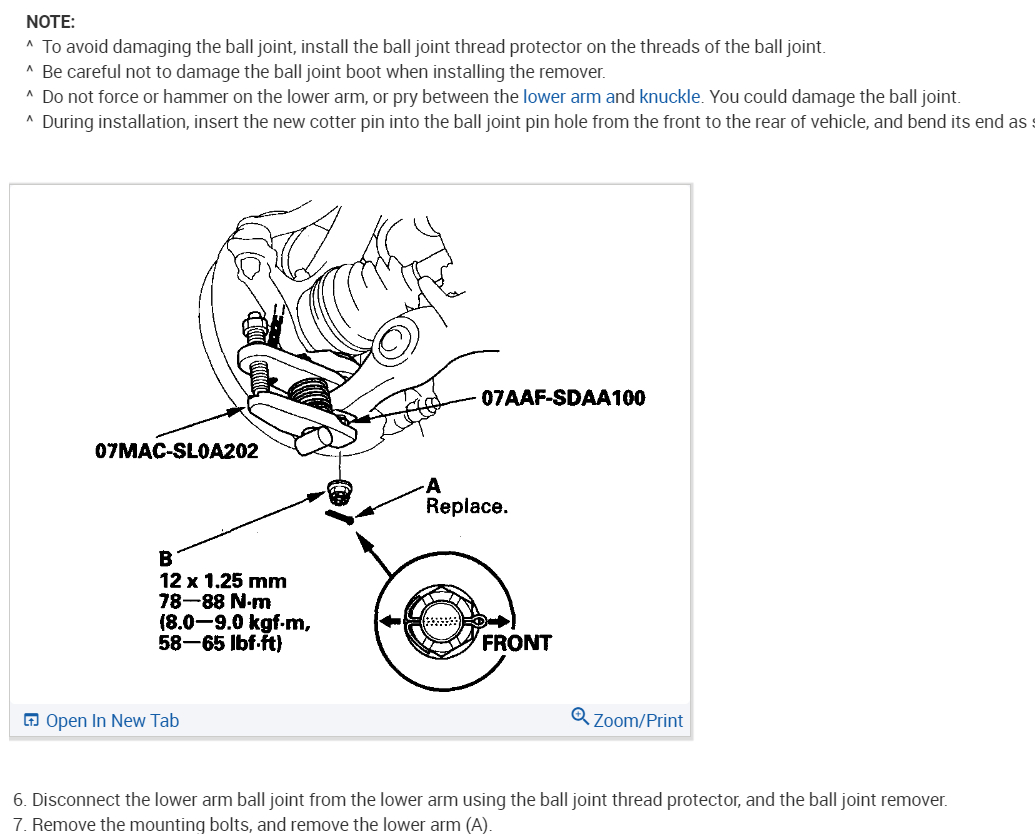

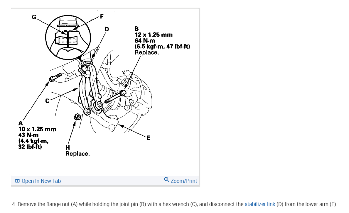

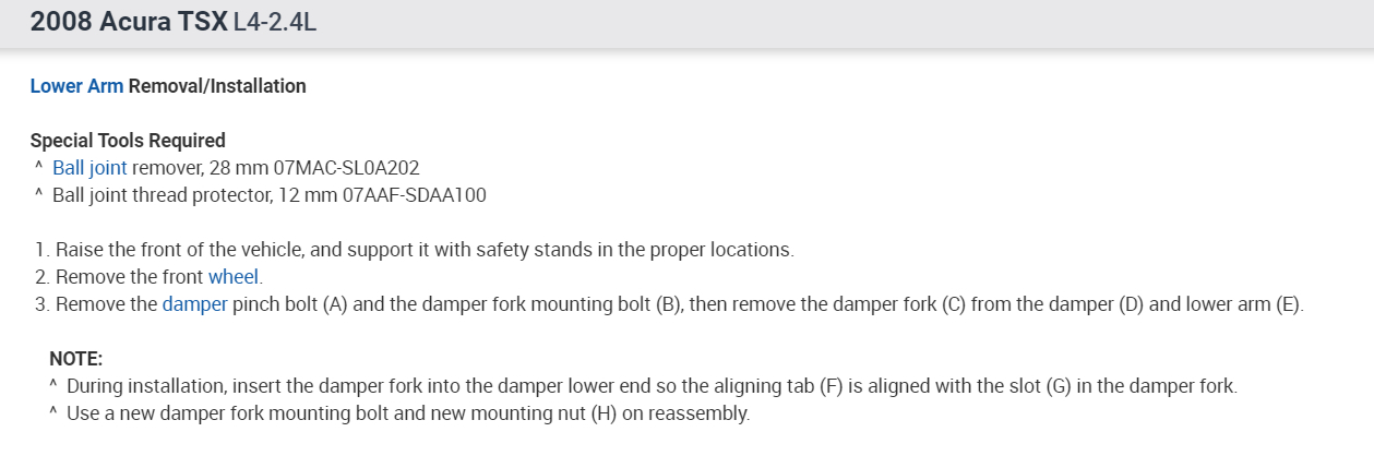

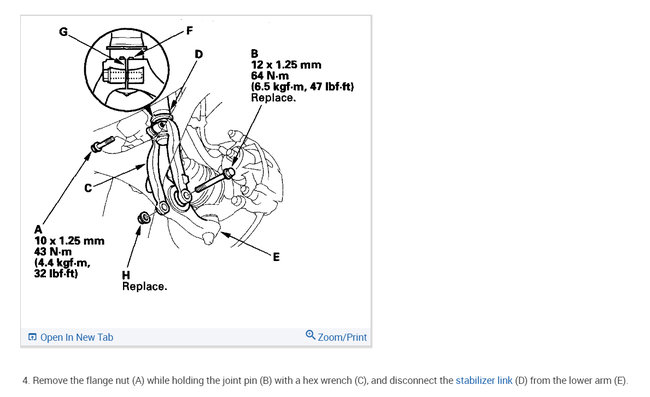

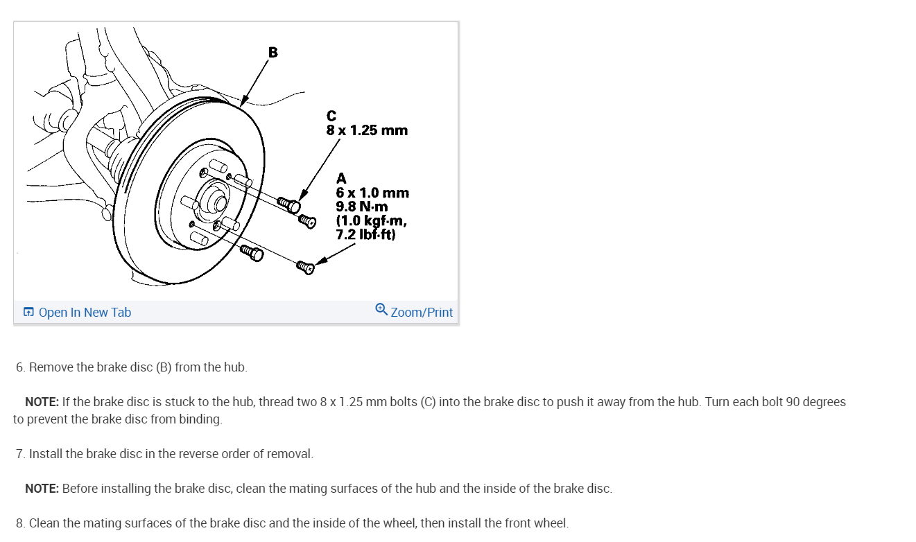

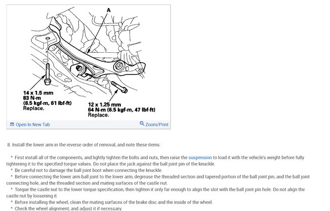

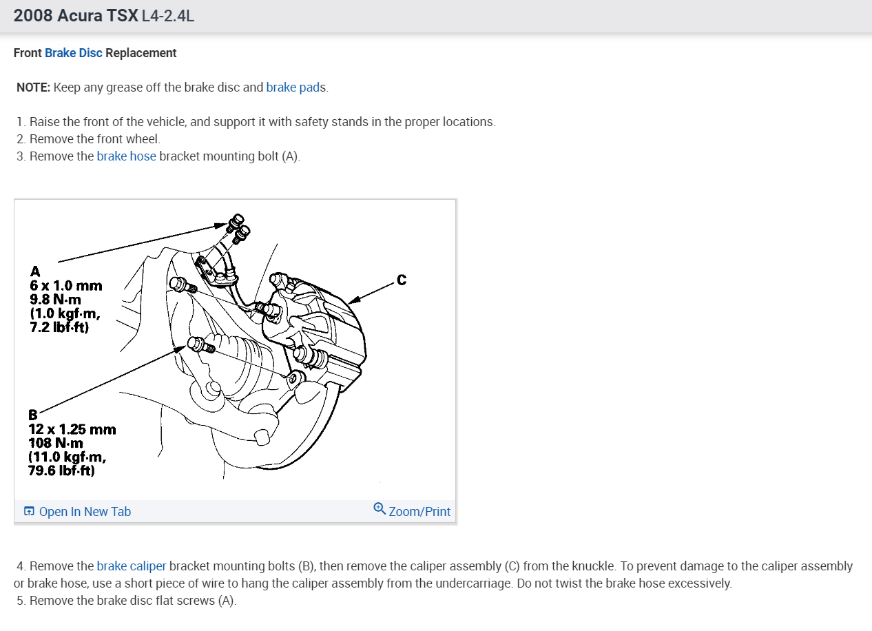

They must have rust or something under the rotor when they are installing it on the hub. There are only two things that cause this problem which is a bad rotor, the mounting is not correct, or you have worn lower ball joints. Also, they need to torque the wheel on, or it will cause the brake rotor to warp as well. Here is the correct way to replace the rotor in the images below. Also, here is how to change out the lower control arm and ball joint. I would do both sides.
You can get the parts from Amazon.
https://amzn.to/3QQesbr
and
https://amzn.to/3SfrMHf
Check out the images (below). Let us know what happens and please upload pictures or videos of the problem.
