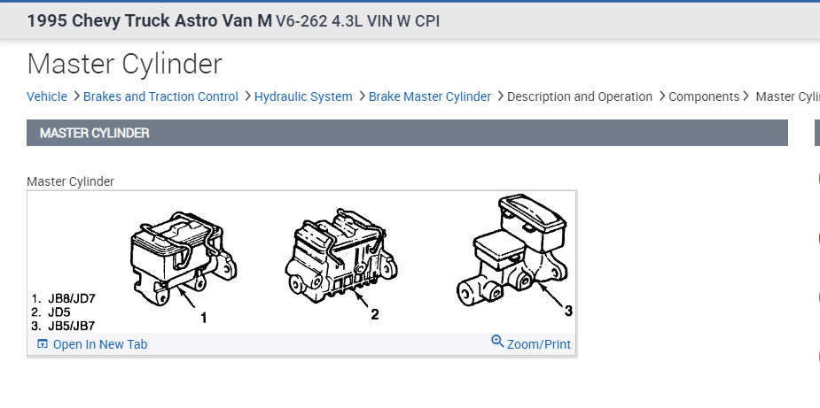

Let me know. Also, let me know which brake master cylinder you have. See pic below.
See pic below.
See pic below.
