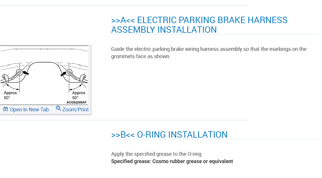

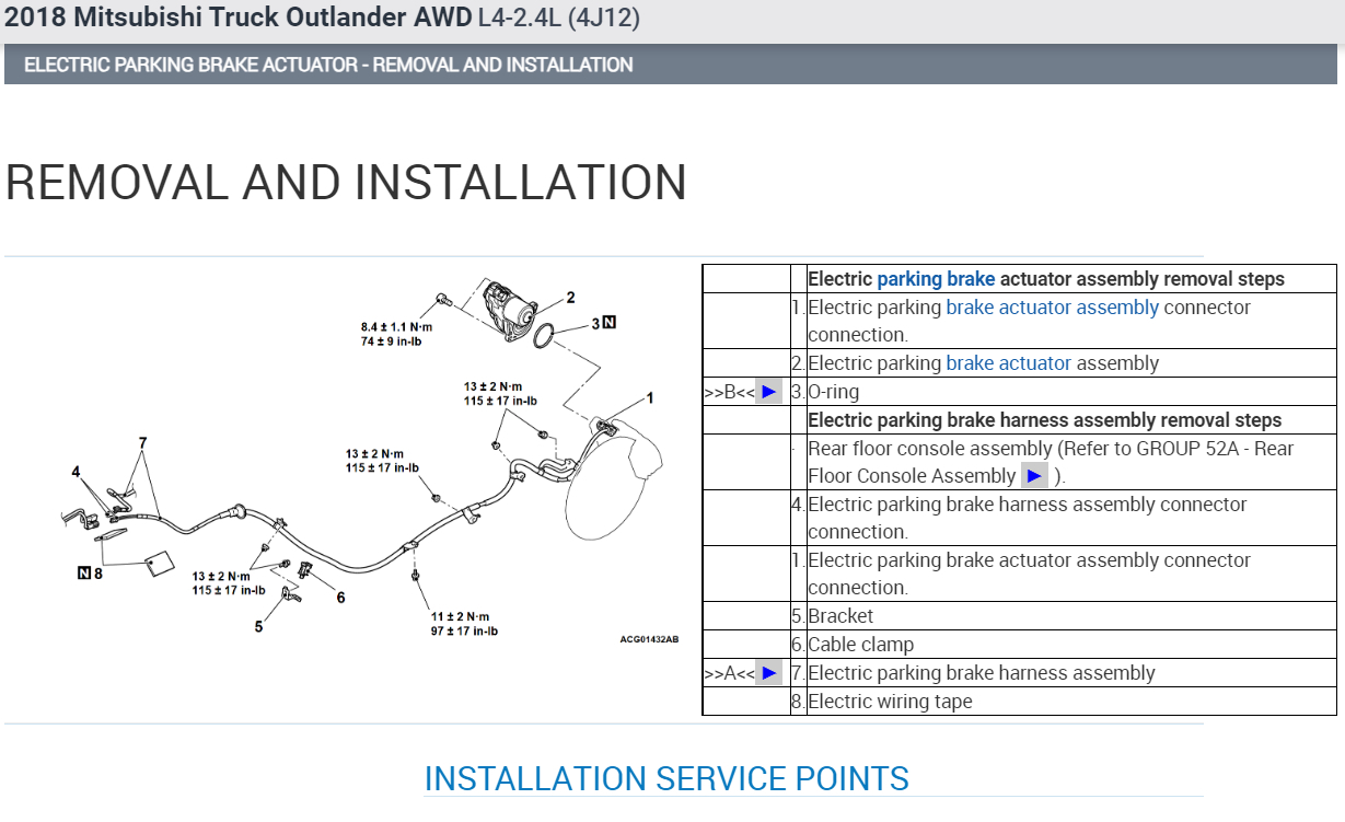

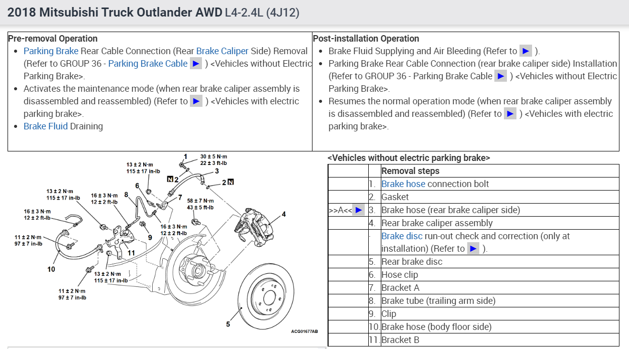

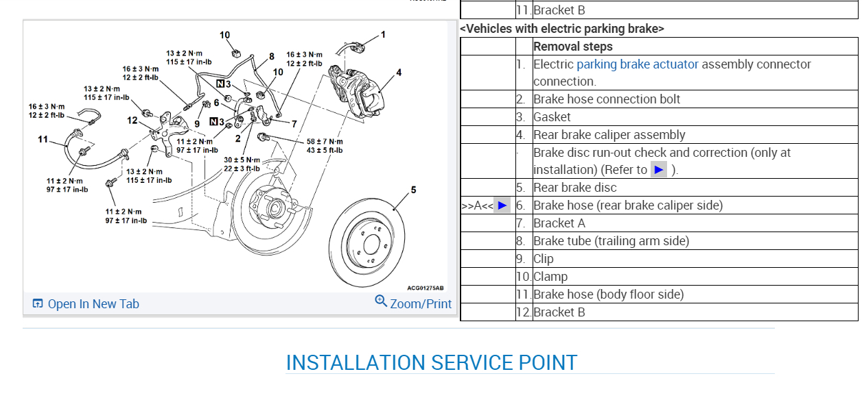

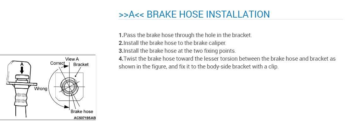

So, there is a procedure on replacing these brake parts, also I would check the caliper slides in the caliper mounting bracket, they should move smoothly. Check out the images (below). Let us know what happens and please upload pictures or videos of the problem so we can see what's going on.
