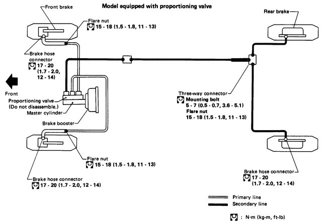

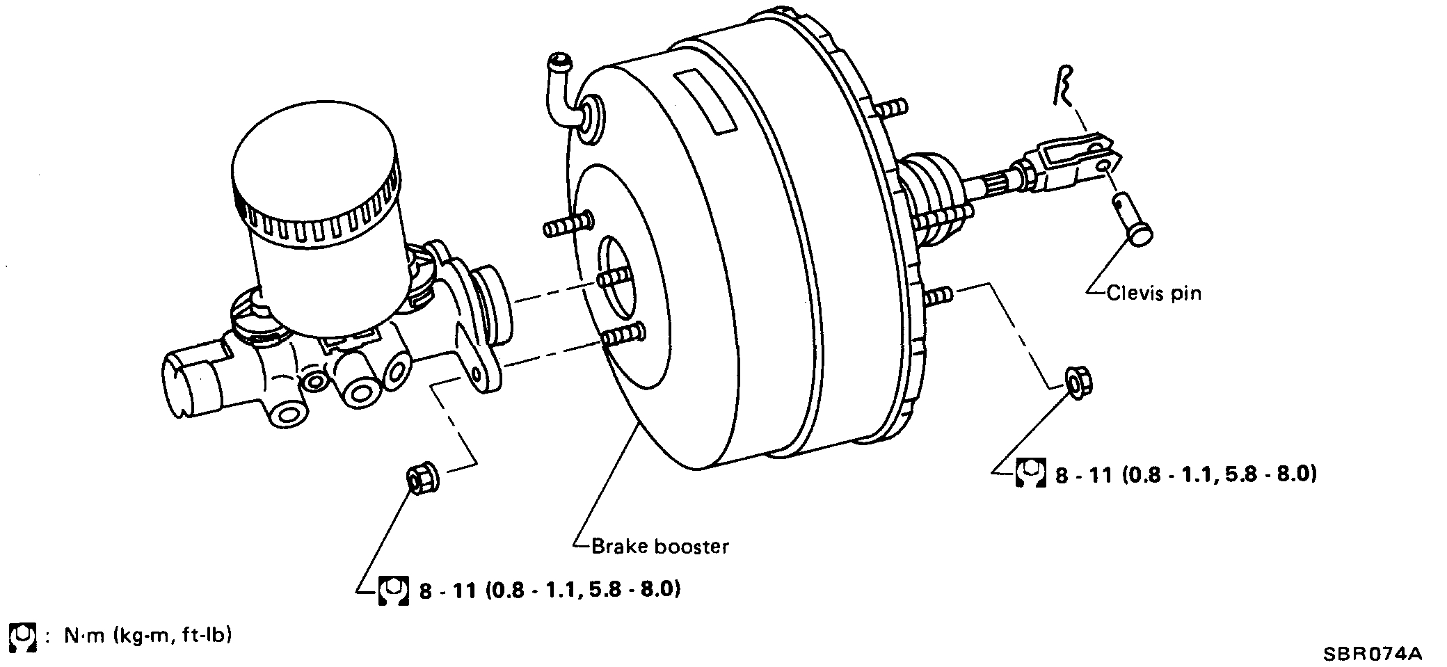

Here are the directions specific to your vehicle for replacement. The two attached pics correlate with the directions.
1990 Nissan-Datsun Truck D21 Hardbody 2WD L4-2389cc 2.4L SOHC MFI (KA24E)
Removal/Installation
Vehicle Brakes and Traction Control Hydraulic System Brake Master Cylinder Service and Repair Procedures Removal/Installation
REMOVAL/INSTALLATION
Brake Booster And Master Cylinder
pic 1
1. Connect a vinyl tube to the bleeder screws.
Brake Bleeding
pic 2
2. Depress brake pedal, open bleeder valves and drain fluid into suitable container. Repeat until master cylinder is empty.
3. Disconnect brake lines, remove master cylinder attaching nuts, then master cylinder.
4. Reverse procedure to install, bleed brakes.

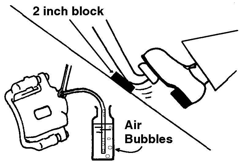

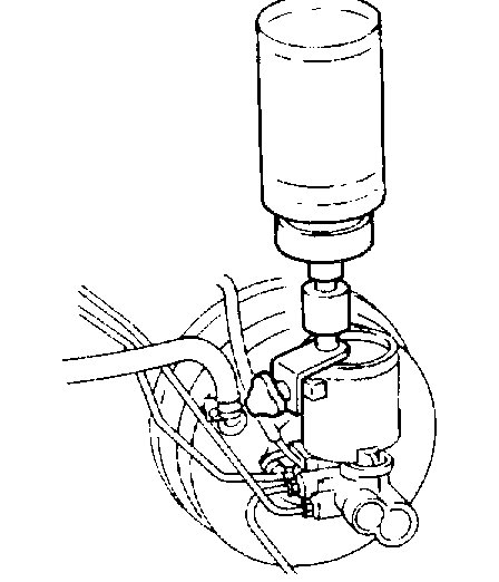

1. Have someone slowly pump the brake pedal several times, then apply steady pressure.
WARNING: Do not Full Stroke the brake pedal, this may damage the master-cylinder. Place a 2 inch block of wood under the brake pedal to prevent Full Stroking.

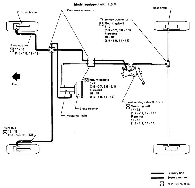

2. Loosen the brake bleed screw to allow air to escape from the system. Then tighten the bleed screw securely. Repeat this step until a steady stream of brake fluid is emitted.
NOTE: Do not release the brake pedal until the bleeder valve is fully shut.

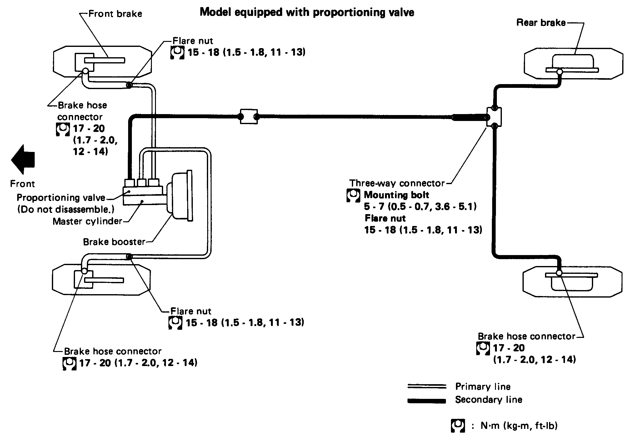

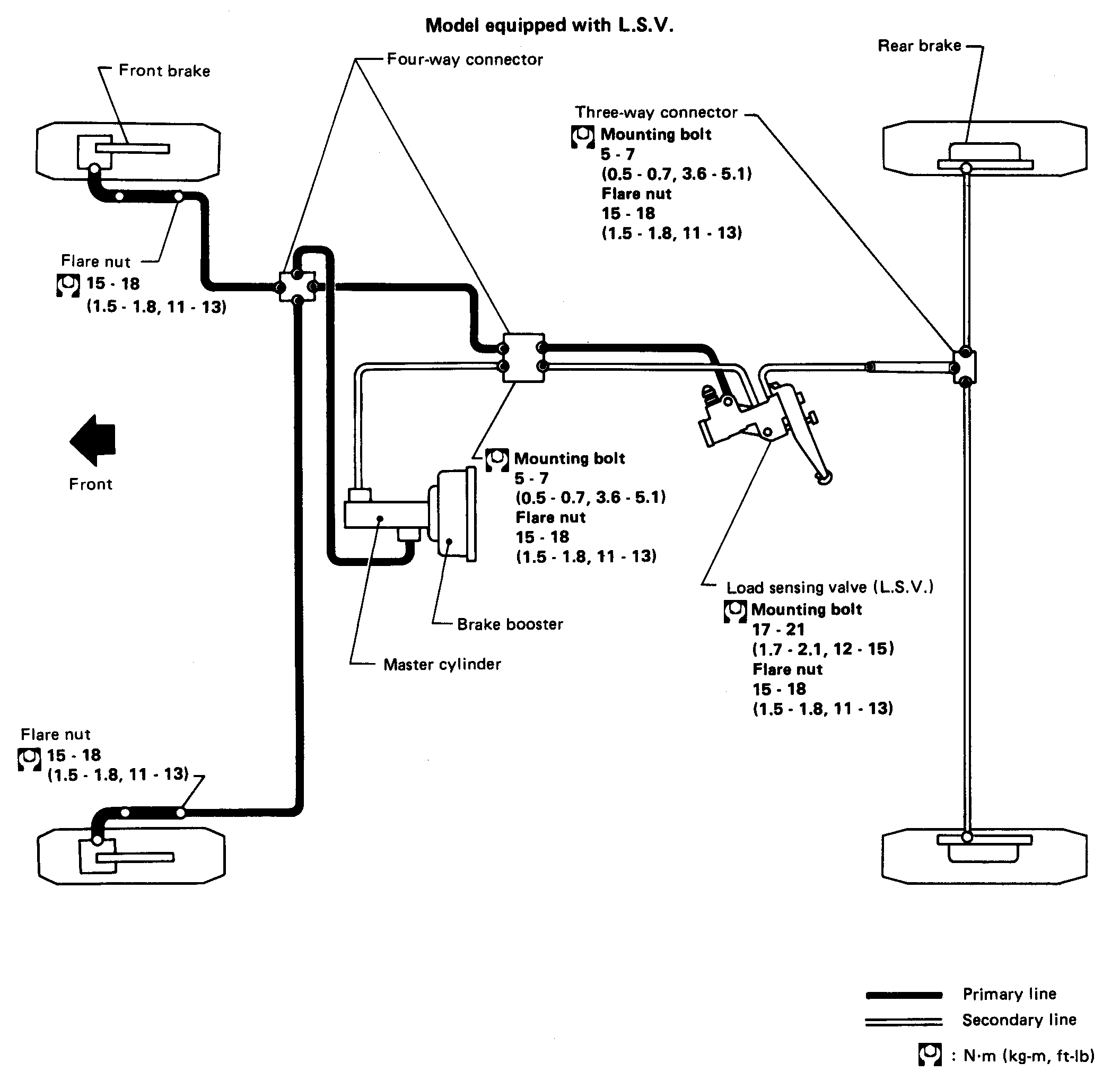

3. Repeat the procedure for each wheel in the sequence shown below.
pic 5
pic 6
WITH L.S.V. AND PROPORTIONING VALVE
Brake Bleeding Sequence
1. Load Sensing Valve air bleeder (LSV) if equipped.
2. Left rear.
3. Right rear.
4. Left front.
5. Right front.
WARNING: Do not bleed the brakes with the drums removed. The wheel cylinders will over-extend and eject the pistons.
