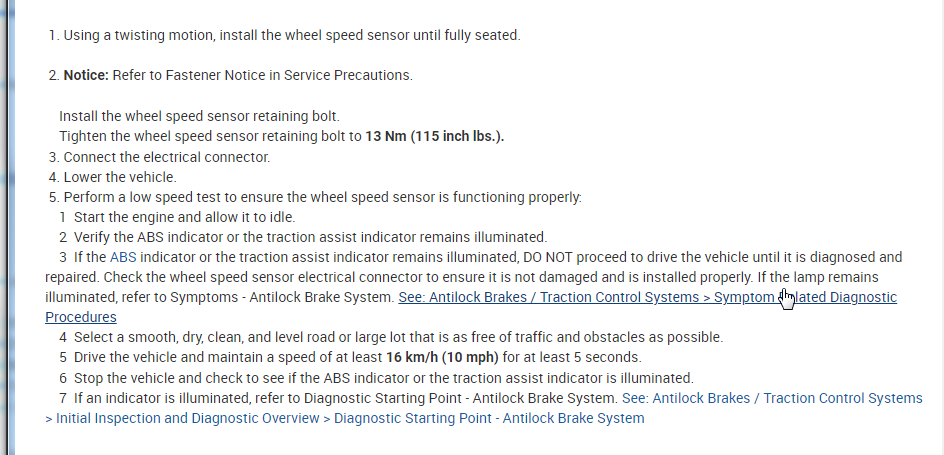

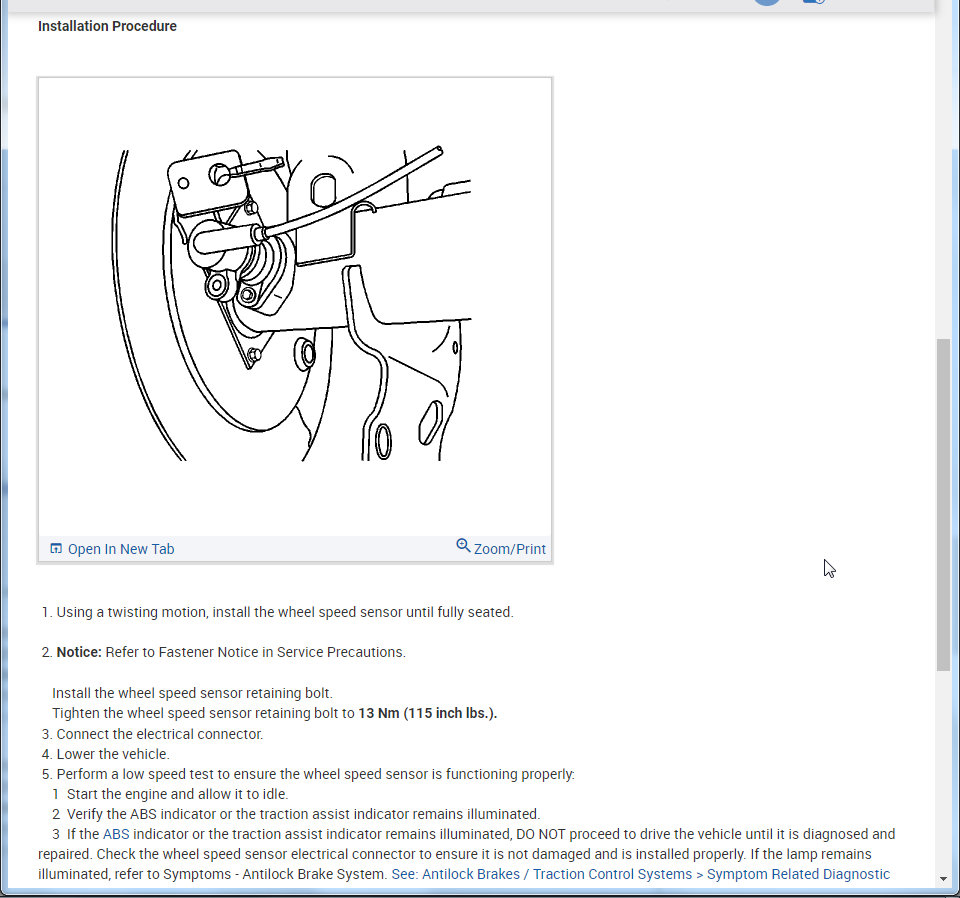

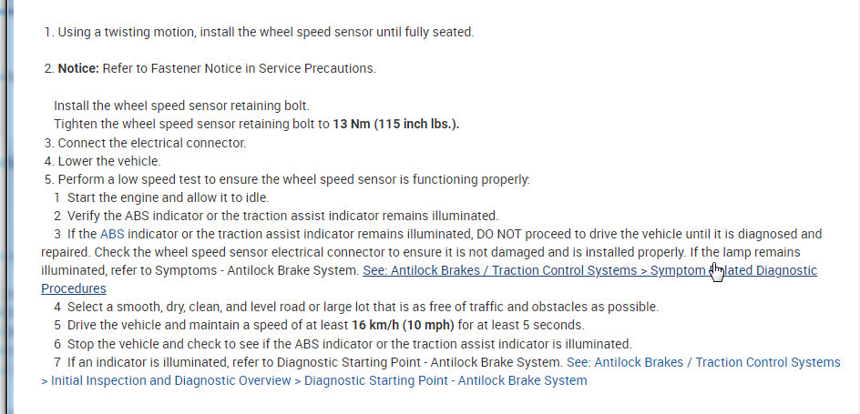

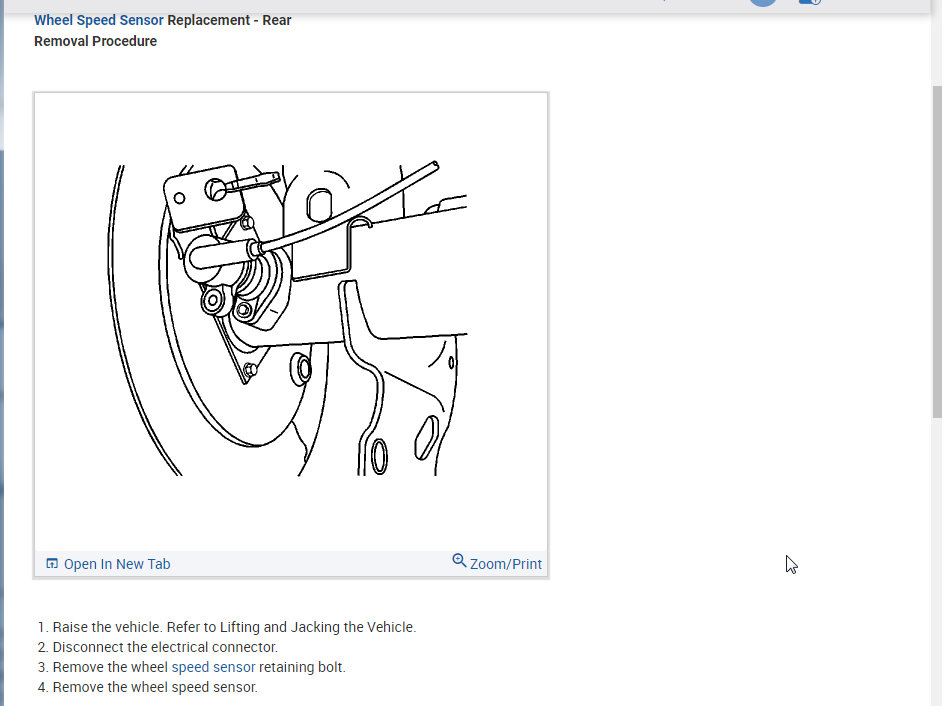

Below you will find the process from the manual on how to replace this as well.
