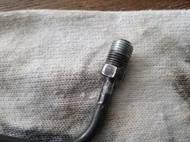

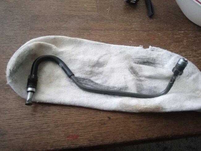

I replaced both wheel cylinders and one hard tube brake line because it was leaking from the fitting going to the right wheel cylinder. I got the line from Toyota.
now when I put the tip of my finger on the fitting threads of the new brake line going to the wheel cylinder, I see some brake fluid but no dripping. What causes the issue? this is the old line
Jun 4, 2025 at 11:24 AM

its weeping from the fitting going to the wheel cylinder which is part of rear shoe brakes. not from the master cylinder.
