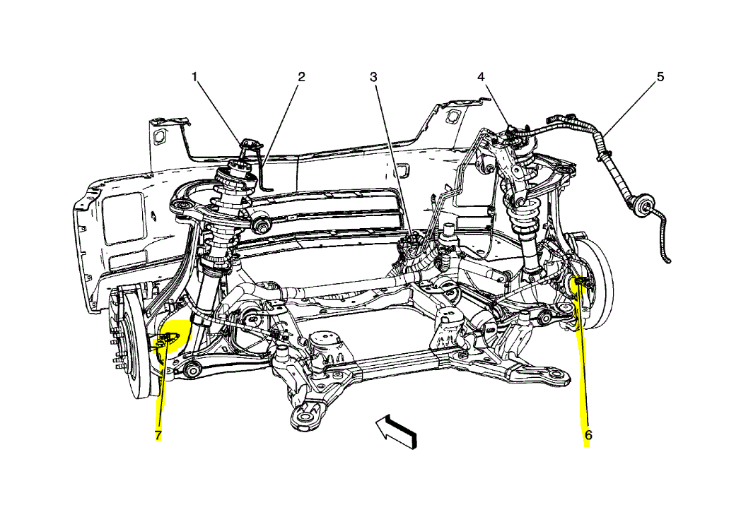

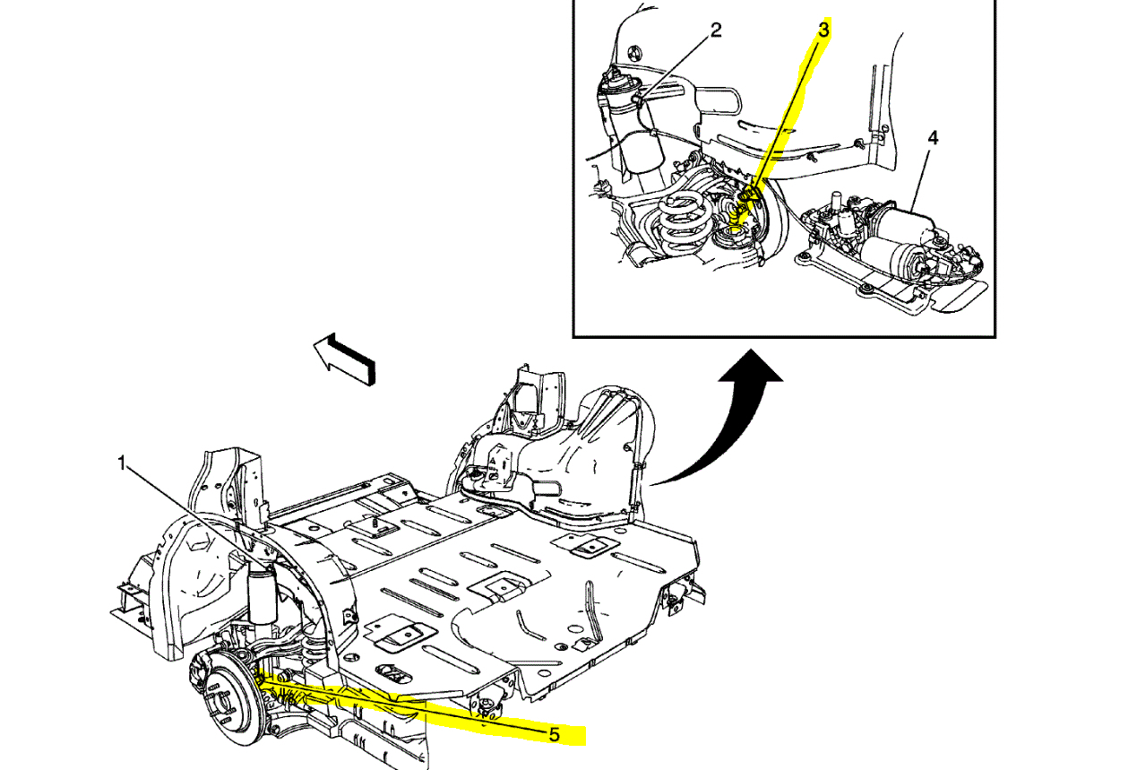

I attached two pics below. The first shows the front wheels and the second shows the rear wheels. I highlighted the sensors to help you locate them.
At first, just make sure nothing was left disconnected or loose. Also, make sure the wiring to them hasn't been damaged.
Let me know what you find. Also, please feel free to let me know if you have other questions.
