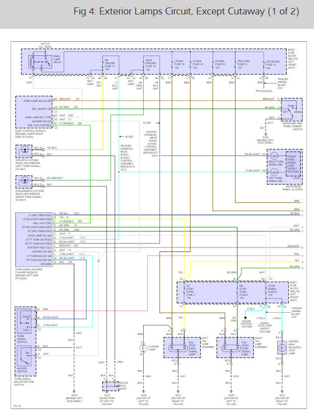

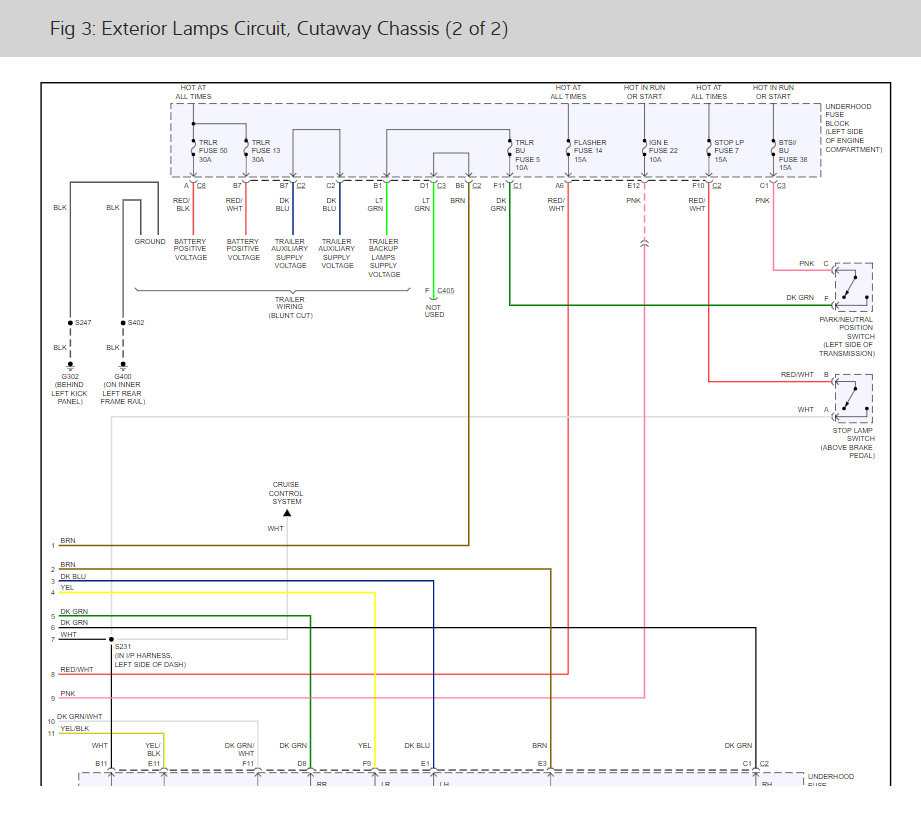

My left rear brake and turn signal not working. I check all the bulbs. Checked every fuse Left signal flashes fast . Test light flashes fast when I touch in the fuse block. Right flashes normal.
May 5, 2018 at 1:12 AM
It sounds like you have lost power or ground. I would start by checking the fuses because there are several that run the system.
Check this guide as well.
https://www.2carpros.com/articles/no-tail-lights-exterior-running-lights-tail-lights-out

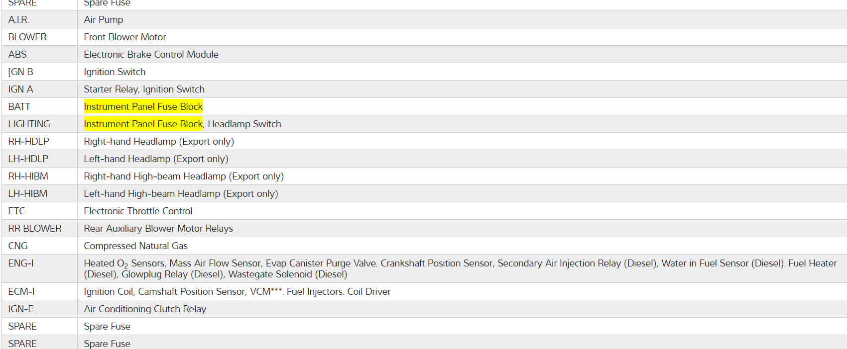

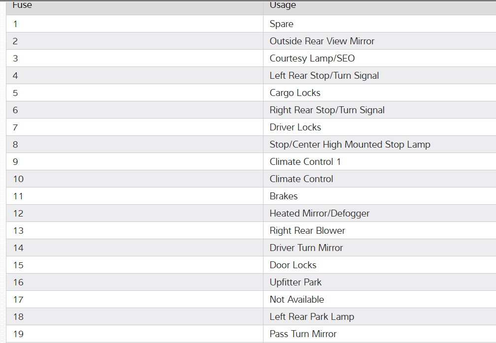

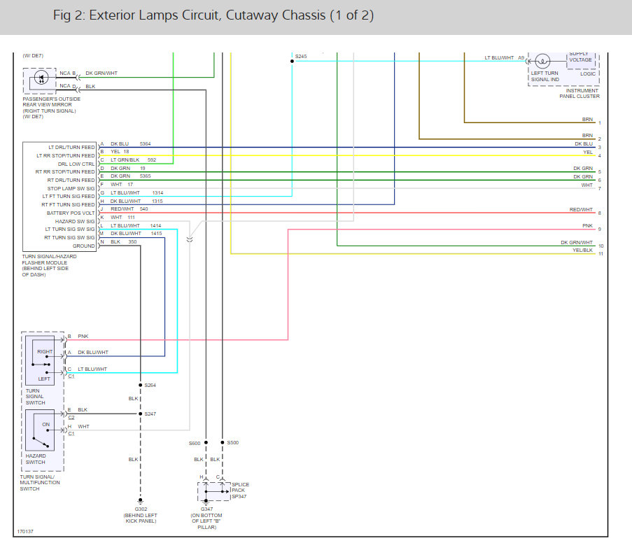

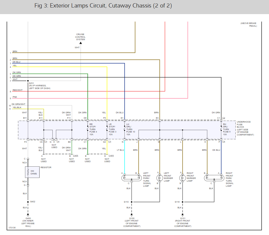

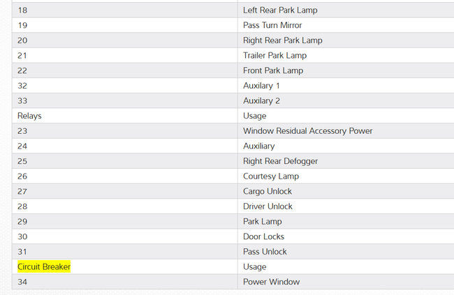

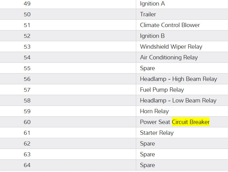

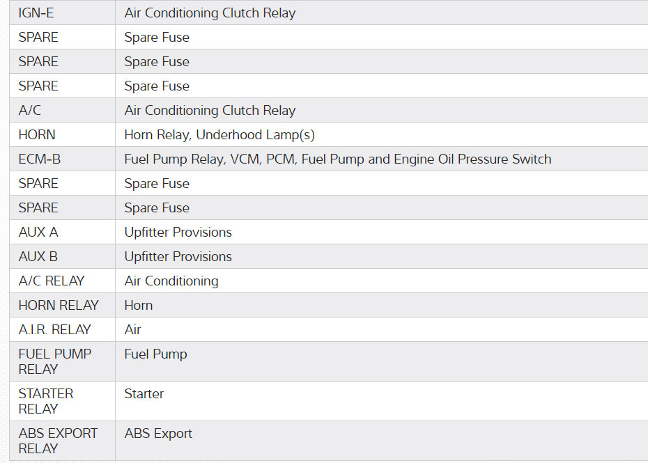

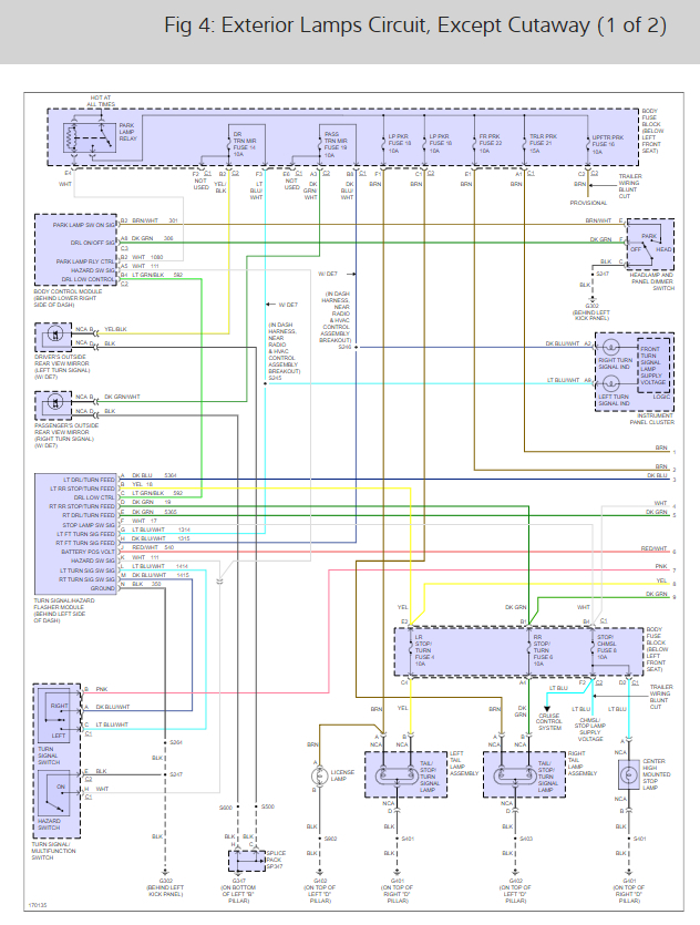

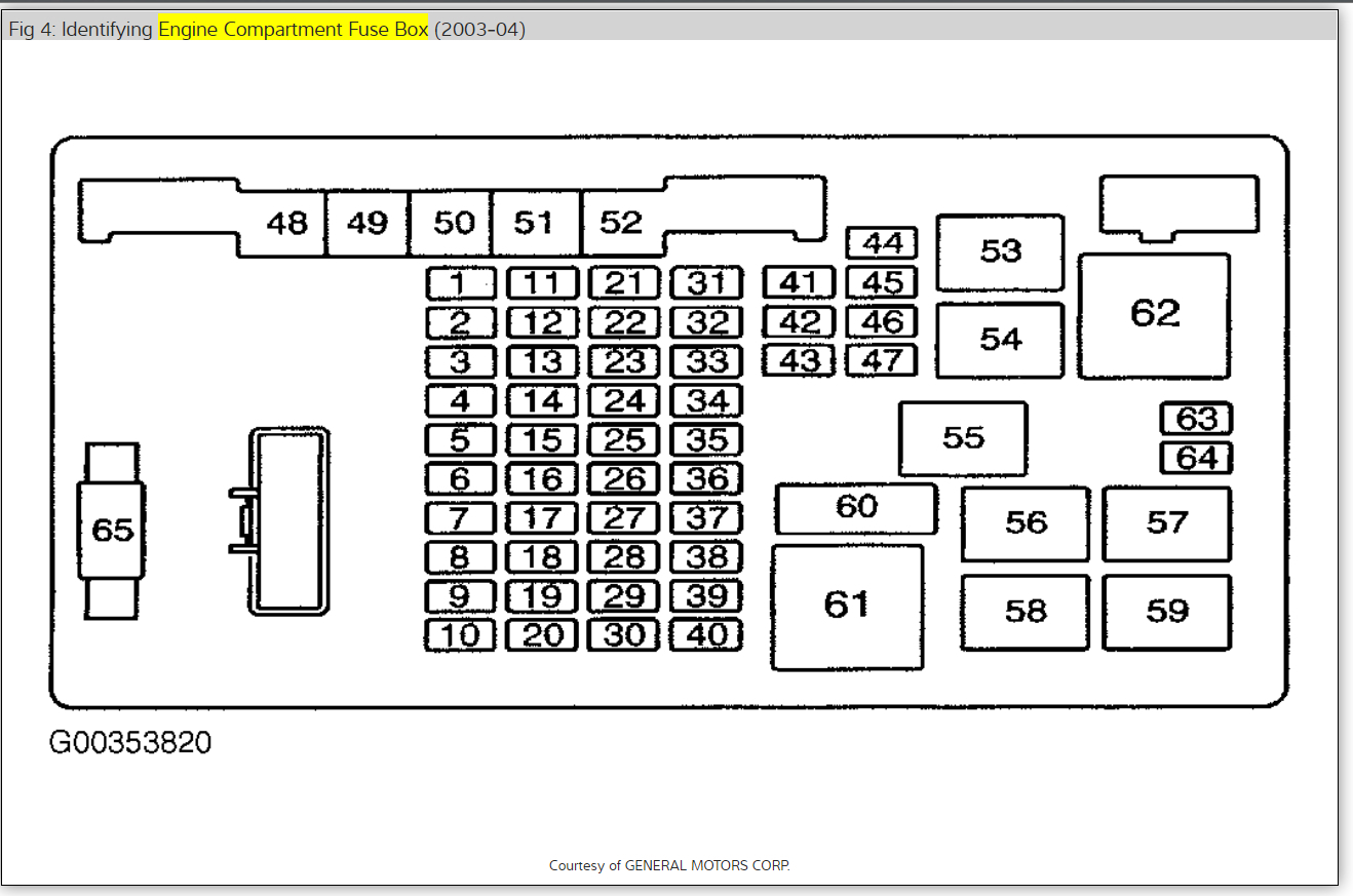

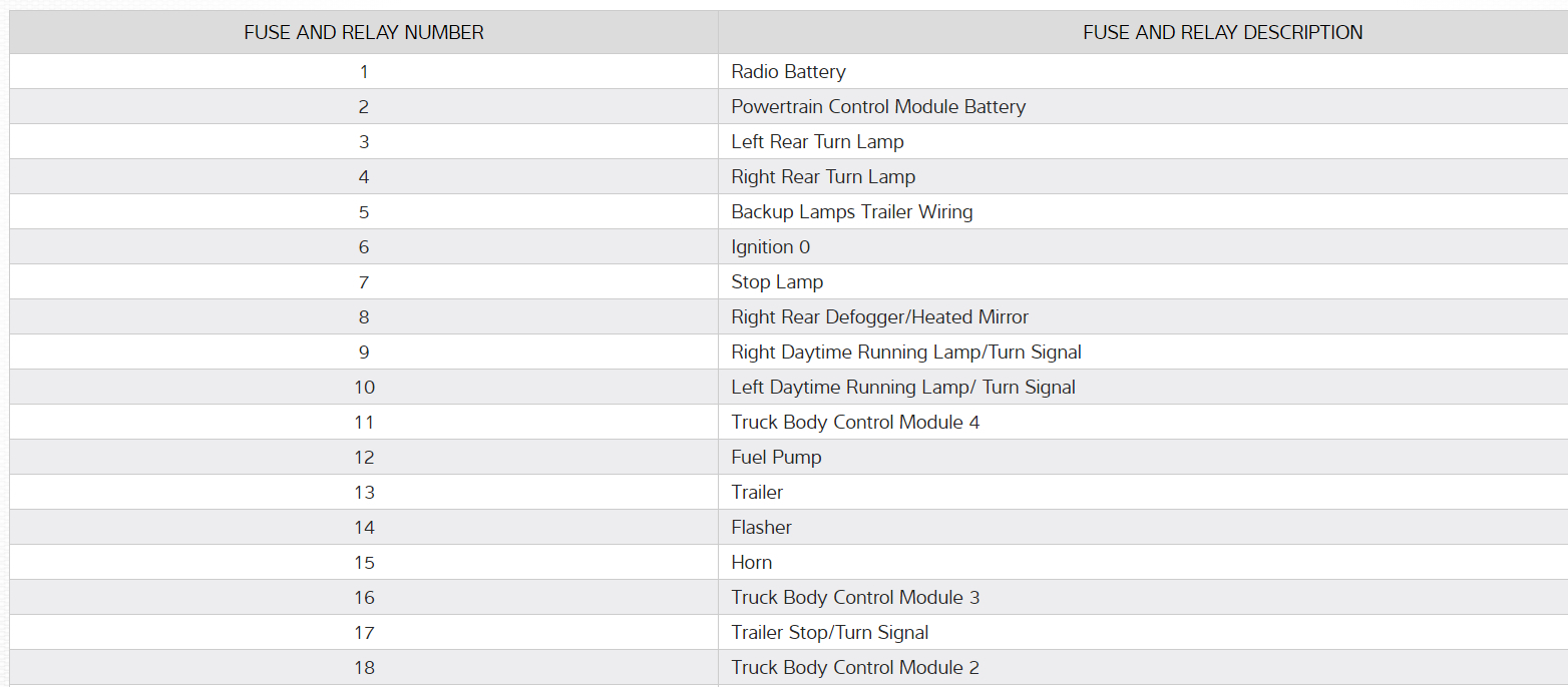

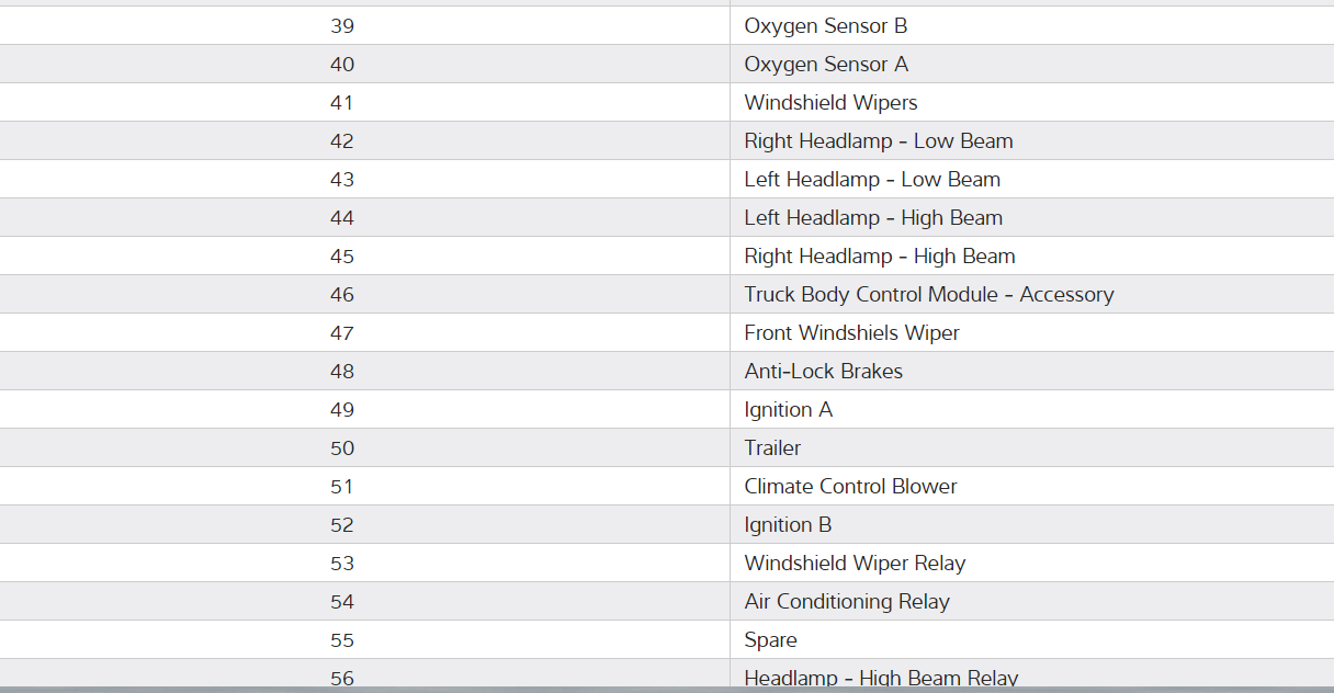

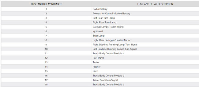

Here is the fuse locations and the brake light wiring diagrams so you can see how the system works.
May 6, 2018 at 5:15 PM
FRUSTRATED CHEVY
Thanks Ken.
I checked every fuse - okay.
I checked the bulbs- okay.
I check ground at the rear light - okay.
(I used a test light from a known power source or in this case the taillight wire to the ground and it worked)
I searched for diagrams to try and determine where power originated and where it ends in relation to the flasher relay, BCM, fuse block, that I was unsuccessful. I did locate what wire came out of flasher relay, yellow wire.
I exposed the copper wire and ran a new wire from that point to the left rear brake/turn bulb as a test and another ground wire at the rear and turn signal/brake light worked correctly. So I cut the wire at the flasher relay and and ran the new wire to the rear location. At this point all lights are working correctly. Now that I have your post and these images I will look to see if by doing what I did I have bypassed anything.

It sounds like you fixed it like you say double check to make sure you did not miss anything. Good job running the new wire, the old wire must have a short.

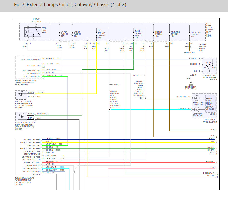

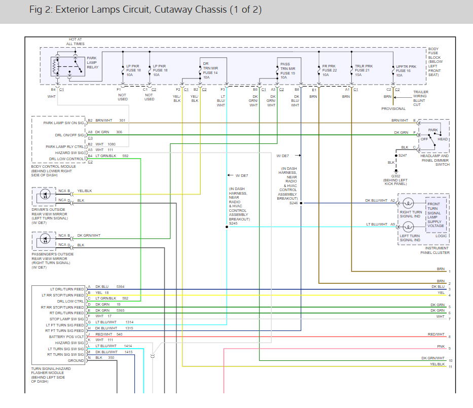

Not sure if it is okay, to hijack someone else's question but I am having a similar issue. left rear turn and brake not working. so far I have checked bulb, ground etc at bulb, fuses (under seat as well as under hood) - no signal getting to fuse-box under seat, thought it could only be the flasher module, so bought a new one. same problem with the new one. isolated the wires coming out of the module, when I touch a tan wire with my test light the flasher relay starts clicking at normal speed but the light in my test light does not flash. frankly this is where I hit the wall. what could possibly be causing this to happen? if I thought that cutting the wire and running a new wire back there would work I am ready to do that, but I am hesitant to cut a wire, have it still not work and then have to deal with a cut wire and still no turn signal.
Nov 9, 2019 at 7:08 AM
Yes lets continue this problem until we fix it. It sounds like a bad ground to me lets make sure by checking the connections. here is a guide to help and the updated wiring diagrams so you can see how the system works and which grounds to check. (behind kick panel I would check first.)
