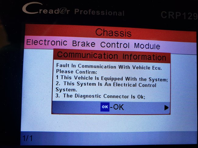

Car has been sitting for a few months, pulled into garage to fix a few items to try and sell. Took for a test drive and Red Brake, Anti-Lock, And ABS lights turned on.
The brake light will sometimes go out then come back on but the other two flash randomly together with no certain pattern like a loose wire. Hooked a Creader scanner to it and it says not able to connect to ECU and check reader connection. It does read other items like engine coolant, RPMs, throttle position etc... Just seems to not read that one area.

By chance, have you checked the brake fluid level? Don't laugh, but that can cause the lights you are referring to.
Also, are you able to connect the PCM with the scanner or is there no power to it? Does pin 16 have power to it at the DLC?

Brake fluid was slightly low just below the max line. Pin 16 had 12.4 volts.
Scanner reads other parameters, just not the area that deals with the BCM.

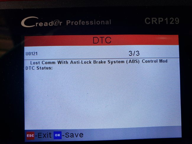

I have found the issue. This is my daughter's car, and she recently had the transmission replaced with a used one. While surfing the web for the U0121 code I found an article which talked about the plug on the transmission being loose or not fully seated, found the plug, removed and plugged back in, code gone dash lights out. While driving and hitting a hole lights came back on, stopped and wiggled plug and lights go out. So now I'll pull and clean but is there something else you could suggest while I'm in there?

The code certainly helps. I'm glad to know you found the issue. However, is it the connector that is bad or a clipping issue? You don't want it to fall out every time you hit a bump.
Let me know so I can try to help.

The plug does lock, removed and sprayed down with contact cleaner. Plugged it back in but if it gets bumped it sets the codes.

Inspect the pins inside the connector to make sure nothing is pushed back in causing a weak connection.
