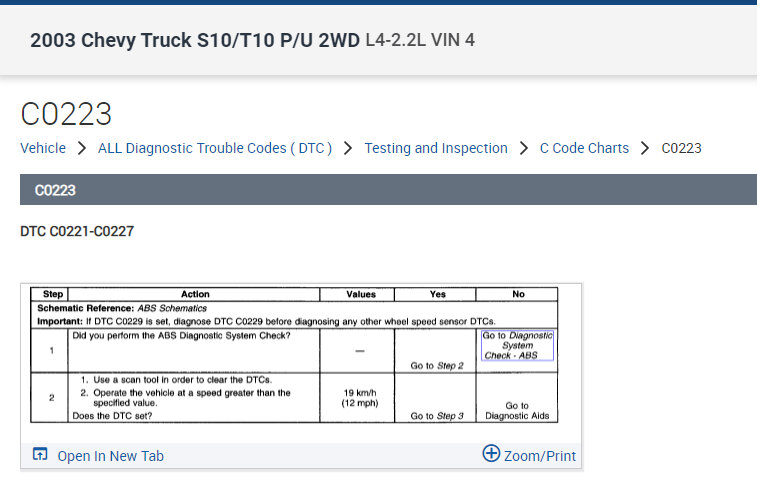

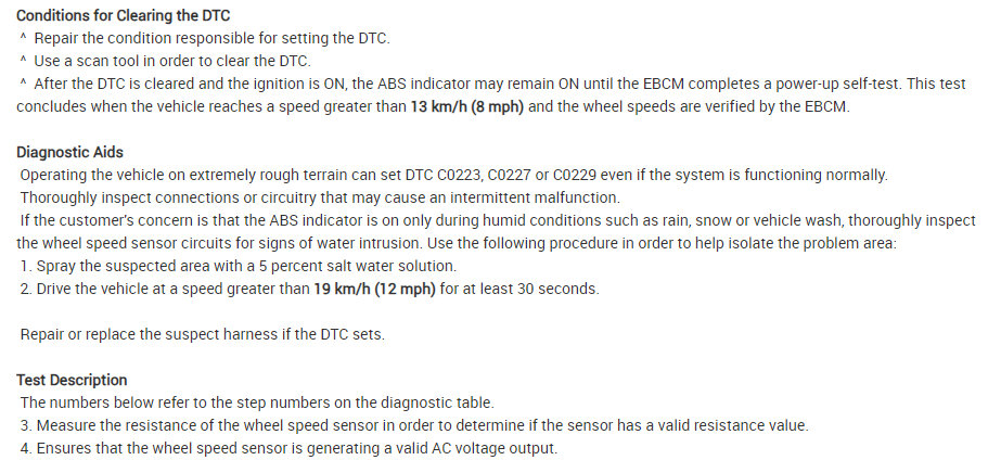

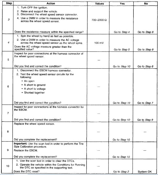

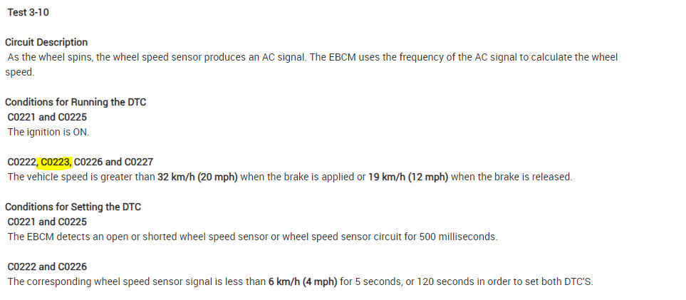

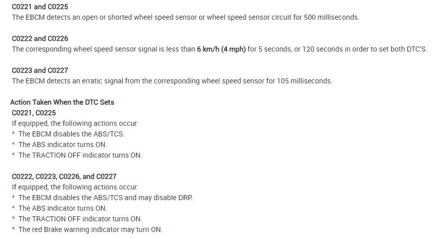

I went to AutoZone and their code reader says I have CO223 and CO223. Right front wheel speed signal erratic and left front wheel speed signal erratic. At times I would get the ABS light in the dash. I ran new brake fluid through both back wheels which cleared it and still want to do both front wheels. I'm not sure if this helped but it did get rid of the ABS light.
I have a Hayes Repair Manual and there is now code in the code section for that.
