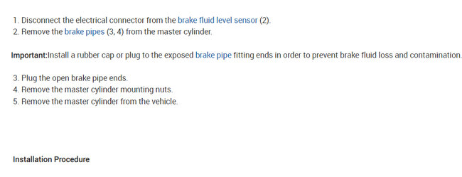

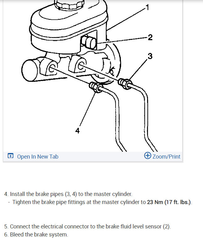

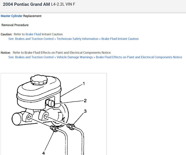

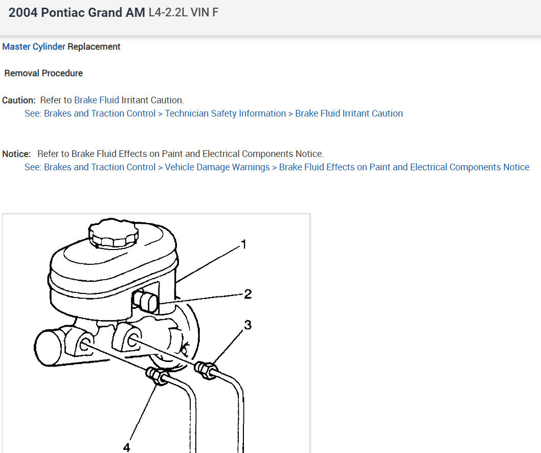

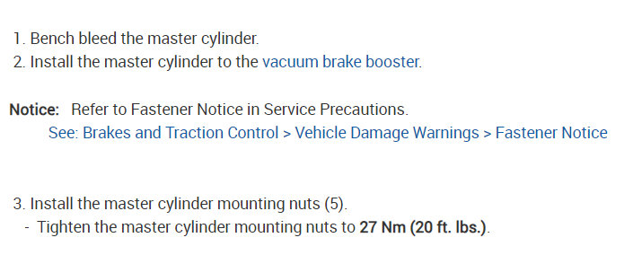

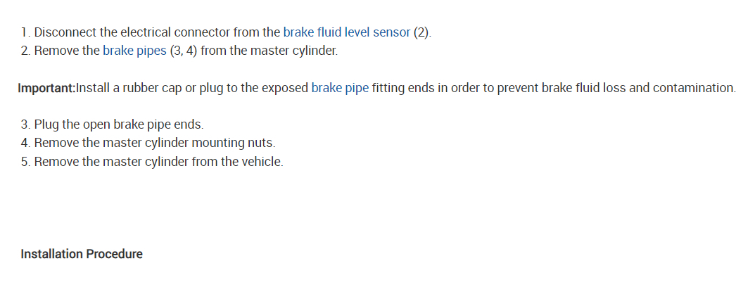

To me it sounds like a classic brake master cylinder failure, but you should check the caliper slides to make sure one of them is not frozen.
Here are two guides to help you see what's going on and how to replace the brake master cylinder as well:
