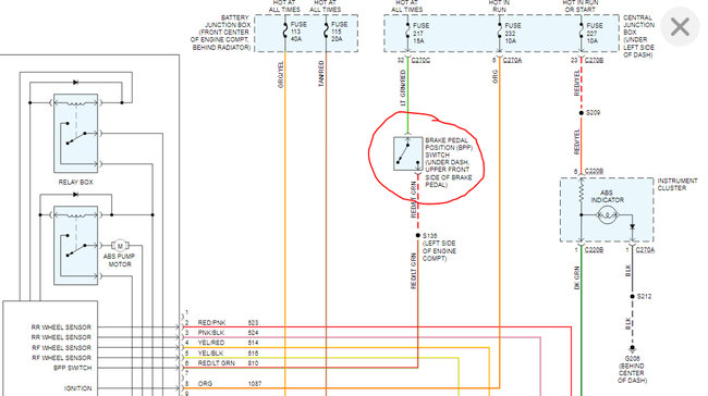

How to connect brake switch wires to the wires from the car?

Here is a tutorial showing you how to check your vehicles wiring:

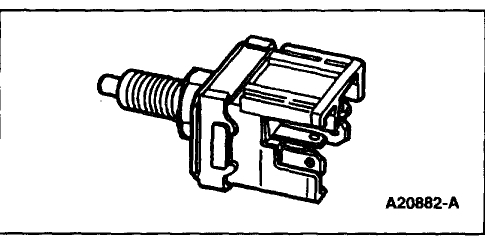

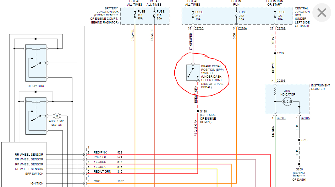

Below I've attached two pictures of it's description and the wiring diagram for your cars brake pedal position sensor.
Hope this helps and thanks for using 2CarPros.
