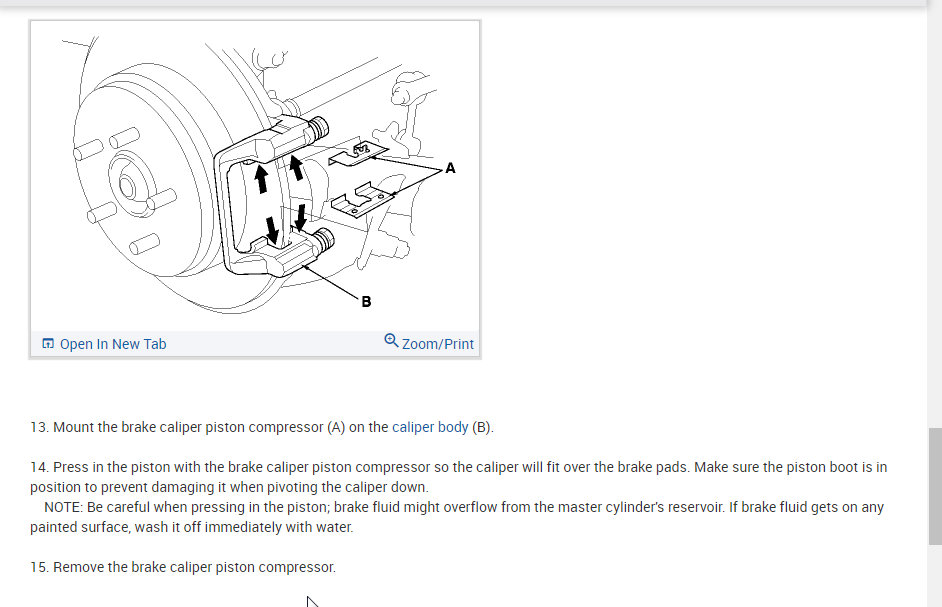

Plus here is a guide on how to retract the rear calipers:
https://www.youtube.com/watch?v=j8YwfSKEzZo&t=29s

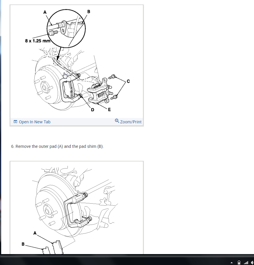

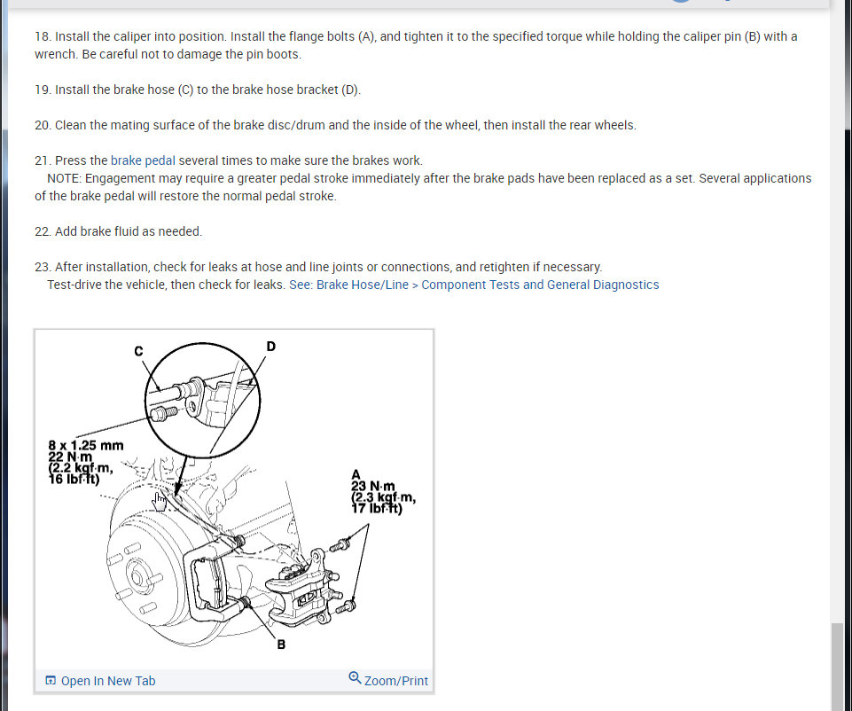

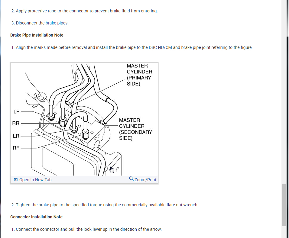

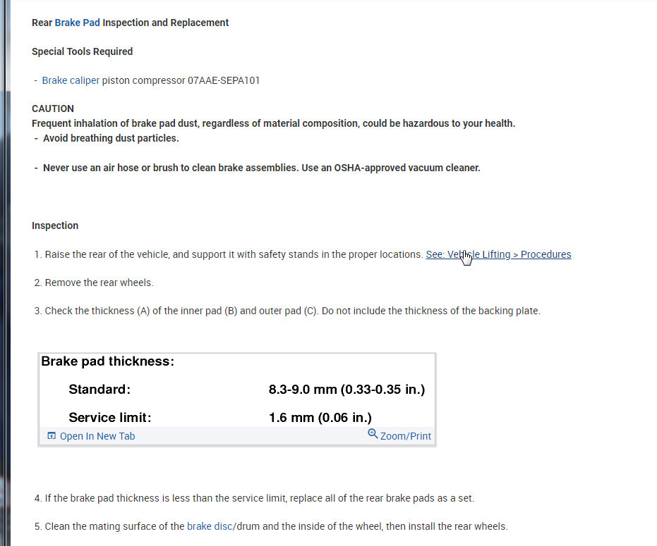

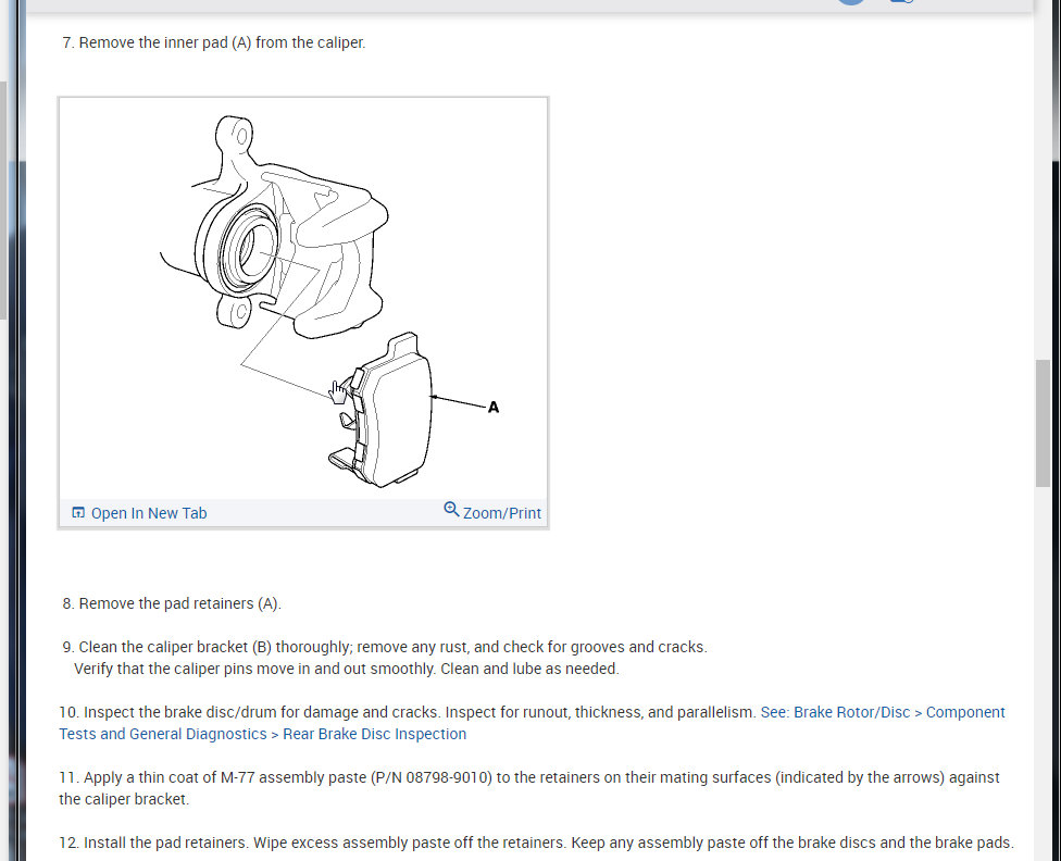

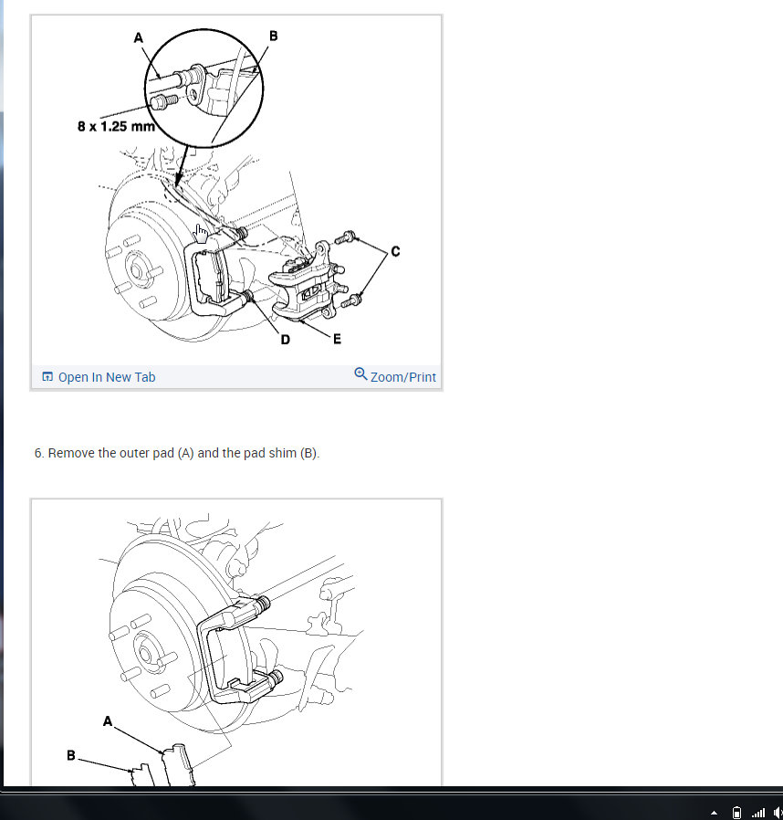

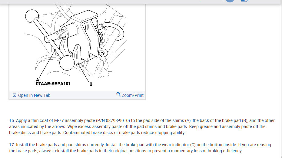

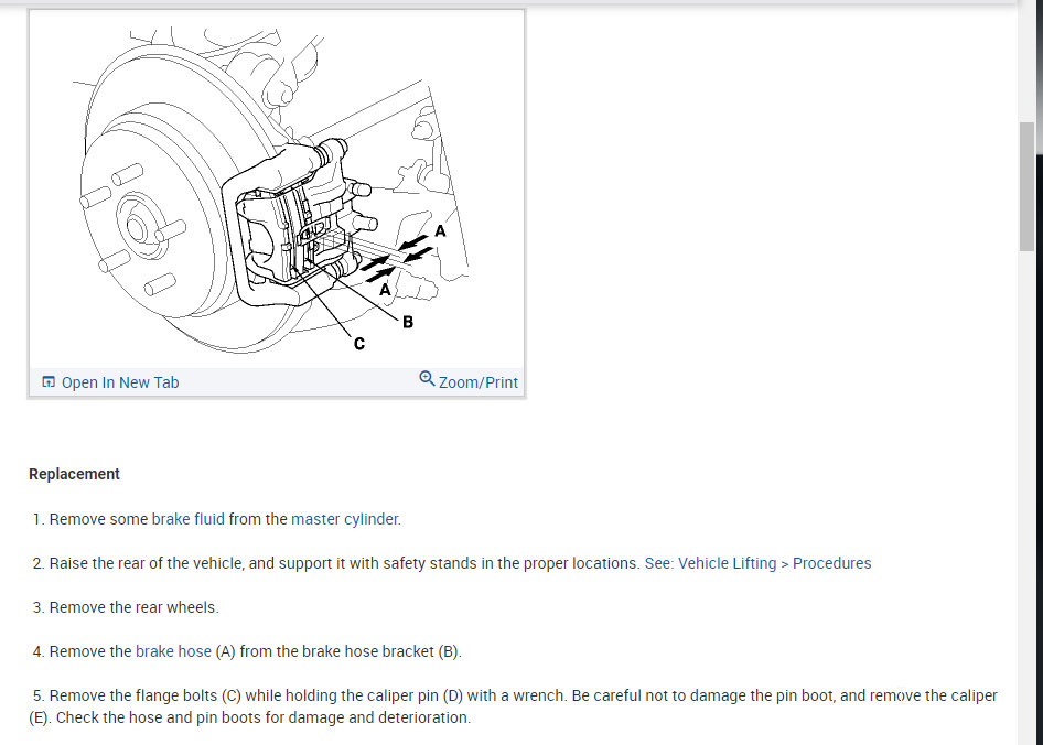

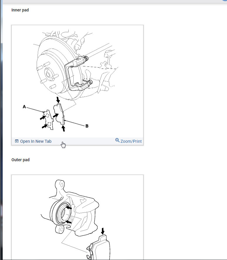

Below you will find the process from the manual that will help with this.
Let us know if you have questions. Thanks
