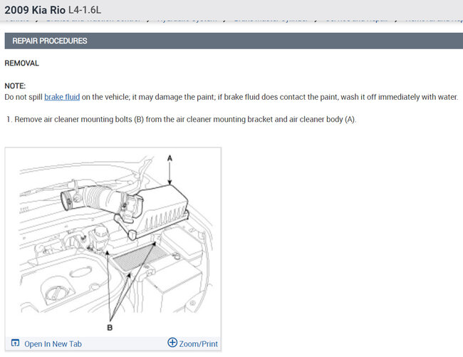

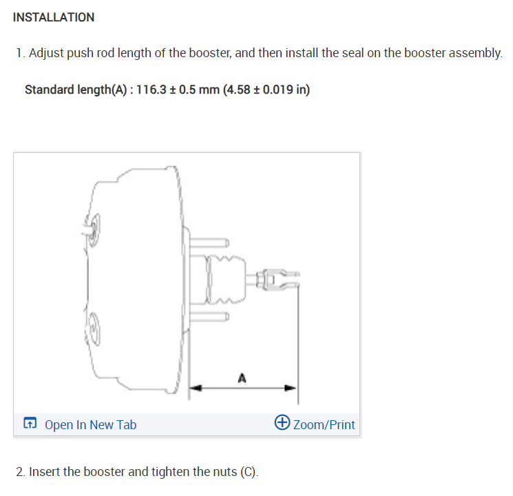

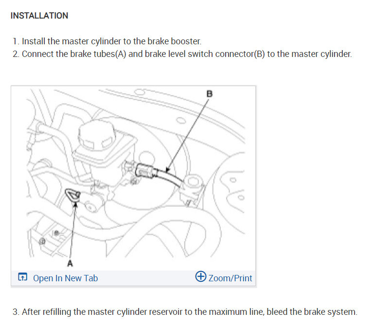

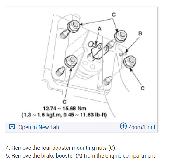

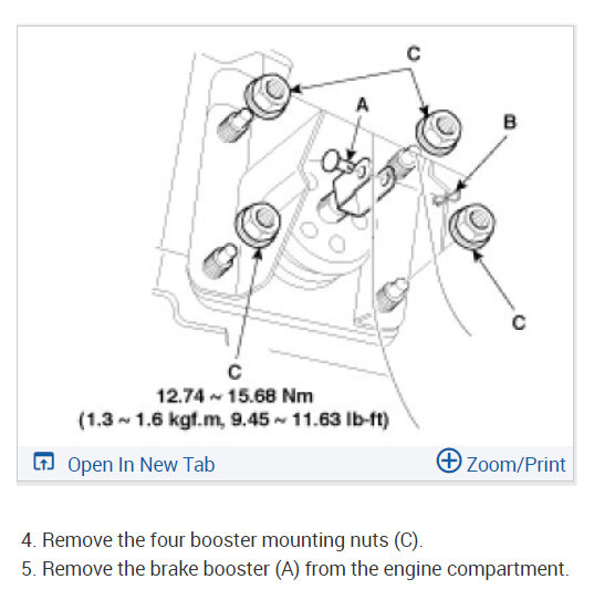

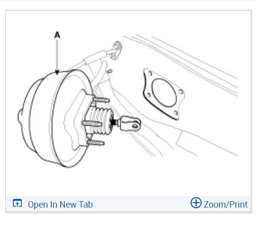

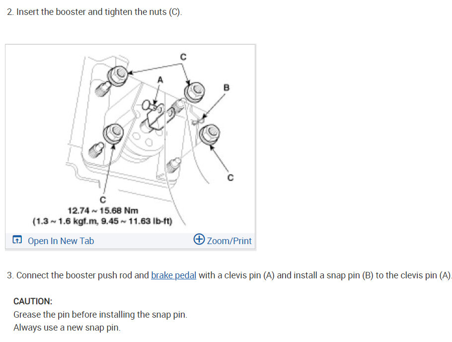

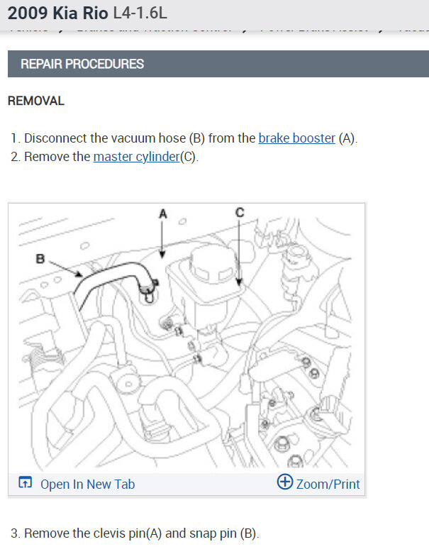

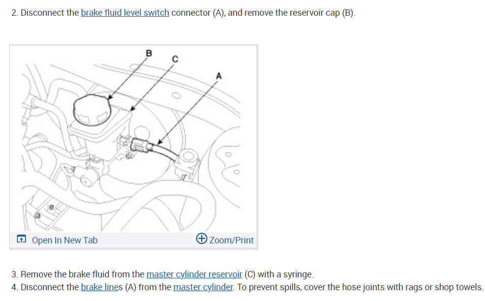

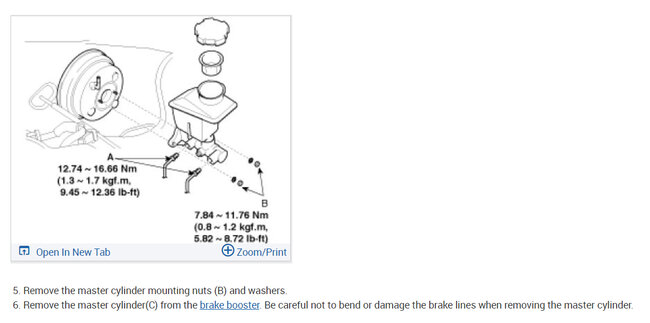

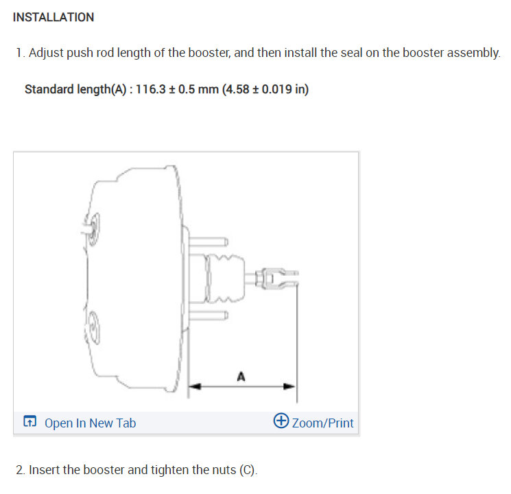

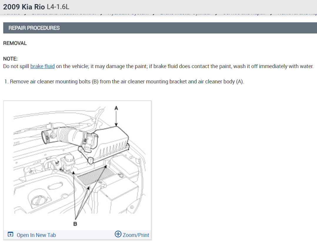

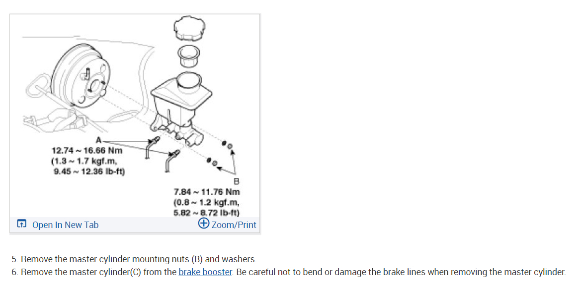

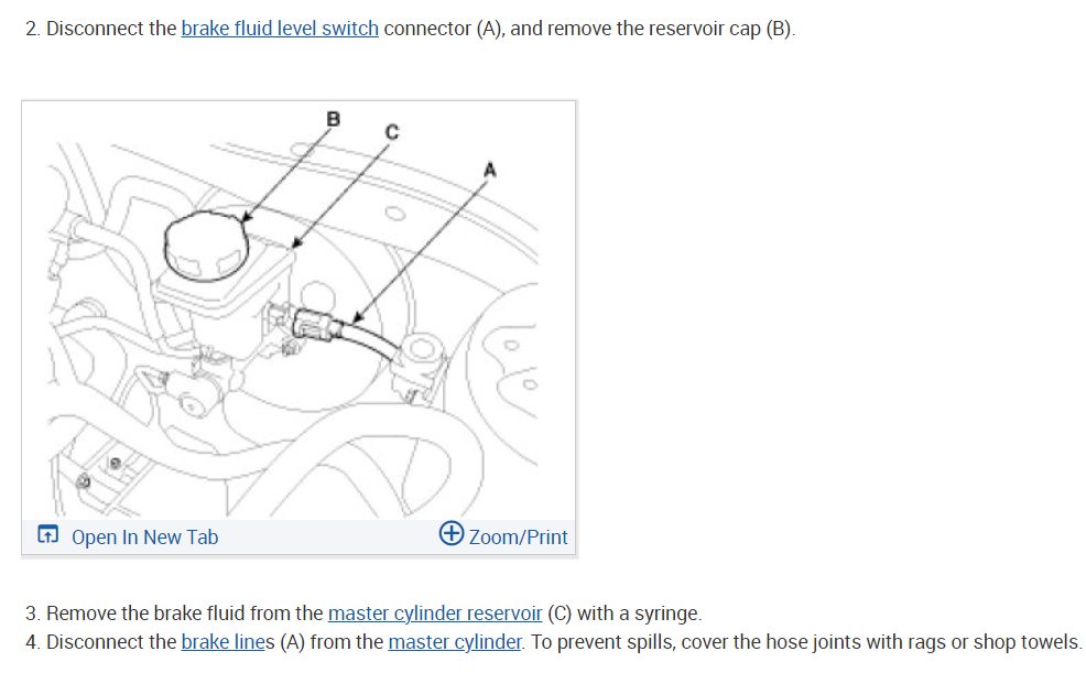

Yep, this can happen for one of two reasons, either you have a brake booster that is going bad and won't allow the brake master to return fully or the brake master cylinder is going bad and not fully returning. You can confirm the issue by loosening the brake master mounting nuts about 3 turns and if the front wheel starts to turn again you have found the problem. Please go over this guide to see what I am talking about, and I have included how to change the parts out as well in the images below.
and
https://www.2carpros.com/articles/how-to-replace-a-brake-master-cylinder
This video will show you how to bleed the master:
https://youtu.be/WDxvEQrMkBg?si=ntvLC3ILsXUCgGpm
If it is not obvious, I would do the brake master first.
Check out the images (below). Please upload pictures or videos in your response of the problem so we can see what's going on.
