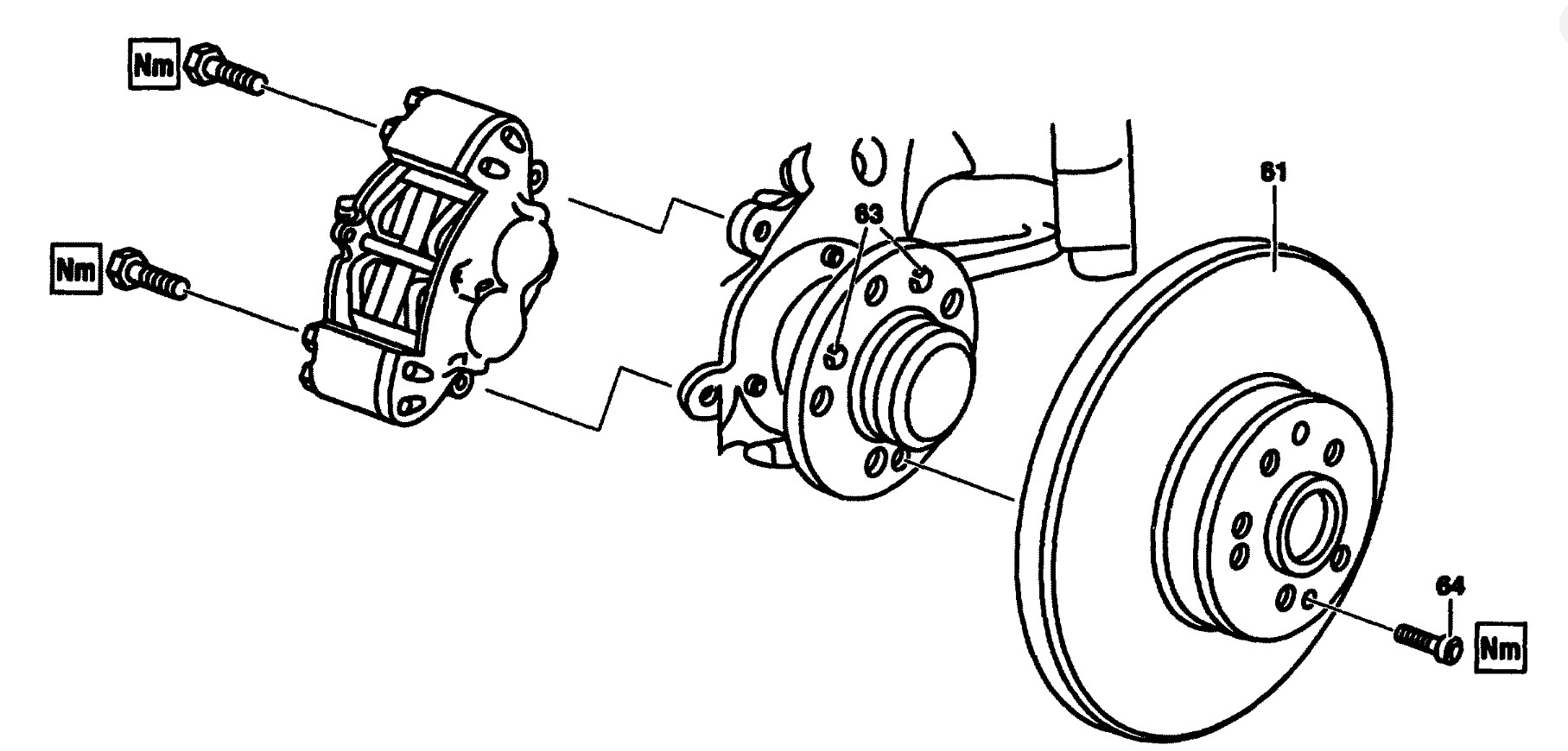

The front rotors will be vented, the rear rotors will be solid. The exact fit is applicable if you use the correct position on the car. They are not interchangeable however, so you will need vented ones for the front. As you are replacing the rotors you will be replacing the pads as well, you might want to look at one of the kits rock auto sells. Like the Power Stop KOE2786 kit that does front and rear. That will get you the parts to do both ends but at a discount on the parts and only one shipping charge. Just toss the rear parts on the shelf until you get to them.
This guide is similar to what you have except you have alignment pins on the hubs to hold the rotor in place while you change the parts:
