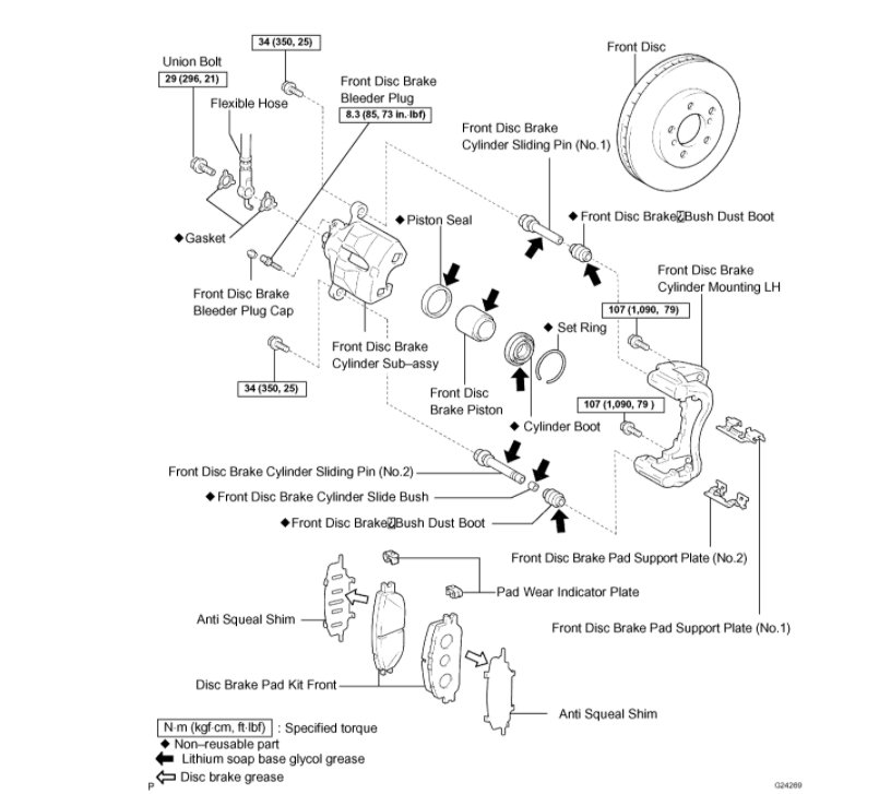

FRONT BRAKE
OVERHAUL
HINT: Overhaul the RH side by the same procedure as the LH side.
1. REMOVE FRONT WHEEL
2. DRAIN BRAKE FLUID
NOTICE: Wash the brake fluid off immediately if it attaches to any painted surface.

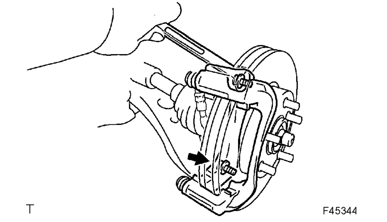

3. REMOVE FRONT DISC BRAKE CYLINDER SUB-ASSEMBLY
a. Remove the union bolt and 2 gaskets from the front disc brake cylinder sub-assembly, then disconnect the flexible hose.
b. Hold the front disc brake cylinder slide pin and remove the 2 bolts.
4. REMOVE DISC BRAKE PAD KIT FRONT (PAD ONLY)
a. Remove the disc brake pad kit front from the front disc brake cylinder mounting LH.
5. REMOVE ANTI SQUEAL SHIM KIT FRONT
a. Remove the anti squeal shim and pad wear indicator plate from the each pad.
6. REMOVE FRONT DISC BRAKE PAD SUPPORT PLATE
a. Remove the front disc brake pad support plate (No.1) and front disc brake pad support plate (No.2) from the front disc brake cylinder mounting LH.

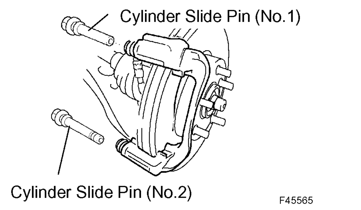

7. REMOVE FRONT DISC BRAKE CYLINDER SLIDE PIN
a. Remove the front disc brake cylinder slide pin (No. 1) and front disc brake cylinder slide pin (No.2) from the front disc brake cylinder mounting LH.

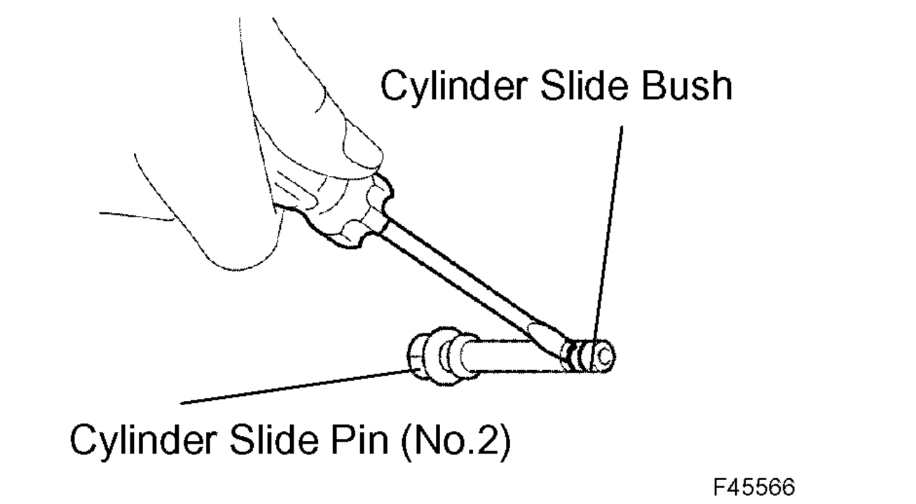

8. REMOVE FRONT DISC BRAKE CYLINDER SLIDE BUSH
a. Using a screwdriver, remove the front disc brake cylinder slide bush from the front disc brake cylinder slide pin (No.2)
NOTICE: Do not damage the front disc brake cylinder slide pin (No.2).
9. REMOVE FRONT DISC BRAKE CYLINDER MOUNTING LH
a. Remove the 2 bolts and front disc brake cylinder mounting LH.

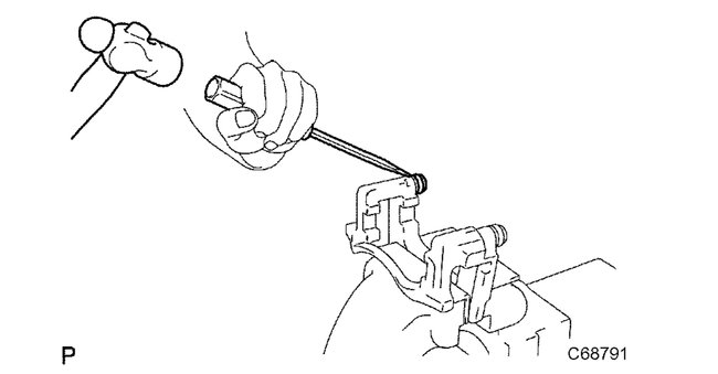

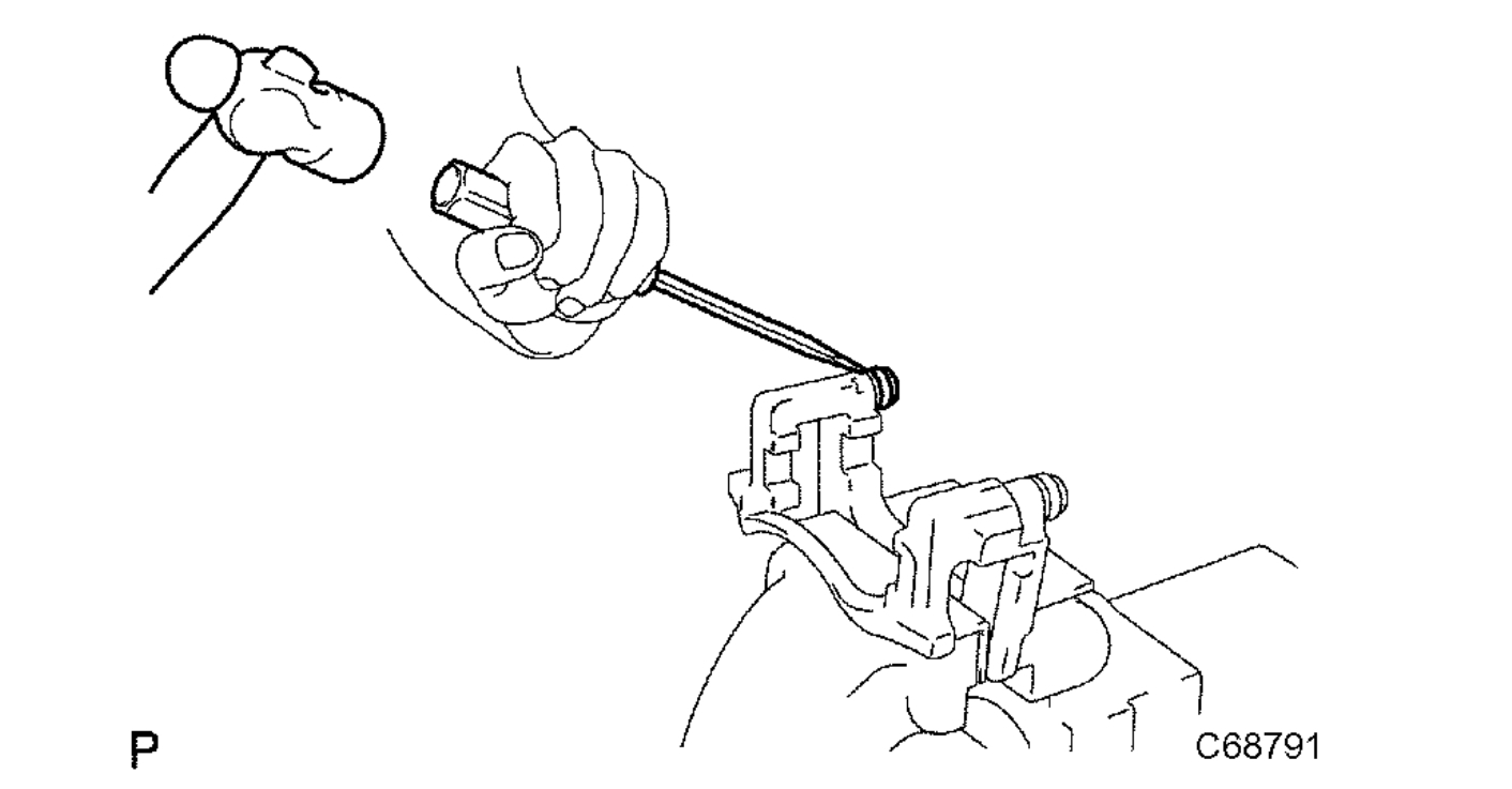

10. REMOVE FRONT DISC BRAKE BUSH DUST BOOT
a. Using soft jaws on the vise, hold the front disc brake cylinder mounting LH in the vise through aluminum plates.
b. Using a screwdriver and hammer, remove the 2 front disc brake bush dust boots from the front disc brake cylinder mounting LH.
11. REMOVE CYLINDER BOOT
a. Using a screwdriver, remove the set ring and cylinder boot.
12. REMOVE FRONT DISC BRAKE PISTON
a. Place a shop rug, between the front disc brake piston and the disc brake cylinder sub-assembly.
b. Use compressed air to remove the front disc brake piston from the disc brake cylinder sub-assembly.
CAUTION: Do not place your fingers in front of the piston when using compressed air.
NOTICE: Do not spatter the brake fluid.
13. REMOVE PISTON SEAL
a. Using a screwdriver, remove the piston seal from the front disc brake cylinder sub-assembly.
NOTICE: Do not damage the inner cylinder and cylinder groove.
14. REMOVE FRONT DISC BRAKE BLEEDER PLUG
a. Remove the front disc brake bleeder plug from the front disc brake cylinder sub-assembly.
15. REMOVE FRONT DISC BRAKE BLEEDER PLUG CAP
16. INSPECT BRAKE CYLINDER AND PISTON
a. Check the brake cylinder bore and front disc brake piston for rust or scoring.
17. INSPECT PAD LINING THICKNESS
a. Using a ruler, measure the pad lining thickness.
Standard thickness: 12.0 mm (0.472 inch)
Minimum thickness: 1.0 mm (0.039 inch)
18. INSPECT FRONT DISC BRAKE PAD SUPPORT PLATE
a. Inspect the front disc brake pad support plate (No.1) and front disc brake pad support plate (No.2). Make sure that they have sufficient rebound, no deformation, cracks or wear, and have had all rust and dirt cleaned off.

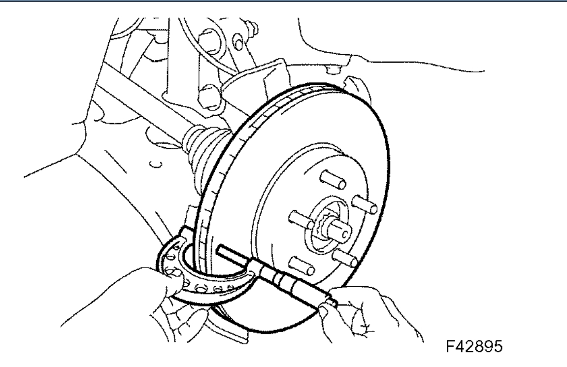

19. INSPECT DISC THICKNESS
a. Using a micrometer, measure the disc thickness.
Standard thickness: 28.0 mm (1.102 inch)
Minimum thickness: 26.0 mm (1.024 inch)
20. REMOVE FRONT DISC
a. Place matchmarks on the front disc and the axle hub.
b. Remove the front disc.
21. INSTALL FRONT DISC
a. Aligning the matchmarks, install the front disc.
