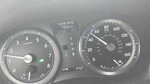

Please see the video and I hope you hear the pulsation. Also I did not see any pulling to either direction when the car stop or pulsation occurred.

I think you forgot to upload the video.

3rd time :)

If what I think I heard in the the less than 1 second it lasted did sound like the ABS engaging.
Have you retrieved the codes yet?
