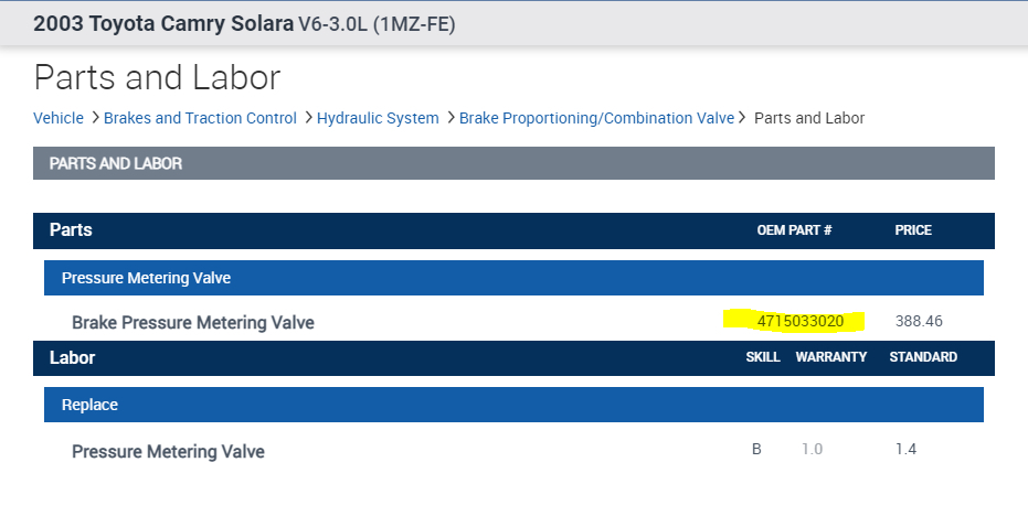

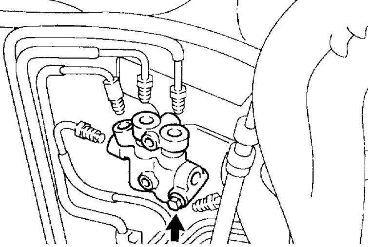

Interestingly, that is the same part number as my manual shows. See pic 1. And yes, it is for 4 lines. When I look under Camry only (not Solara) it shows me the one you need but there is no part number. See pic 2 below.
I did a little more research and "Think" you have a late model 2003 production vehicle, and 2004 parts may have been used. The part number I believe you are looking for is 9041210140. Take a look online and let me know if that is what you have.
