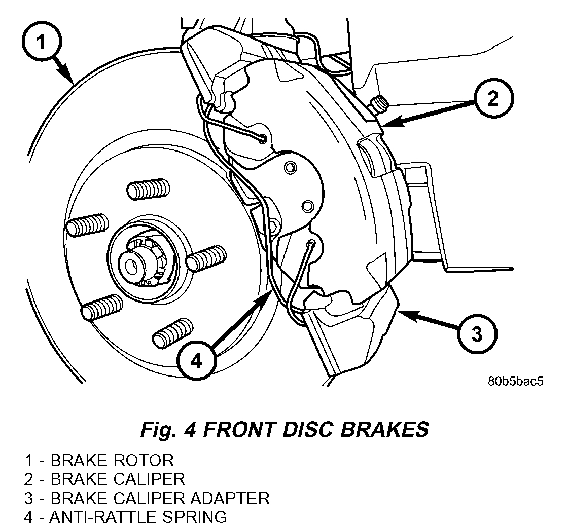

3. Remove the anti-rattle spring from the outboard side of the caliper and adapter (Fig. 4).

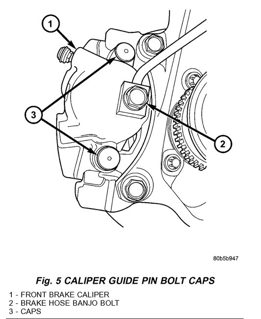

4. Remove the two caps in place over the caliper guide pin bolts (Fig. 5).

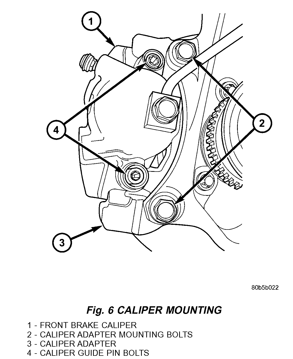

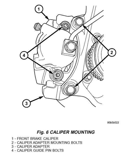

5. Remove the two caliper guide pin bolts (Fig. 6).
6. Remove caliper from caliper adapter and brake rotor. The outboard shoe will probably stay with the caliper adapter while the inboard shoe will come off with the caliper as the caliper is removed.

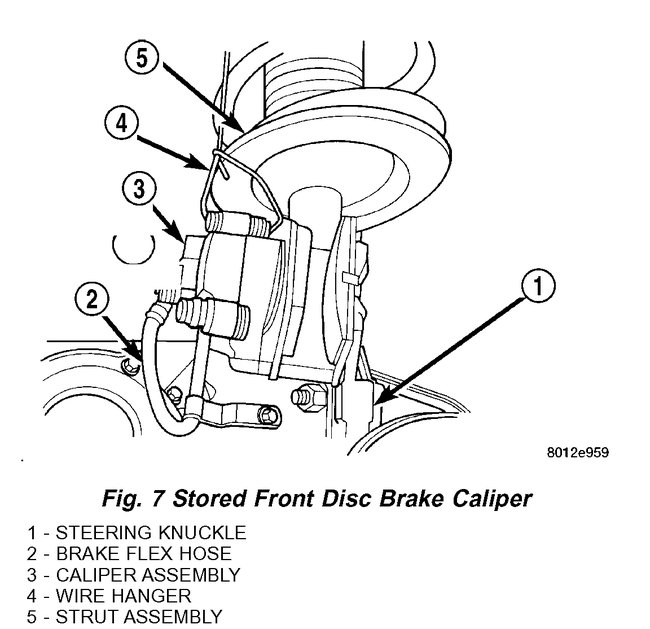

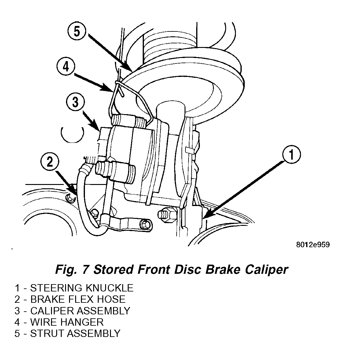

7. Using wire or cord, hang the caliper from the front strut assembly (Fig. 7). Support the caliper firmly to prevent weight of caliper from being supported by the brake fluid hose.

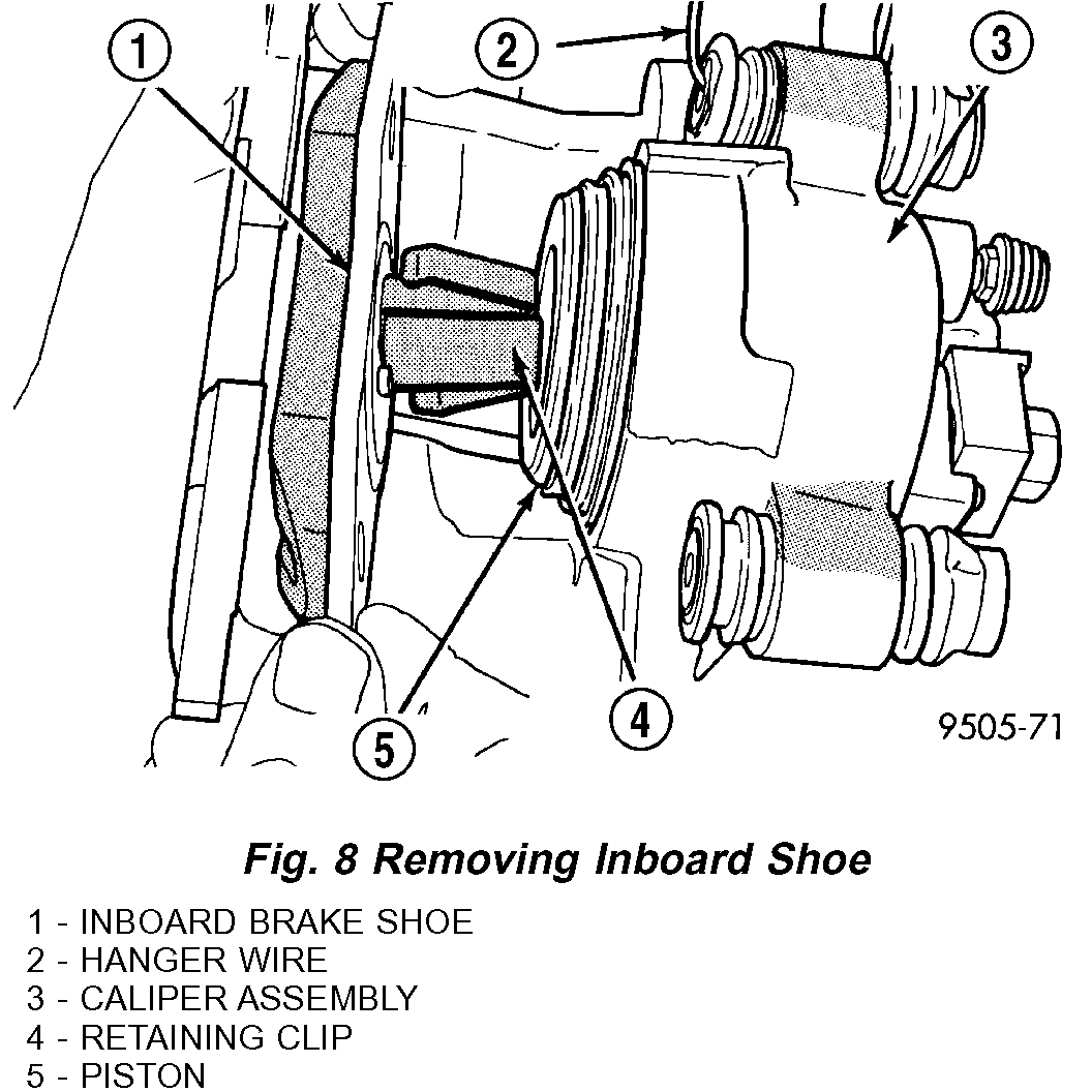

9. Pull the inboard brake shoe away from the caliper piston until the retaining clip on shoe is free from the cavity in the caliper piston (Fig. 8).

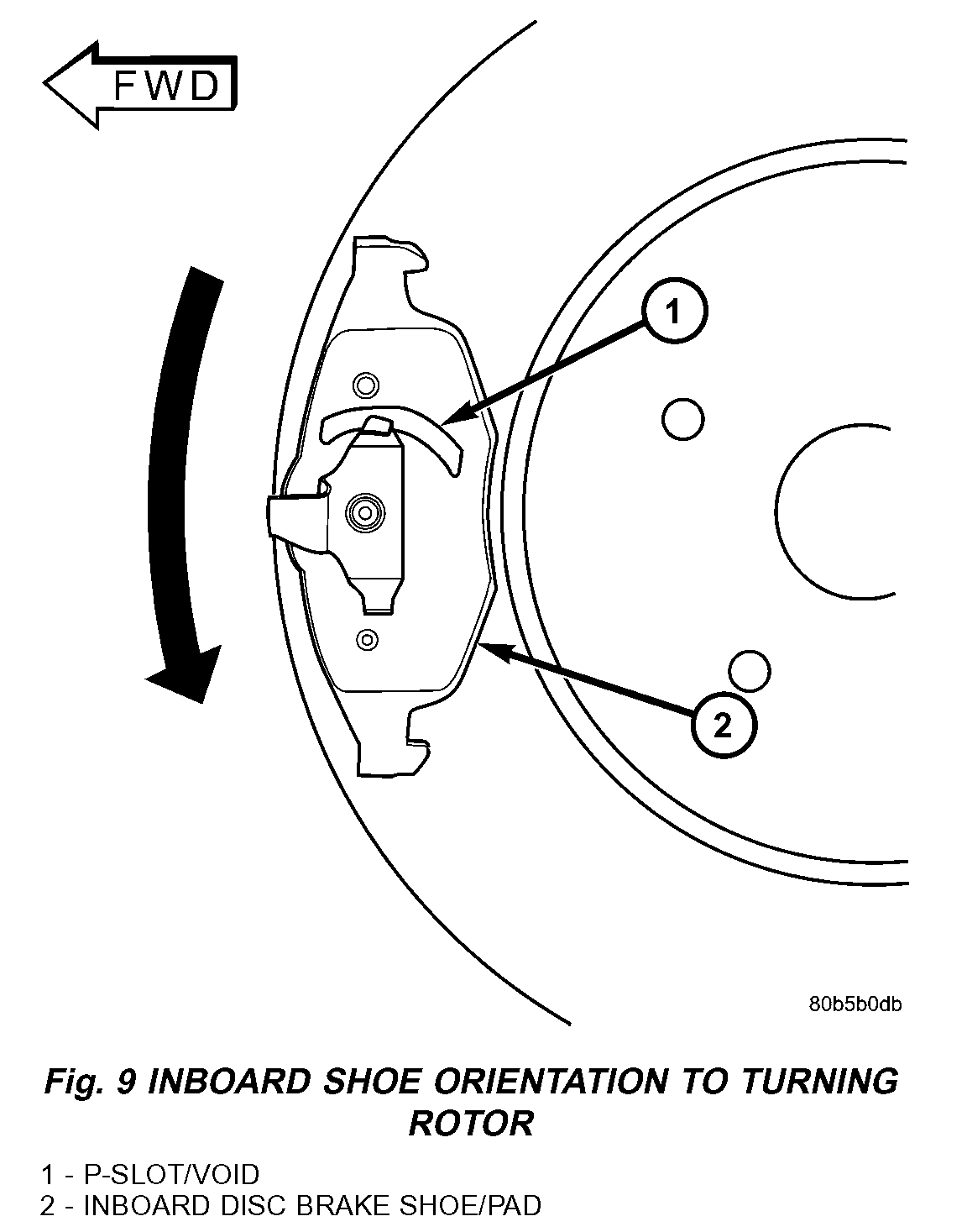

NOTE: Inboard brake shoes are stamped L or R for left or right side of the vehicle. The P-slot or void on piston insulator must be positioned upward when brake caliper is mounted (Fig. 9).

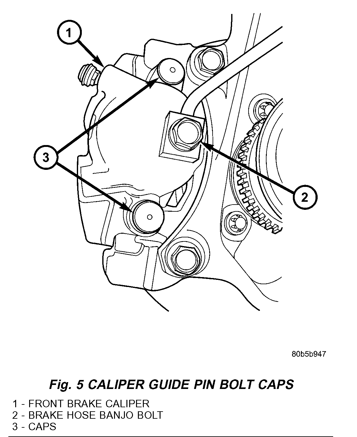

9. Install the caps over the caliper guide pin bolts (Fig. 5).
10. Install the new caliper hold down spring (antirattle clip) on the outboard side of the caliper. Start the spring into the holes on the caliper, then stretch the clip legs past the abutments on the caliper adapter (Fig. 4).
