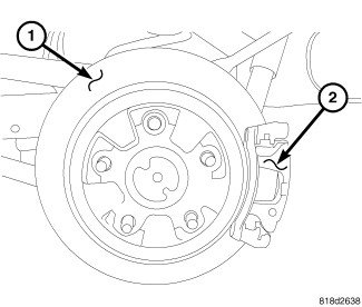

REAR DISC BRAKE PADS
pic 1
1. Raise and support vehicle.
2. Remove the wheel and tire assemblies.
3. Compress the caliper.
4. Remove the caliper, (Refer to 05 - Brakes/Hydraulic/Mechanical/CALIPER, Disc Brake - Removal) .
NOTE: Do not allow brake hose to support caliper assembly.
5. Support and hang the caliper.
6. Remove the inboard brake pad (3) from the caliper adapter (1).
7. Remove the outboard brake pad (4) from the caliper adapter (1).

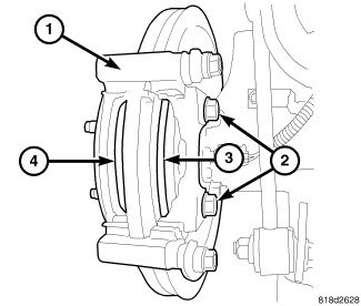

pic 2
1. Bottom pistons in caliper bore with C-clamp. Place an old brake shoe between a C-clamp and caliper piston.
2. Clean caliper mounting adapter and anti-rattle springs.
3. Install anti-rattle springs.
NOTE: Anti-rattle springs are not interchangeable.
4. Install inboard brake pad (3) in adapter (1).
5. Install outboard brake pad (4) in adapter (1).
6. Install caliper, (Refer to 05 - Brakes/Hydraulic/Mechanical/CALIPER, Disc Brake - Installation) .
7. Install wheel and tire assemblies and lower vehicle, (Refer to 22 - Tires and Wheels/Wheels - Standard Procedure) .
8. Apply brakes several times to seat caliper pistons and brake pads to obtain firm pedal.
9. Top off master cylinder fluid level.

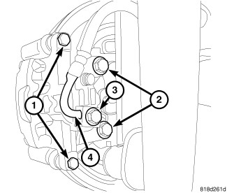

BRAKE ROTOR - REMOVAL (REAR)
REAR
pic 3
1. Raise and support the vehicle
2. Remove the tire and wheel assembly.

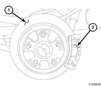

pic 4
CAUTION: Never allow the disc brake caliper to hang from the brake hose. Damage to the brake hose will result. Provide a suitable support to hang the caliper securely.
3. Remove the disc brake caliper adapter (2) (Refer to 05 - Brakes/Hydraulic/Mechanical/ADAPTER, Disc Brake Caliper - Removal) .
4. Remove the retaining clips and rotor assembly.
