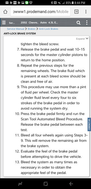

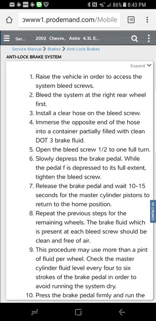

If you have abs brakes you will need a scan tool able to do the abs automated bleed procedure.I posted how to bleed brakes with abs and a scan tool.There is no way around not using the scan tool.

SATURNTECH9
  • 30,869 POSTS
Your going to need a high end professional scan tool a diyer one isn't going to be able to do that.
