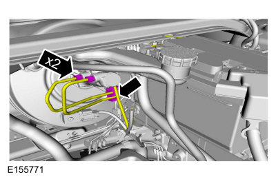

Here are the direction specific to replacement on your vehicle:
BRAKE MASTER CYLINDER
Brake Master Cylinder
Removal
NOTICE: Do not spill brake fluid on painted or plastic surfaces or damage to the surface may occur. If brake fluid is spilled onto a painted or plastic surface, immediately wash the surface with water.
NOTE: Removal steps in this procedure may contain installation details.
1. WARNING: Before beginning any service procedure, refer to Safety Warnings in General Information. See: Vehicle > Initial Inspection and Diagnostic Overview Failure to follow this instruction may result in serious personal injury.
Refer to: Health and Safety Precautions See: Vehicle > Technician Safety Information > Health and Safety Precautions (General Information). See: Vehicle > Initial Inspection and Diagnostic Overview
2. NOTICE: Before removing the master cylinder, relieve the vacuum in the brake booster or the master cylinder O-ring seal may be drawn into the brake booster, causing brake booster failure and increased brake pedal effort.
Picture 1
3. Torque : 18 lb.ft (25 Nm)

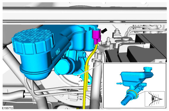

Picture 2
4. Torque : 18 lb.ft (25 Nm)

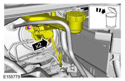

Picture 3
5. NOTE: Make sure that the master cylinder-to-booster seal is removed with the master cylinder.

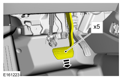

Picture 4
