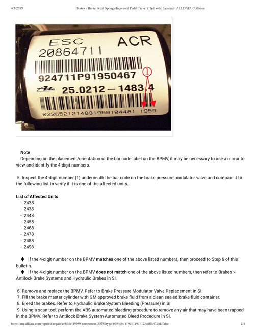

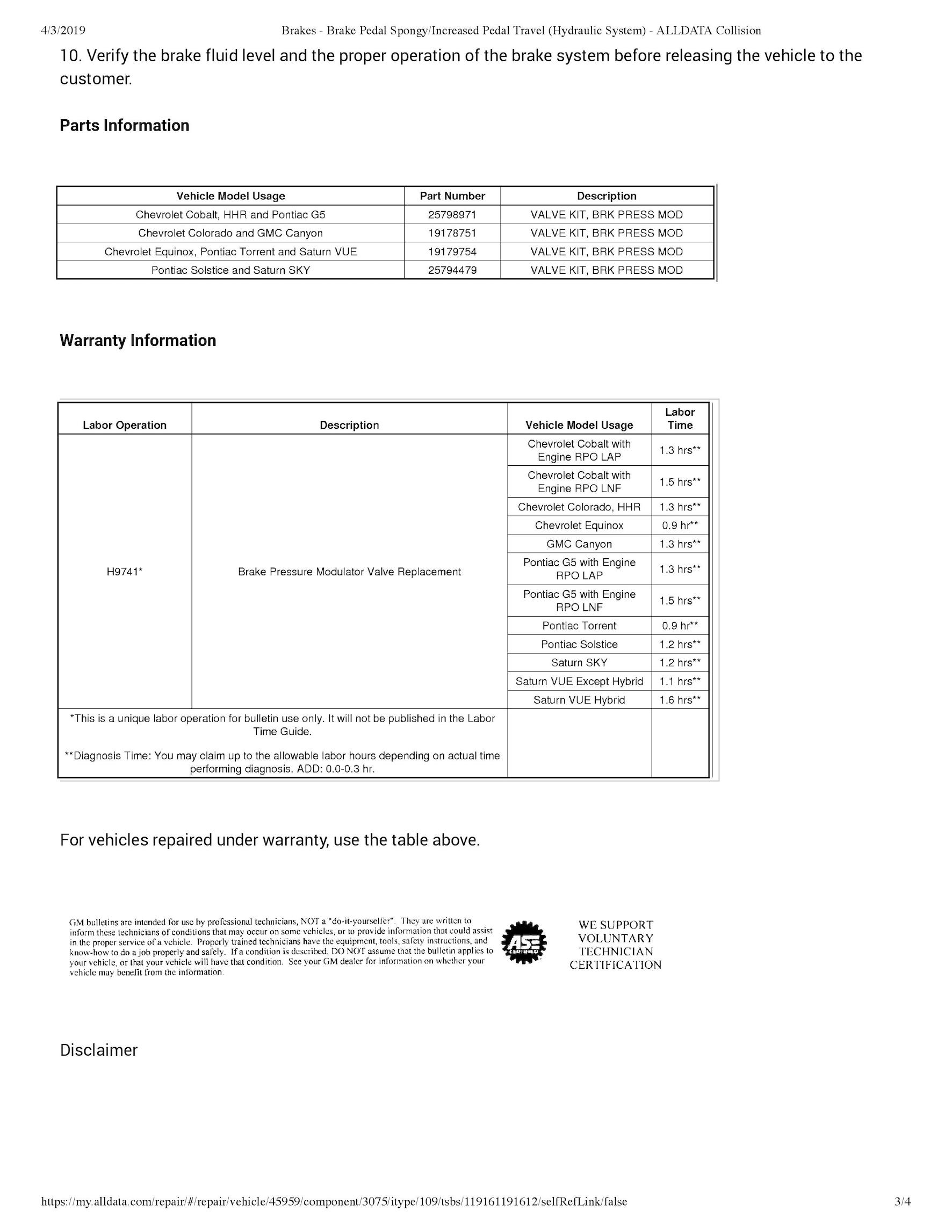

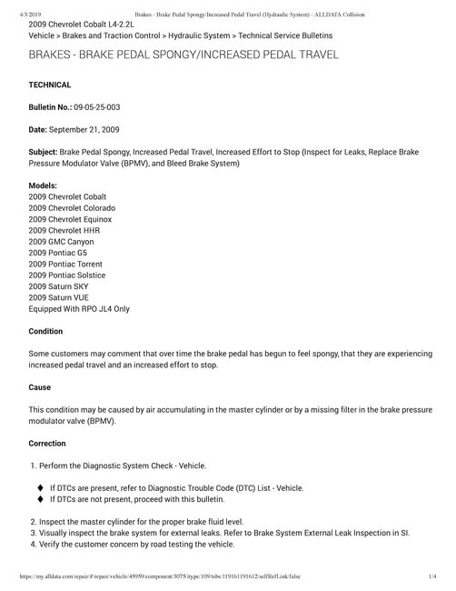

Are you sure the car does not have ABS? From what i can see from the year model you should have ABS. There is a specific bleed procedure to carry out when replacing parts on these systems.
There is a TSB applicable for your vehicle that i have attached below.
Your vehicle may be affected by this and may require a replacement brake pressure modulator valve.I would suspect there is air in the lines. These guides can help you fix it.

Can you please get the TSB check done from my previous message with the brake pressure modulator valve and let me know if that helps.
It looks like this is a known issue that a dealer will be able to carry out for you relatively cheaply and will hopefully fix the issue.

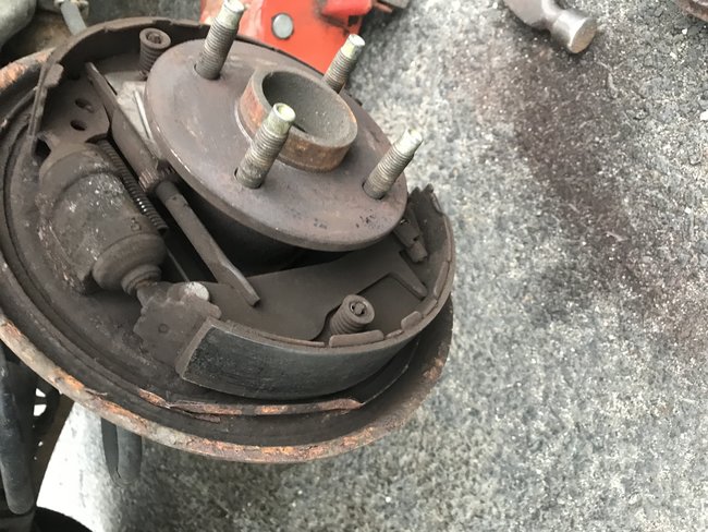

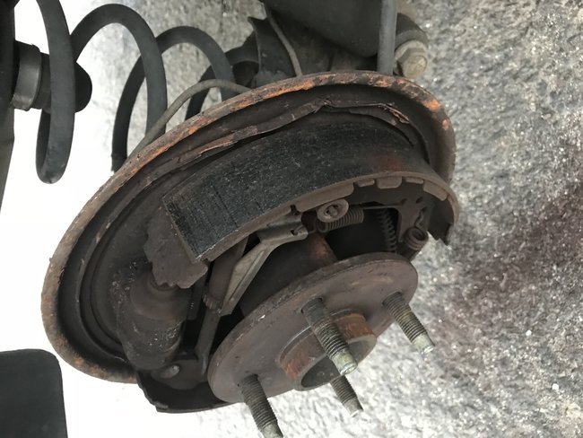

All the brake fluid was flushed when I had the master cylinder done. I have drum brakes. Attached is a recent picture of them from Sunday when I had the calibers replaced.

If I can jump in here, it looks like the rear shoes are worn out causing the low pedal. here is a video of the job being done on a similar car which shows how to adjust the new shoes once you have replaced them:

I replaced the shoes today and the brake pedal is still spongy.
So far, I’ve replaced brake master cylinder, brake calipers, brake pads, and brake shoes. My pedal still hasn’t changed. I don’t know where else I go from here. No leaks still. The car has the appropriate amount of brake fluid.
