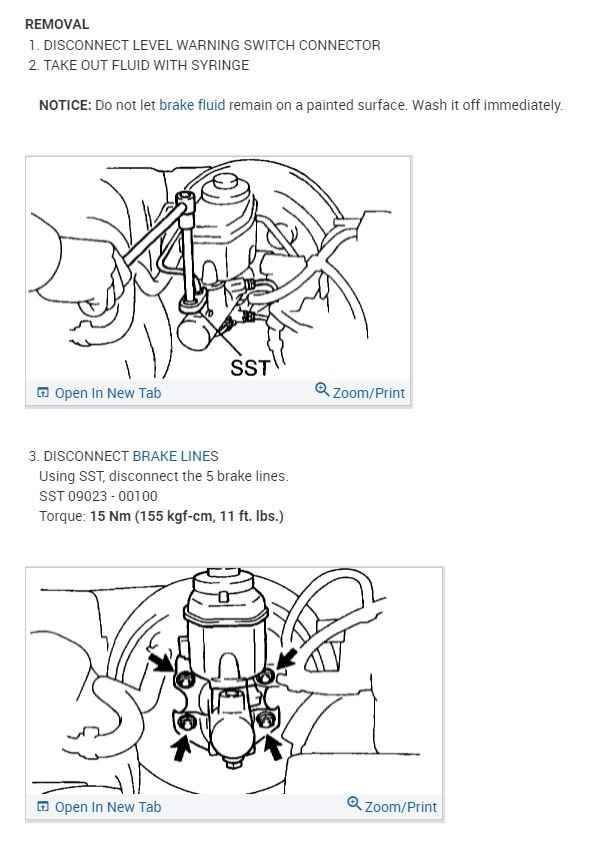

Very little stopping force. This was an all of a sudden thing. Won't pump up. Not a slow going to the floor, almost nothing(resistance) until almost to the floor. No leaks evident and fluid level good. New master cylinder, pads and brake lines about a year ago. Non ABS brakes. I think it's the master cylinder or brake booster. How to determine which one?
Mar 14, 2022 at 3:59 AM
Good morning,

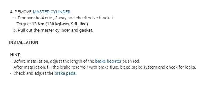

The booster will not cause this. This is a master cylinder failure as that is where the pressure is developed.
Use a rebuilt or new cylinder and bleed them out well.
https://www.2carpros.com/articles/brake-pedal-goes-to-the-floor
https://www.2carpros.com/articles/how-to-replace-a-brake-master-cylinder
https://www.2carpros.com/articles/how-to-bleed-or-flush-a-car-brake-system
Let me know if you have any other questions.
