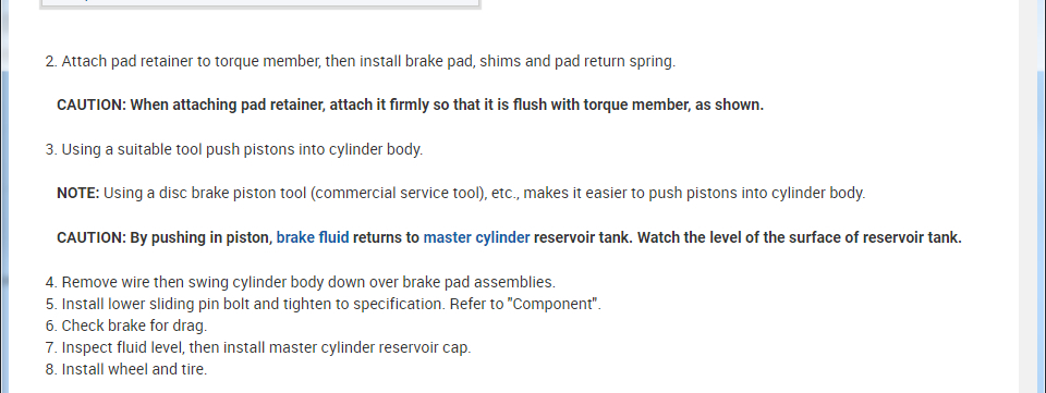

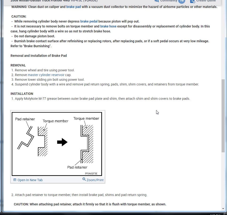

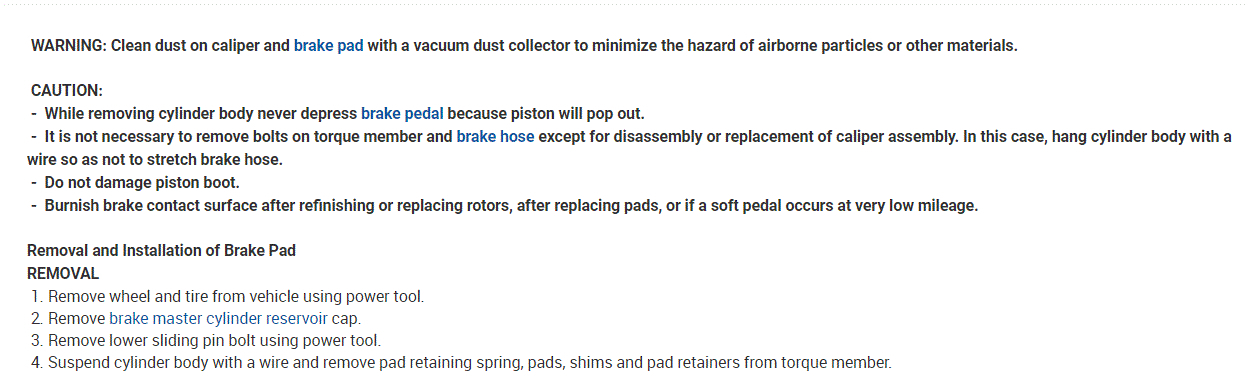

Here is a guide that will help with getting this completed:
Below is the process from the manual on how to replace the front brakes. Please run through this material and let us know what questions you have. Thanks

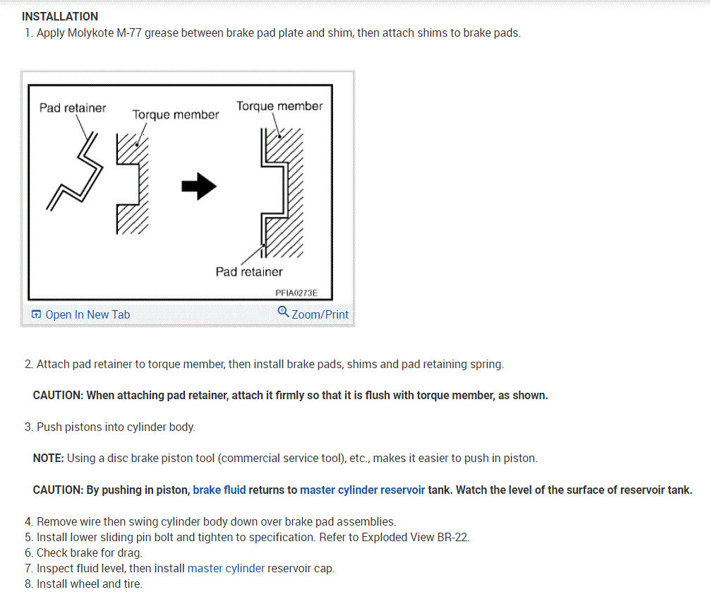

I am attaching a guide that will help with replacing the pads and rotors and how to bleed the brakes if needed.
https://www.2carpros.com/articles/how-to-bleed-or-flush-a-car-brake-system
Below you will find the process from the manual to replace these as well.
Thanks

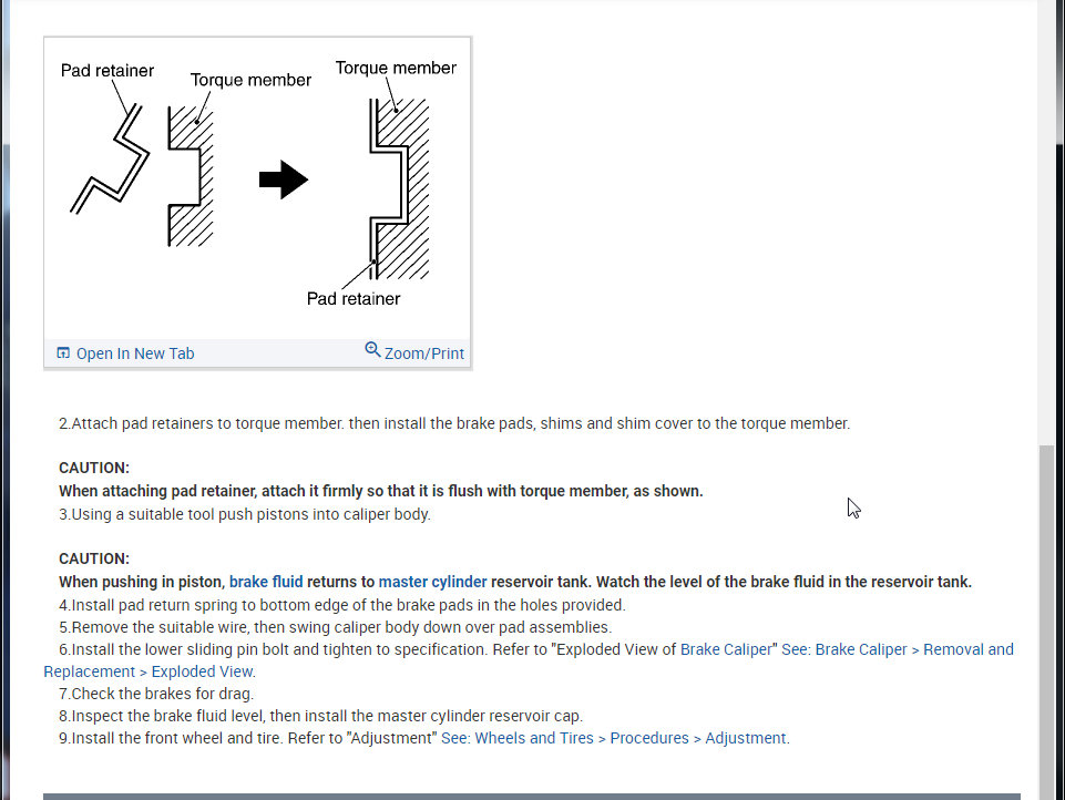

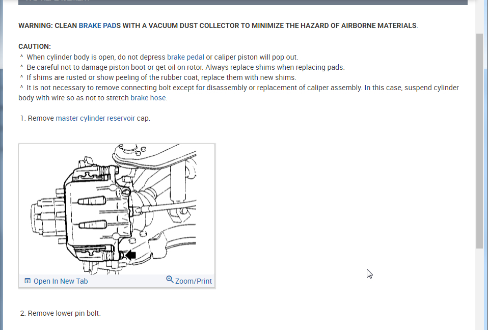

To get you started, here is a link that explains in general how the job is done. You can use this as a guide.

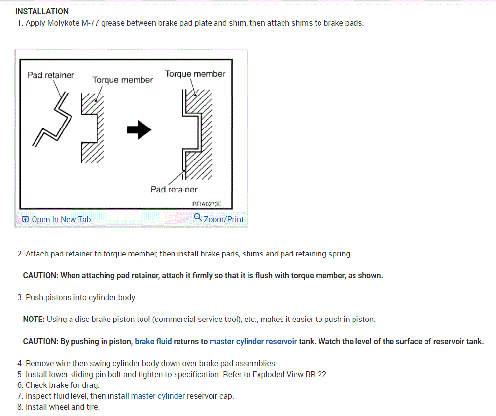

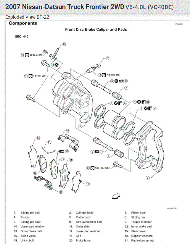

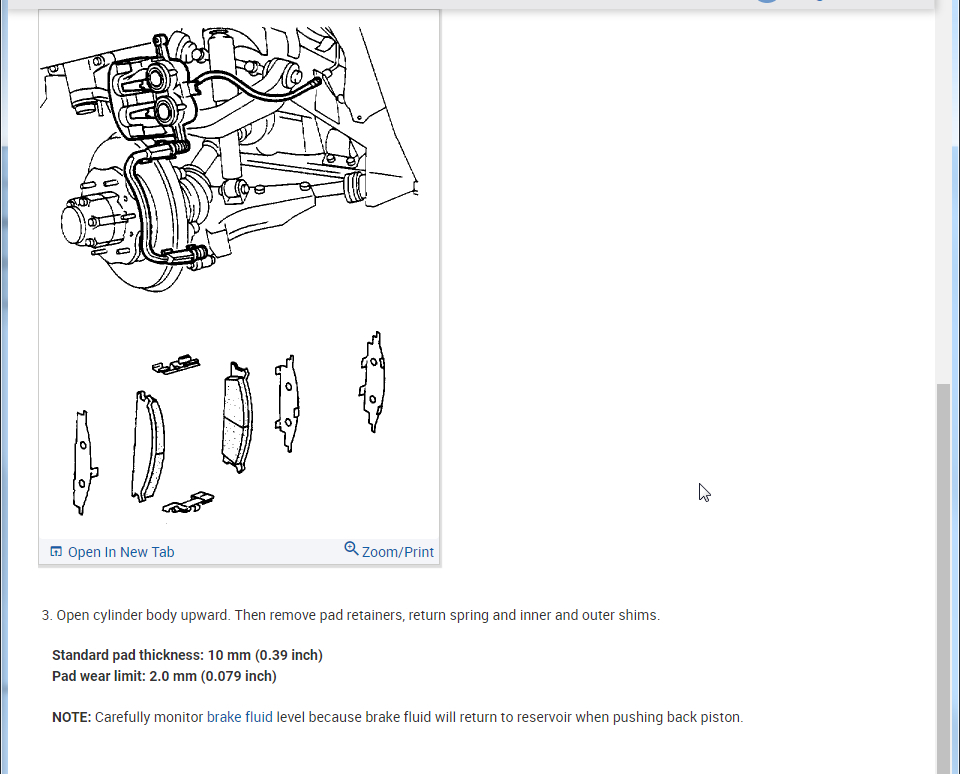

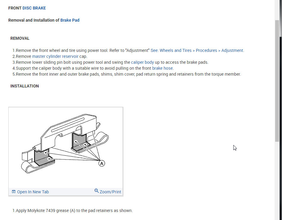

If you look at the attachments below, they include the directions specific to your vehicle for brake pad and rotor replacement.

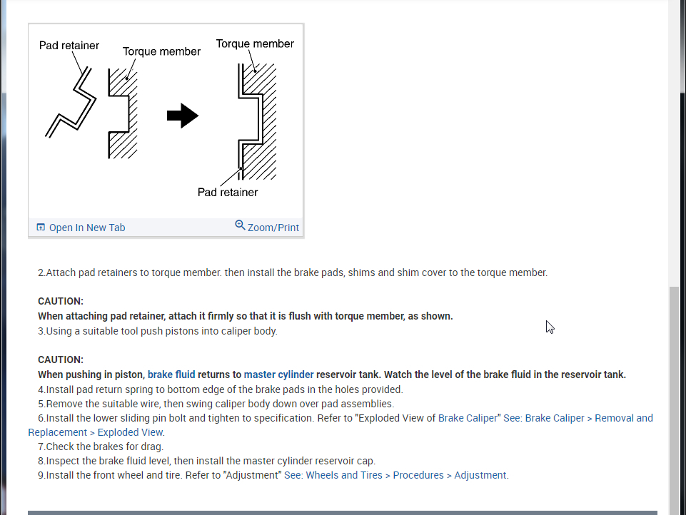

Once the brake caliper and pads are removed, you will need to remove the caliper mounting bracket. There are two bolts on the rear of the steering knuckle that attach it. Remove the bolts, remove the mount, and then you will be able to remove and replace the disc rotor.
I hope this helps. Let me know if you have other questions.

TIMG52

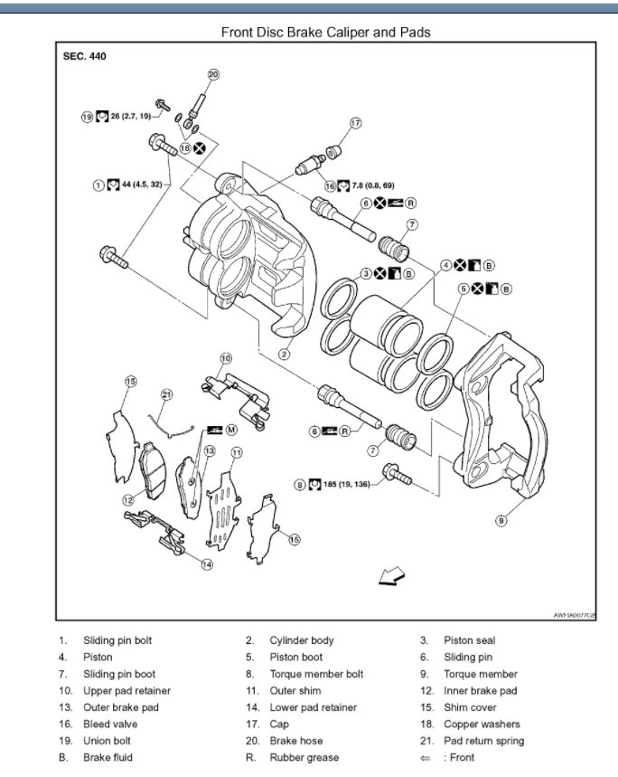

I just replaced my front pads,I cannot get the clip to reinstall
Does it need to be there?
May 12, 2021 at 1:05 PM (Merged)
MERLIN2021
  • 17,250 POSTS
Are you talking about the retainer clip? part #14? Not needed, but it does quit the rattling the pads will do going over bumps..use a wire brush, or file to remove rust buildup under the clip. then tap it on with a box wrench.
https://www.2carpros.com/forum/automotive_pictures/62217_2_61.jpg

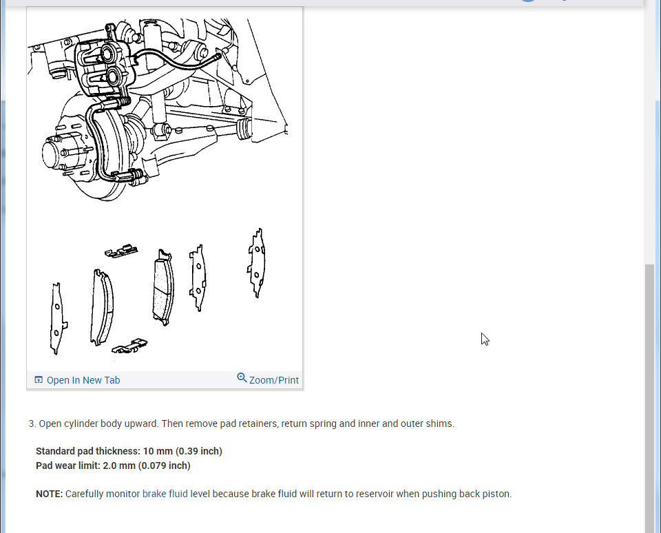

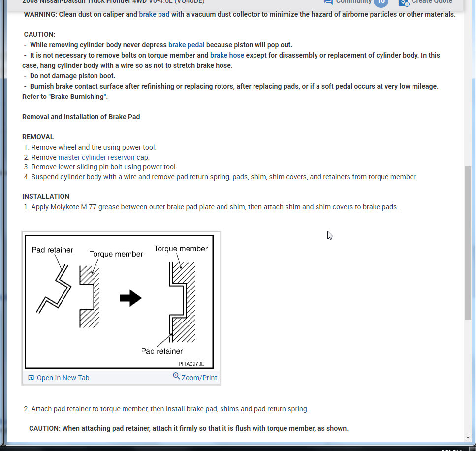

Here is a guide to help you with step by step instructions:
This video shows the job being done on a similar car but the process is the same:
https://www.youtube.com/watch?v=78rDqpK0CuM
Below you find the process from the manual that will give the detail that you need for your specific vehicle.
Please let us know if you have other questions. Thanks
