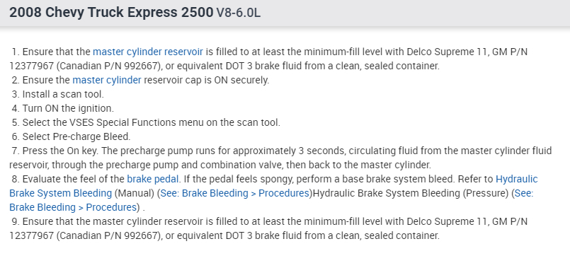

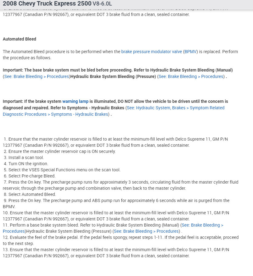

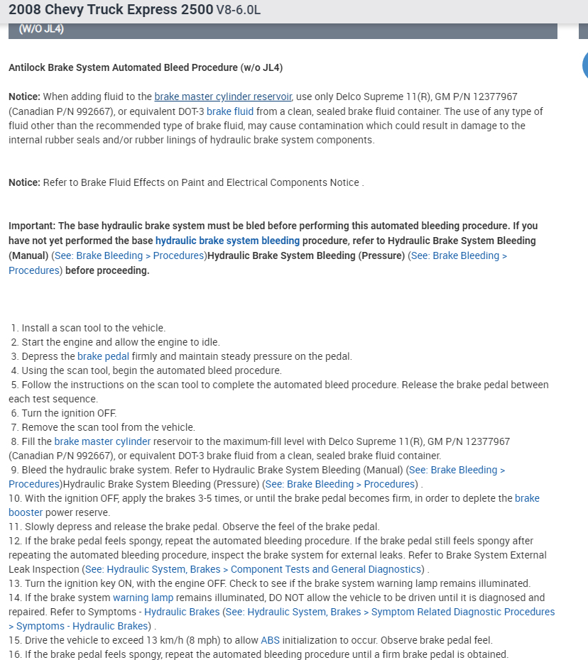

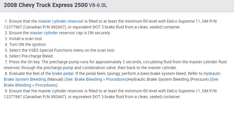

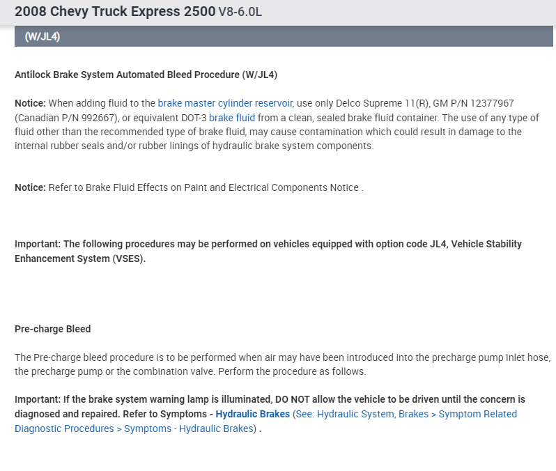

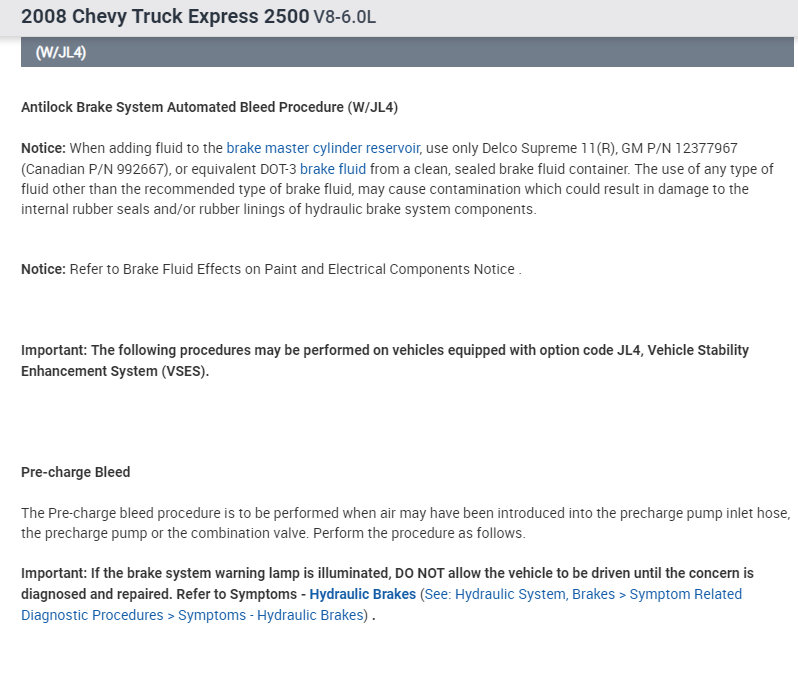

It is possible to still have air in the brake system as the ABS brake system does have a different process of bleeding. Typical procedure will not work and air will stay trapped and the pedal will go to the floor.
Here is a helpful video:
https://youtu.be/nQRnKyVyMuQ
I have also included the procedures below.

great video. I don't think the shop I used has the electronic tools needed to do this ABS bleed. Thank you. I will get a mechanic that can do this properly.
